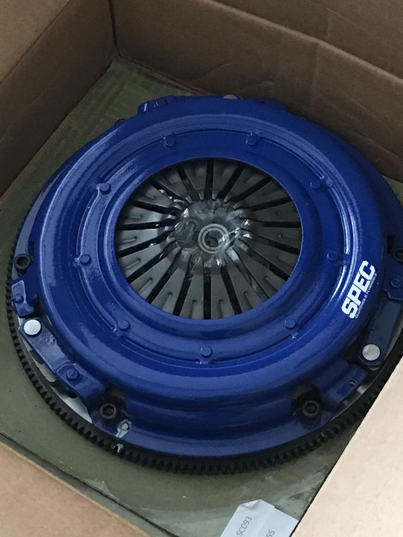

Here's the clutch that I got, as well as getting the engine and trans together and dropped it in the car!

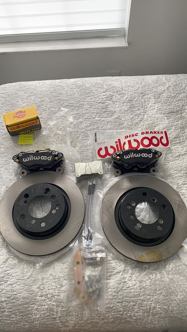

The brakes were my favorite mod. I just love the way they look with the wheels!
