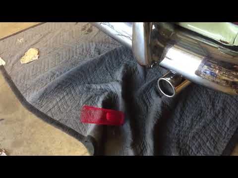

                              Had to cut the exhaust at rear axle since it can no longer go up and over axle. Picked up a VP Auto 025KSS 2" Stainless kit that includes 2" 2-into-1 downpipe, resonator and muffler. The kit has a section that still goes over rear axle but I repurposed the length to run under axle and attach to muffler. I was missing some hardware to hang the system so fabricated two hangers for the kit's rubber grommets out left over control arm spacers. I am worried that the resonator being about 3" diameter is going to have a problem once aired out. Aired out, there's very little light coming under on the shop floor. So I may rework this section at a later date.
                              Under Axle Section. Sorry for the poor image quality - I pulled this from the video below.
                              Untitled
                              Downpipe New vs Old.
                              Untitled
                              Aired out. That's a 1961 International on the left with a Cummins transplant that moved into the shop.
                              Untitled
                              Exhaust Video
                              Next up alignment.
