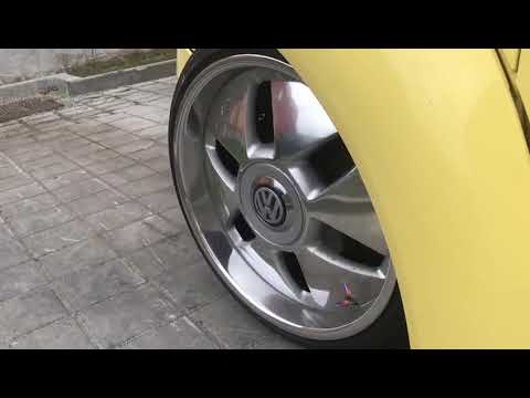

Then repolished the wheels, they could use professional polishing job but good enough for at-home work for now...
Before/After (this wheel was in worst condition)
And made myself floating center caps. Each cap is made of 5 printed parts, chrome trim ring from my audi caps, bearing, bolt (Which I had to grind to have super low heads) and 20g weight to keep it floating...

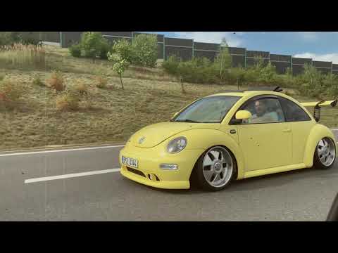

And with all of our cars ready and clean, we went to a trip...
This is the oldest chain suspension bridge in our country.
And here is a short clip from that trip:
