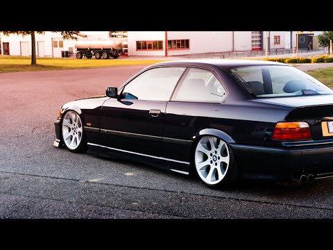

Unfortunately the Styling 5 rims didn't fit under the fenders with air-out system, so temporarily bought some Styling 162 from BMW E90 with 215/35 18 and the first test drive could start...
I also made some little photo shooting together with my brother's E46 on 18" Styling 5 (also custom aluminium made center caps). On these pictures I had mounted some lip at the front. But I didn't like it, so it is removed right now...
