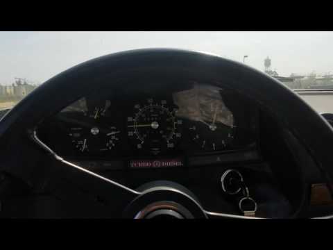

          Here is a video of mine in a w123 with 4spd manual.

            last week i pulled the glow plugs, shot some ATF into it and turned it over a few times and threw them back in. i had Monday- Thursday off so Monday morning i disconnected the fuel lines and put them in a water bottle i filled with diesel. with a new 1100cca battery i began trying to start it. at first seemed a bit hopeless but then i got it to stumble a little bit, then it stumbled again. then with a huge cloud of black smoke she stumbled into life. (mind you it was open turbo and i was jumping the solenoid which is under the turbo with a screwdriver so said black some was into my face)
            video:
            Tuesday when i walked out i noticed that i hadn't plugged the fuel line and a lot of diesel leaked out. i was okay with this because it told me the fuel in the tank was not gelled, instead just a dark yellow. i hooked up the fuel tank back up and put the last 2 gals of diesel i had in it. and let it idle while i pulled all the throttle linkages apart and cleaned, lubed them (they were sticky) after that i moved my tools out of the way and drove it around the parking lot a few times to make sure it was going to be okay. after 15 minutes i jumped on the road and drove it to the gas station on base and threw $20 in it to help burn out that old fuel. i also topped off the radiator that was empty (no leaks so far) and drove it around base for about 2 hours
            it was about this time i started thinking, "man that sounds like its knocking a little more then a diesel should" im beginning to suspect it spun a rod bearing. i did an oil change on it so it would have to be preexisting. ive heard that a clogged injector can sound like a sound rod bearing on these engines. i also get paranoid and hear things from time to time. so it could just be me. the way i see it if it is a rod bearing the motor is junk and i should just drive it into the ground. or if its a injector some diesel purge and some driving should clean it out. either way i'll drive it. either it blows up and i find another or it doesn't and i continue to have a cheap toy i have literally no money into.

              It's ironic that my video was recorded on base as well. Where you at?
              The knocking noise: when I watched your first video I noted that it sound a little too "metal on metal". They're noisy engines but not that noisy. Did the sound change after an oil change? At what rpm's does it go away?
              To be honest these engines will drive 25k miles on a spun rod lmao
                haha wow, im on Naval Air Station Whidbey Island, in Washington.
                the noise does not go away, the engine also has a large amount of blow by. im not sure what this engine is supposed to feel like but it feels down on power. i like the car but the body is beat, interior is beat, and motor is beat, not much going for it besides the fact i have literally no money in it. im trying to pick up a W123 with a OM614A motor in it with 130k on it. the car is in better shape but its a 300d, i really want the S class goodness. of course i wont pay more then $200 for the whole car. if nothing comes around i'll ride this thing into the ground
