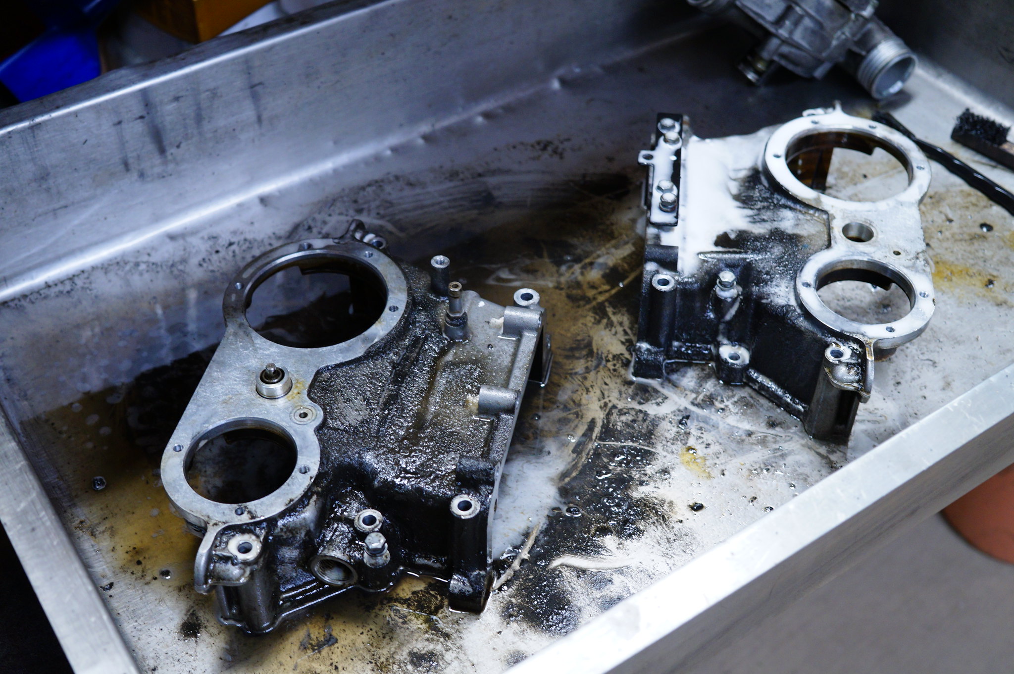

Also cleaning everything I take off

DSC06255 by tom maloy, on FlickrAlso cleaning everything I take off
