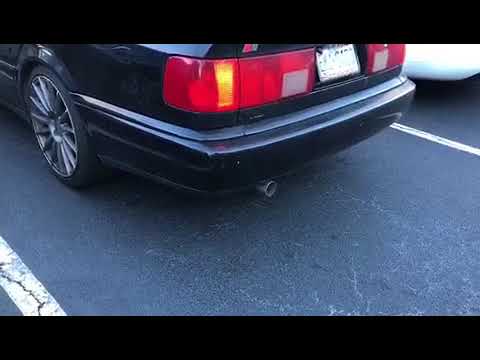

Also, decided to bite the bullet and address one of the worst (although possibly most amusing) aspects of the car. The previous owner had chopped off the exhaust as it exited the cats, meaning the sound was aimed at the driver's and passenger's front seats. It was borderline unbearable, I would wear headphones on the highway. Also can't have been healthy with all those fumes. Took the car to a shop and had a Y-pipe built that maintained the cats and went straight out to 2.5" pipe out the back. Had them tuck it in as high as possible and kept the stock cats just in case I need to pass inspection. Here's how it looks:
And here's a video:
Funnily enough, it died immediately after that picture was taken. Wouldn't start, had to bump start it. It seems that there's a problem with the charging system -- it won't charge past 12 or so volts and usually stays around 11. Battery has been tested. Once it dropped to 10 volts and the battery light came on then the car immediately charged to like 13. I think the alternator is functioning and had it tested but there's something else going on. Maybe a bad connection or something. This problem has persisted for the last few weeks so haven't been driving the car a whole lot.
