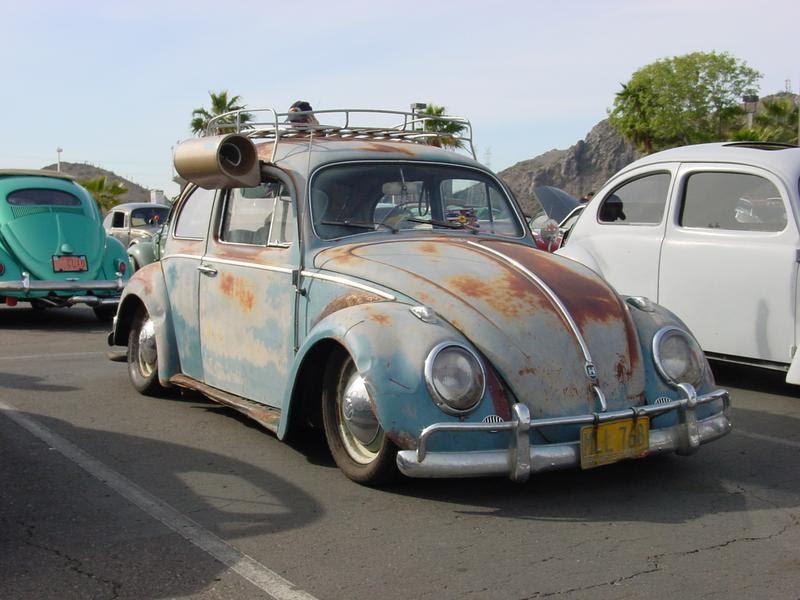

              As for paint and style of car i think i want to go at the ratrod direction with "patina" paint and big whitewall tires

                  All this work getting it solid again just to paint it to make it look like it's rotting? LOL
                  awesome work btw, that much rust would mean "ok let's save the parts and scrap this pos" to me since I can't bodywork to save my life
                  FB: @DumbassCarCrew - IG: @fruttolo_dumbasscrew
                    What can i say, i like rat rods I have been considering maybe painting it matte white / primer gray. But paying for a real paintjob aint worth it because theres not a single item on the car that is in good condition, all trim, interior, seals, mechanisms etc would also have to be replaced.
