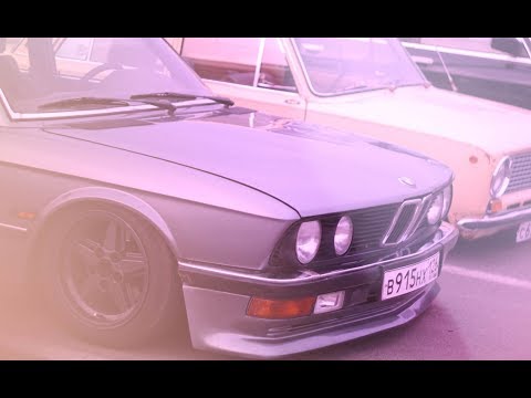

BMW e28 building
install flat glasses from e34 and UAZ (glass from VW Golf 2 doesn't fit) (cuz hella very rare in Russia)
before (glass from LADA 2101 and 2106)
after
open season with new Ronal R9 "Penta" wheels
just install rear BBS bumper
install E60 underseat subwoofers
Develop Arduino air suspension control unit
and some photos
just bought new engine for my BMW E28
its J32A2 from Acura TL UA5 TypeS (260hp)
dreamed about vtec bmw for a long time
and behind the engine my delsol waiting for sunny days
i saw only two bmw with this engine (e30), and i think it will be first e28 with j32.Originally posted by Fruttolo View PostYeah for weird swaps!
Is there any plug and play trans adapter to mate the engine to bmw's or will you need to make it from scratch?
I made a plexiglass adapter plate template, and then i will order plate according to the pattern at factory.
I think its very easy swap, only what i must do, its remake coolant system, rotate intake for 180 degrees and install stock power steering pump instead A\C compressor.
the only problem- its a starter motor. the starter should be installed on the gearbox.
My friend expample:
