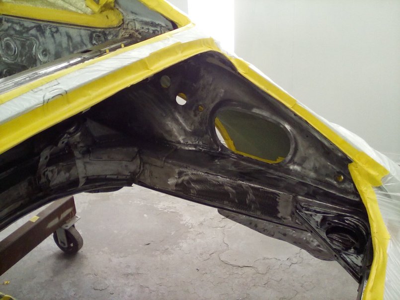

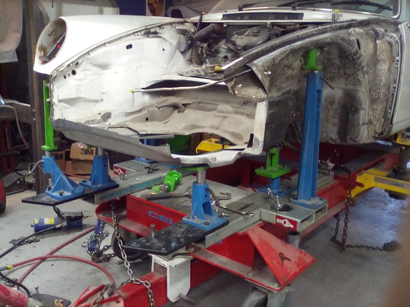

Let's start from the beginning. The previous crash damage that was found kind of lead to a snowball effect.

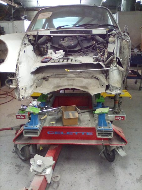

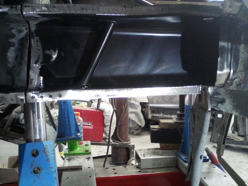

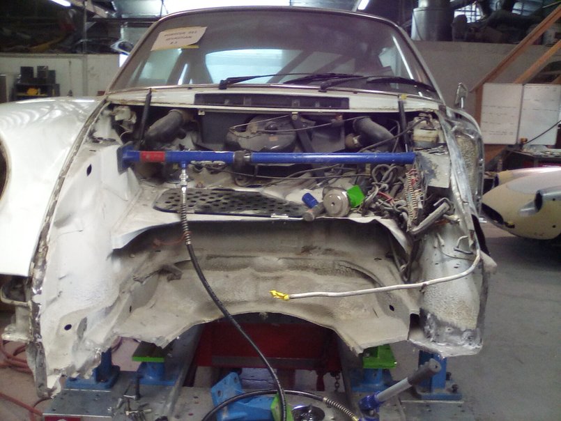

So a lot of chopping was done. On the Celette table.
You can see how far off the bolts are to the green support.

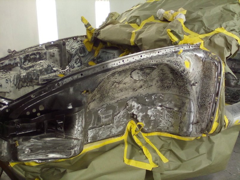

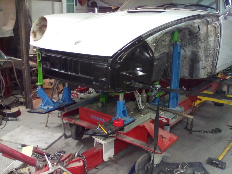

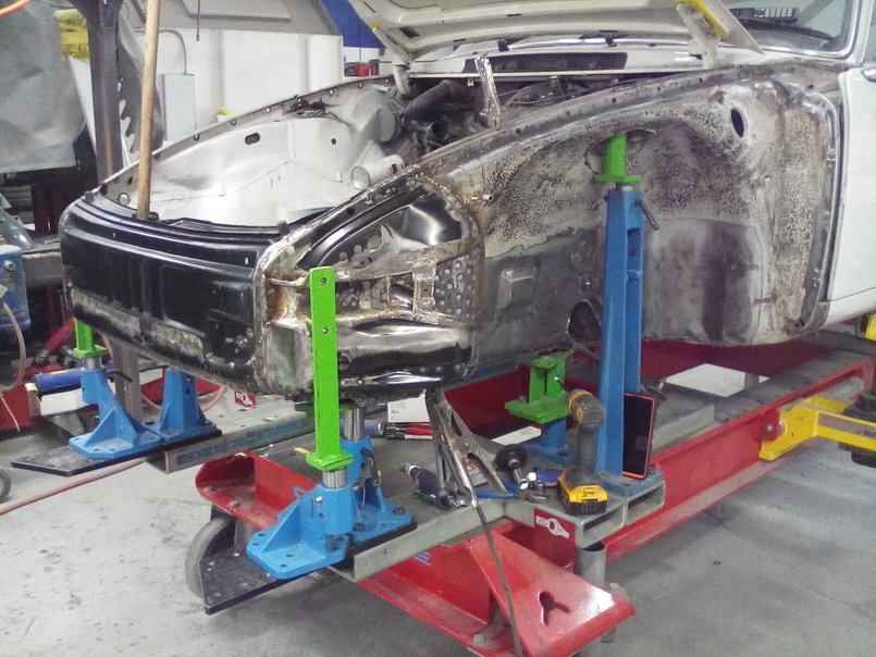

All new panels starting to go in.
Everything protected inside and out.

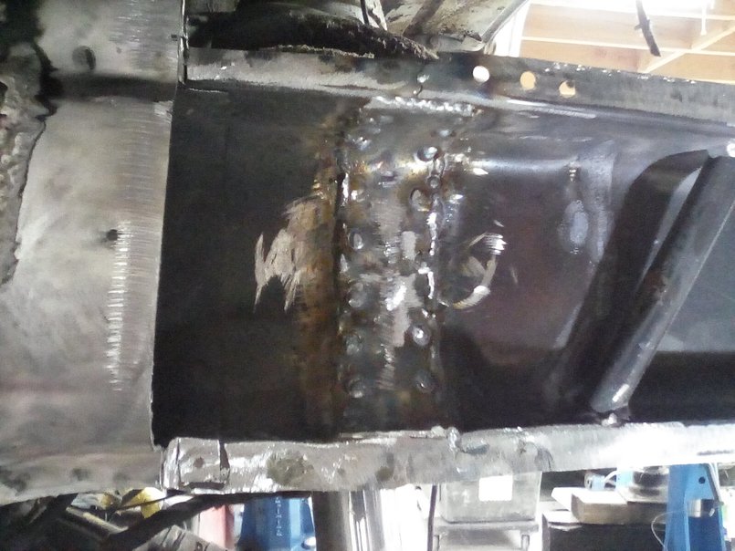

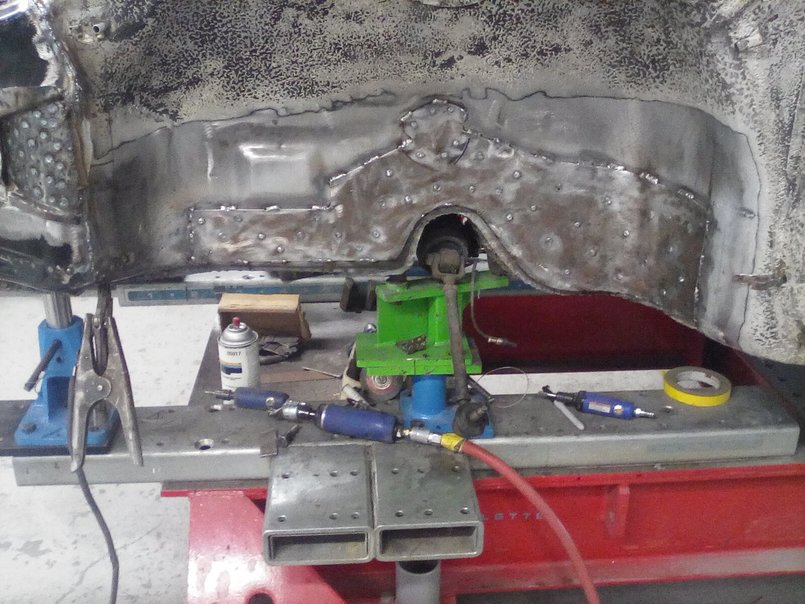

You can see in the photo below, there is some square 1x1 going in to add some extra rigidity into the front.
All welded up.

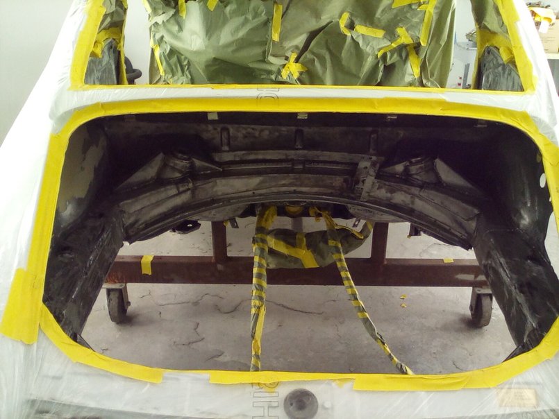

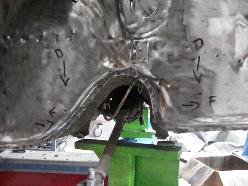

A lot of work was also done in the engine bay. All the structure was cut out due to a previous incident in the rear. And all new structure was added back in.

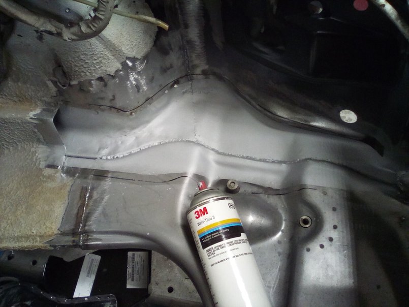

Then started the real fun stuff. While we were doing the tub, I figured it was the perfect time to add in all the RSR reinforcements that Porsche did for their race cars of the year.
This might be a little overboard for the beginning, but the strengthening done will mean I will have zero problems when I eventually go to a coil over setup.

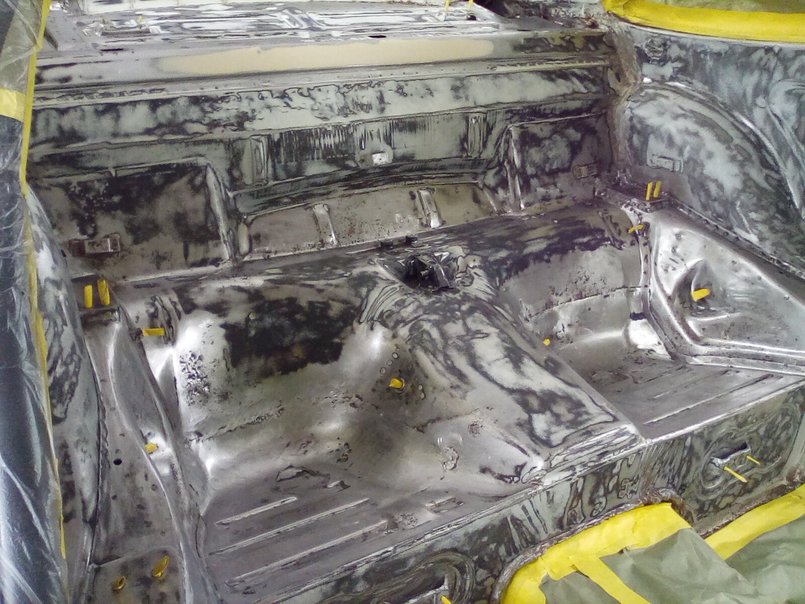

Remember that rust I found in the rear seat wells and parcel shelf? That isn't there anymore either, all new metal.

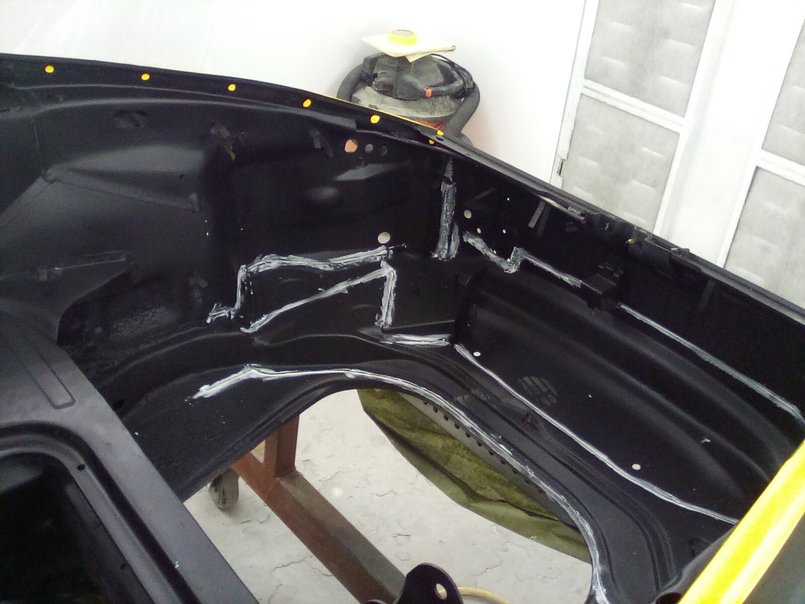

Right before the undercoating etc went on
Andddd all seam sealed up.
