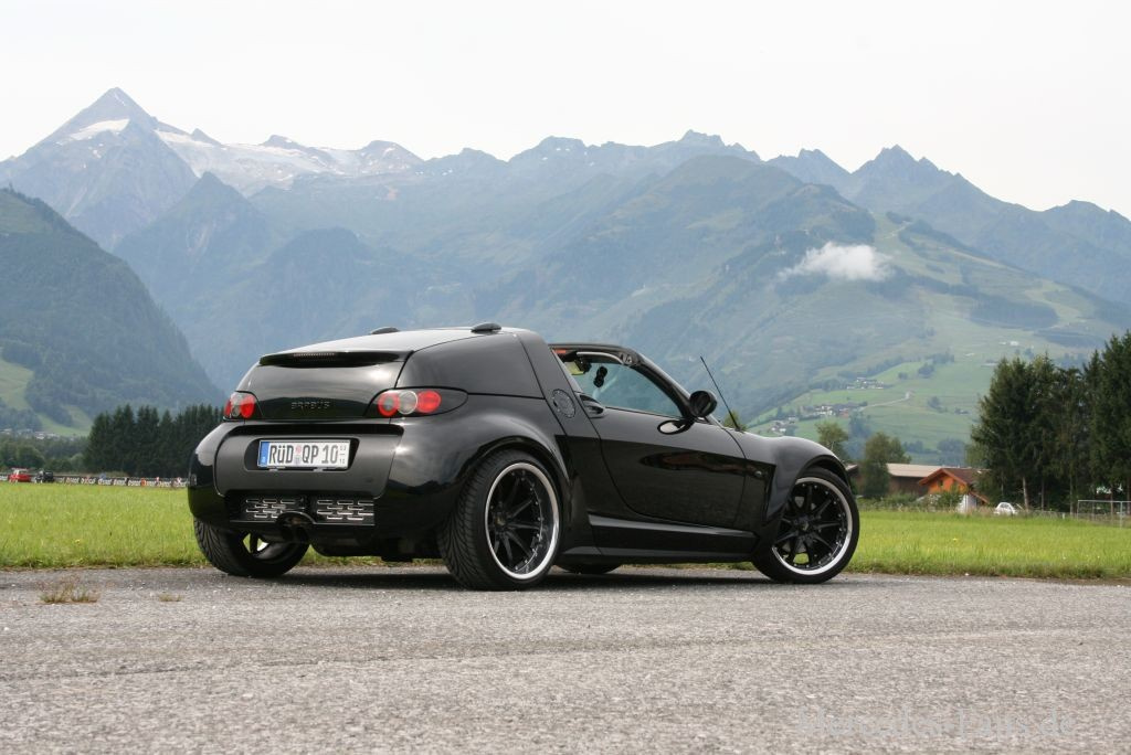

    Fitted a Brabus wing to the trunk, cleaned the car, went out to take photos. Enjoy!
