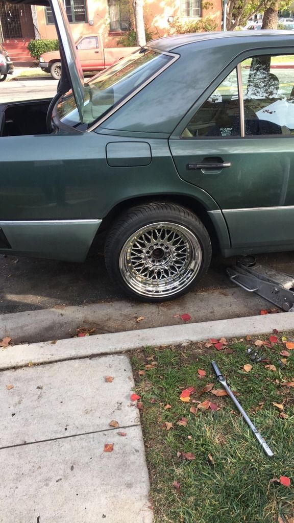

    Inheriting my moms Mercedes 1993 300e 2.8, which she got from my grandfather (original owner.)
    Always wanted to slam a car growing up, and took awe to that whole "low life" lifestyle.
    Here's a picture of the car:
    Recently purchased a set of RS reps off craigslist with tires:
    Test Fit:
    Specs:
    F: 17x8.5 et20 215/40
    R: 17x10 et15 235/40
    Plans:
    - Install a pair of DNA struts, if anyone has experience with these please let me know: http://www.ebay.com/itm/FOR-86-93-ME...3D401107854590
    - Install ford ranger shocks, heard these are awesome for an automatic low with the possibility of not having to cut springs
    - Install either H&R sport lowering springs, or Vogtland. If anyone has experience with both, please offer opinions, thank you!
    Very excited to further this build and see how much fun I can have with it, stay tuned!

      Thanks! Think I fixed it
        Yeah they work now! Looks great man, I love that color green. It pairs really nicely with the chrome plating on the wheels. Can't wait to see what you do with this!

                      Ah, a Malachite Green W124. Not fan of the reps, but each to his own, interested to see how you fit +15 on this and with 235/40 ( I'd recommend going 215/40 though ). And suspension wise I'd also recommend V8 W124 springs or something from W210, they should all fit bolt on and are stiffer. Just cut them slightly.
                      Building a W124 Benz
                        Was planning on switching the 215 on the front to the back, and buying 205s for the fronts. And about the offset, its gonna a hard job lol. They poke a bit in the back but I think it'll be done with the camber arms that Evan was talking about, and with extreme pulling, or widening the fenders. My dad has a lot of experience with body work so he can probably help me with that.

                          Thanks for all the info w/ the links dude... After reading this I'll probably go with your suggested set up. I don't know about the r129 strut mounts yet, but definitely the b8s and Saab's. Also do you have a link to the reducer? I'm not sure if I still have the stock bushing b/c the shocks we're replaced before I got the car, thanks!
                            When you lower the car it will naturally camber in so you should be able to fit those unless you're trying to tuck.
                            I need the weed in advance i can't ride my bmx across the ocean unless im high
                              Like Evan said, the natural camber will help you a lot, however 10" with +15 should need some fender pulling/rolling. I'm curious, because I'm trying to fit 17x10 +4 currently to W124, tried on the wheels on stock height and it's not looking good.
                              I'd go 205/40 and 215/40 tyres and also I'd recommend spacing out your fenders because you will run into a problem where the tyre will rub on the corner of the fender. These are spaced (~30mm, rolled and 205/40 on 17x9 ET2) and as you can see it still rubbed.
                              But I'm curious to see updates, how will +15 fit to rear with rolled/pulled.
