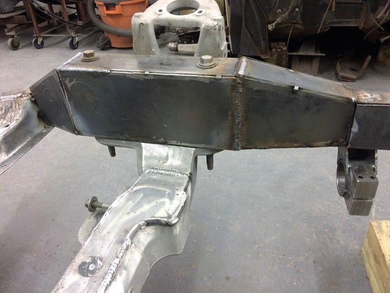

    I did get a little done over the last month too, starting with sandblasting and reinstalling the original radiator crossmember. The front sheetmetal on these trucks mounts off of the radiator support, so it was important this made it's way back into the truck.
    Then I continued boxing in and blending the front section of the frame.
    I also pulled the Crown Vic cradle out to clearance in for the tie rods at full dump. I think this will be enough, but I need to recheck it when the truck is on the ground and everything is tight.
