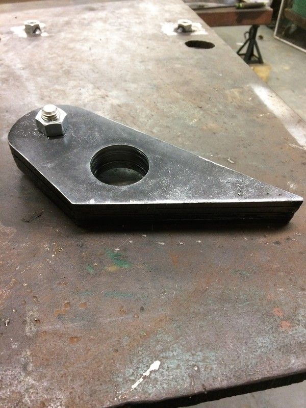

Made a little progress this week, but never as much as I want to. The frame side of the engine mounts are all cut and drilled, now I'm just waiting on my alignment pucks so I can tack them in.

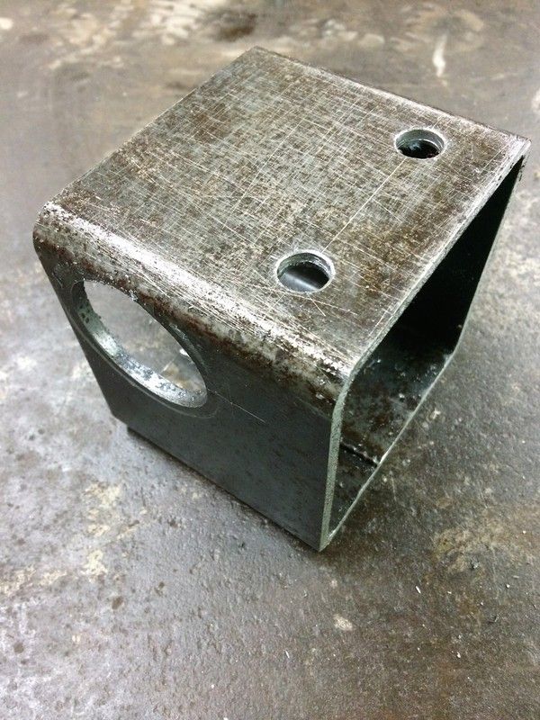

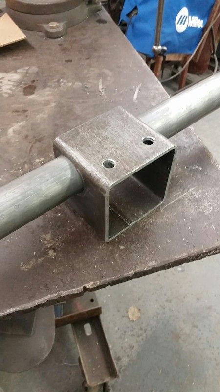

Up next was the transmission crossmember/mount. I started with this...
A little cutting and drilling later...

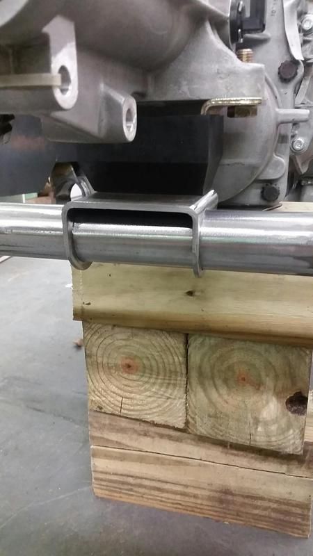

Then I mocked it up on the DOM to make sure the holes lined up...
A little more cutting and it started to take shape...
And then I mocked it up in the frame.

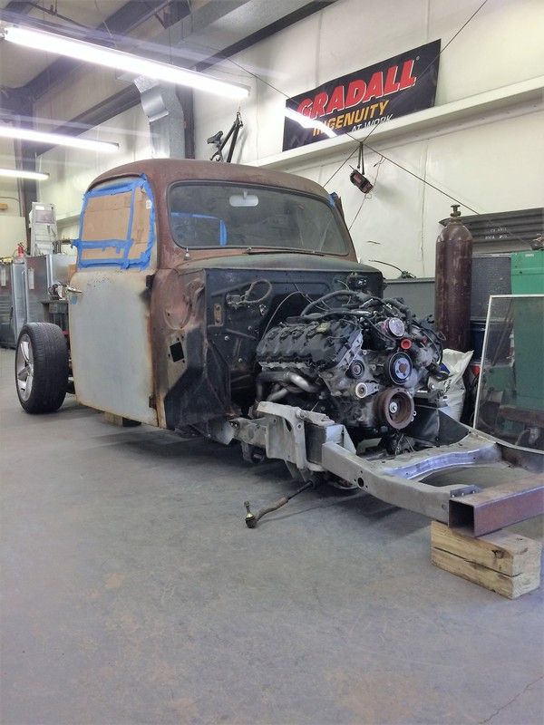

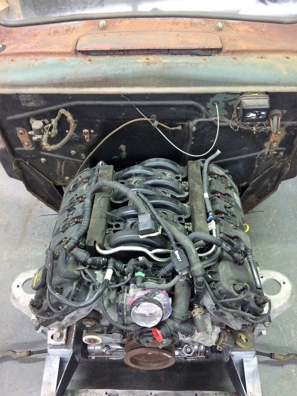

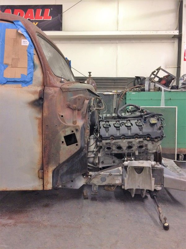

Big steps this weekend! I finally got the engine and transmission in the truck and off of the blocks!

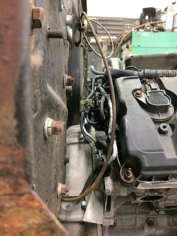

More room than I expected for accessories, but it looks like I'm going to have to get creative with the steering shaft...
Pretty happy with these angles, I guess I can live with the transmission output and pinion flange being 0.1 degrees off...
The engine is sitting perfectly flat to boot!

That steering shaft looks like a fun time. Mounts look great. From the picture angles it looks like it would go right into the motor mount. Im hoping thats not the case and your not going to have to rely on telepathic steering haha.
What did you use to set the chassis at level? Or were you just getting the matching angles best you could between the pinion and trans output?IG @gt3_brz

The steering is going to be an adventure. The joint should clear the front side of the mount, but I think the back leg is going to have to be cut quite a bit. I have a few ideas, but I need to get the cab on, and buy some parts before I go any further with that.Originally posted by laextreme5 View PostThat steering shaft looks like a fun time. Mounts look great. From the picture angles it looks like it would go right into the motor mount. Im hoping thats not the case and your not going to have to rely on telepathic steering haha.
As far as getting the frame level, I'm lucky enough to have a nice floor in the shop, so just some 6x6 blocks and jack stands, then I shim wherever it needs it with small pieces of steel. I check the frame with a mechanical gravity style angle finder, as well as a digital one, every time I move it. It's set at zero degrees now, which should be how it drives down the road, so I just picked the angles for the driveline when I installed the rear end, and made the transmission output match. As long as the angles are matching it should cancel out the vibration of the driveshaft, and 4 degrees happened to give me a fairly straight shot, while still having enough angle for the u-joints to operate properly.1949 Ford F1 Build:

Awesome. Thanks for the info. My garage floor isnt the most level thing out there so im going to have to get creative in how i find level with mine. Good news is i have a long while before im to that point.Originally posted by CTeunuch View PostThe steering is going to be an adventure. The joint should clear the front side of the mount, but I think the back leg is going to have to be cut quite a bit. I have a few ideas, but I need to get the cab on, and buy some parts before I go any further with that.
As far as getting the frame level, I'm lucky enough to have a nice floor in the shop, so just some 6x6 blocks and jack stands, then I shim wherever it needs it with small pieces of steel. I check the frame with a mechanical gravity style angle finder, as well as a digital one, every time I move it. It's set at zero degrees now, which should be how it drives down the road, so I just picked the angles for the driveline when I installed the rear end, and made the transmission output match. As long as the angles are matching it should cancel out the vibration of the driveshaft, and 4 degrees happened to give me a fairly straight shot, while still having enough angle for the u-joints to operate properly.IG @gt3_brz

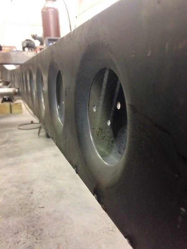

For starters, I put the holes in the inner frame plates, pulled them out and dimpled them, then tacked both sides back in. Looking hot rod as fuck now.

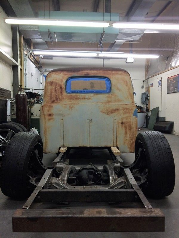

And how about dat ass doe?
I have some pretty trick ideas in my head about adding some tube out back, and building the bag mounts, so I'm going to be working on that while I wait for parts to build my steering.1949 Ford F1 Build:
