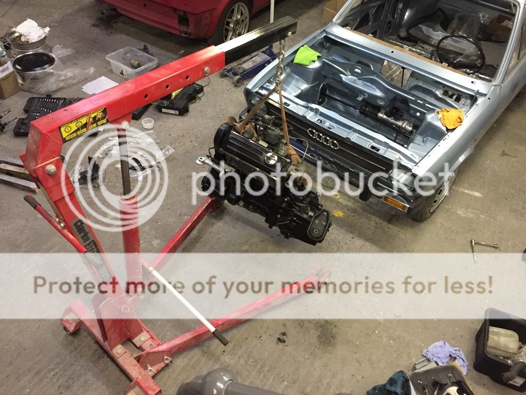

Plenty done this weekend just gone. Got the engine up there and onto the crane ready to be dumped in;
