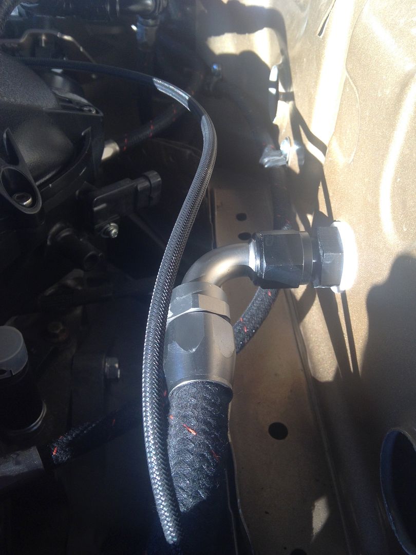

                          So I never posted my Accusump setup on the car.. Mounted it in the middle. Its a 3 Quart High Pressure Accusump, running -10AN fittings and lines..
                          Lets start with the bulkhead on the fire wall in the bay.. this way if I need to uninstall I can just remove from the interior.
                          Here is the other side mounted behind the dash
                          I ran the lines pretty much like this

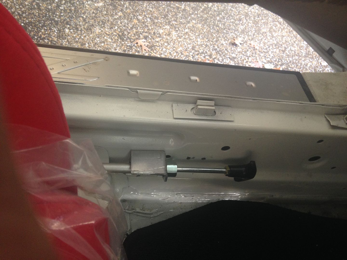

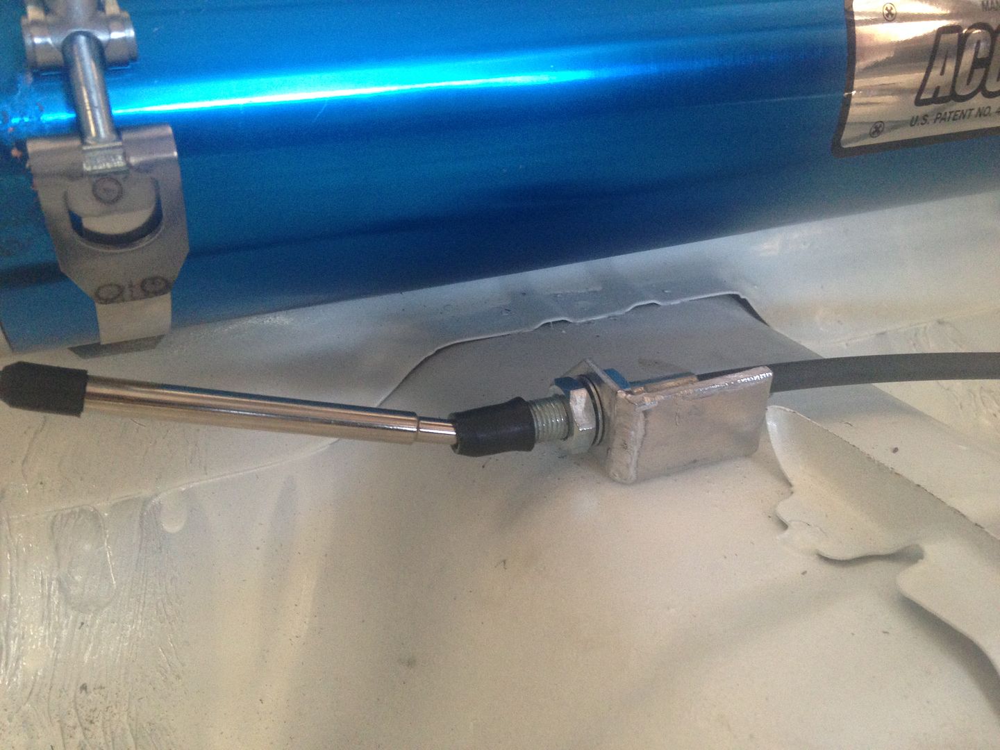

                          I also hooked up the 6 foot Accusump Manual Valve Cable kit..
                          Cut up the mount though to work how I wanted it to..
                          Ran the line to the driver side for easy on and off switch.. And why Manual Valve cause it is the safest way, the accumulator works 'automatically' when the valve is OPEN, storing 80 +psi of oil pressure for when the motor starts to drop off.
