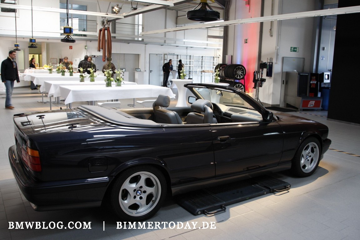

          hope it comes out as good as this vert conversion

              Also that E34 wasn't a conversion as such, it was actually built by BMW. The cars still alive in their secret vault in Munich, but a few people have recently started to speculate they might have made two

                  from what i understand the e34 was build in 1 ex of a 2 door coupé and 1 ex of a convertible but they scrapped the idea before production started. i hope that it will turn out BETTER than the e34 vert
