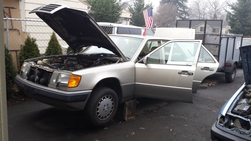

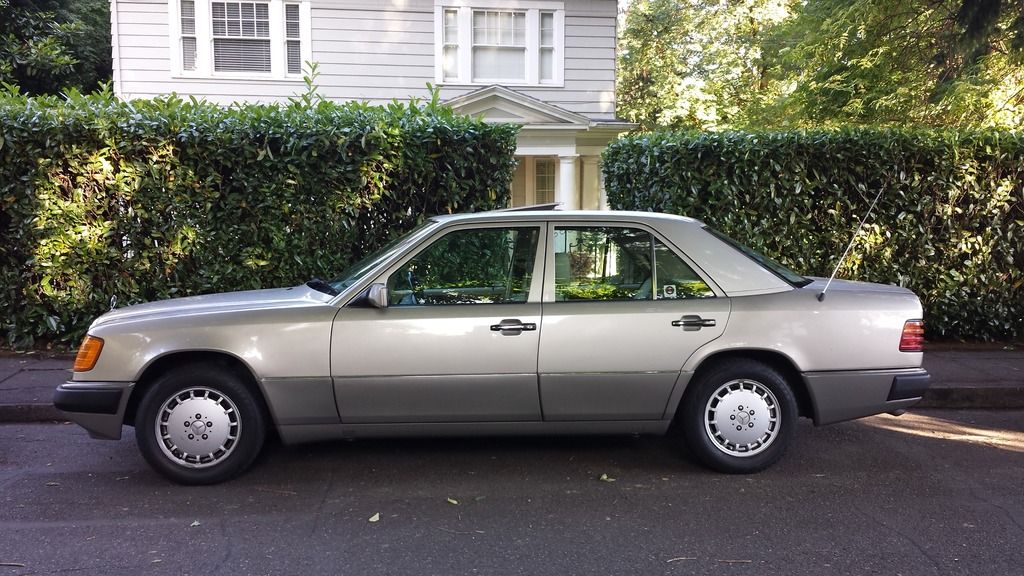

    Its been awhile since I've posted anything with this w124 build, probably nothing ever since I sold me civic wagon. But any's I bought this Champaign Golden big yacht 300e from my father its been 2 1/2 years since I've owned it and has been a love **** relationship with this piece of German turd even though I still managed to figure most of the "things that could go wrong with it." Literally I wen through this thing inside out, its insane how much issues a old European car could have, and a lot of the parts are special orders. I still a few things to figure but nothing like the list of things I had to knock down to get it properly running. I have it listed up for sale but still am tempted to bag it since I picked up a 1970 Mercedes-Benz 250 and kind of want to focus on that. But I guess we'll see with time.

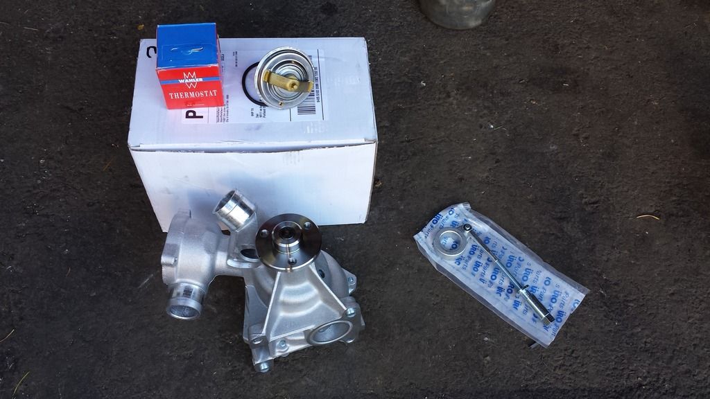

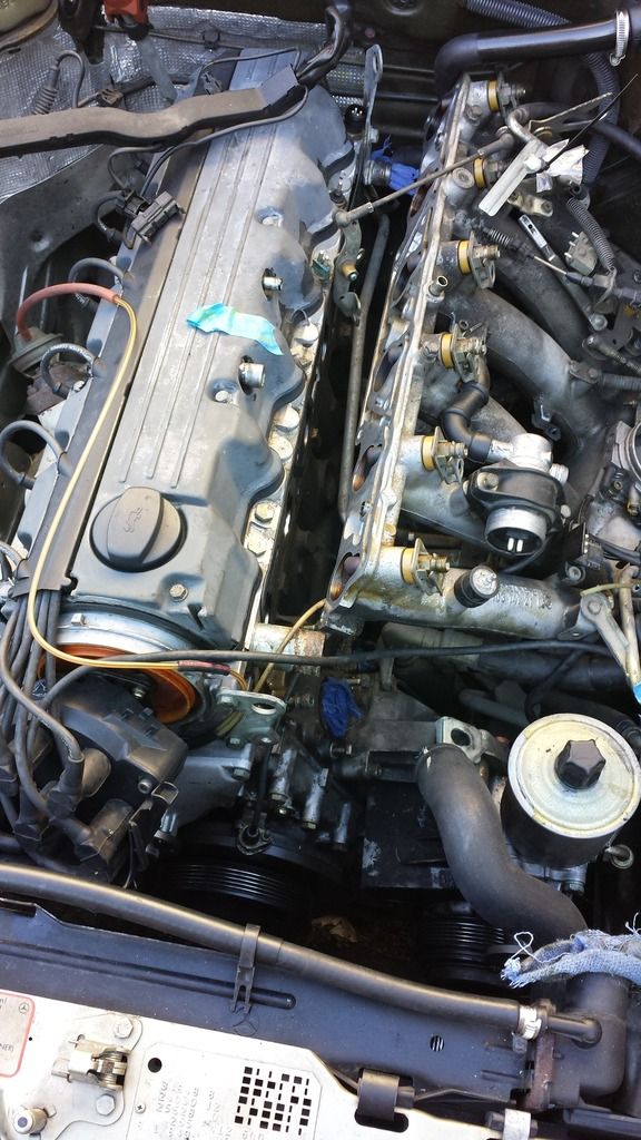

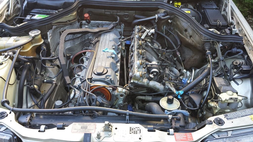

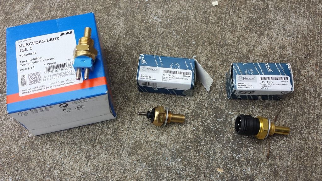

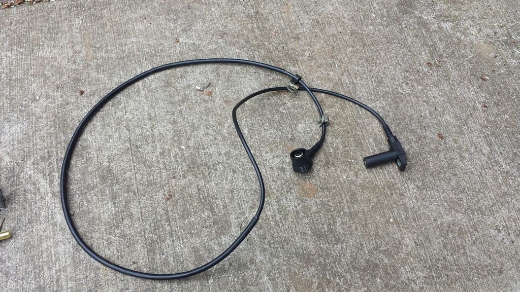

    So I Started going mechanical things since my father has not done anything to it, Got my waterpump, thermostat, heater sensors, and other stupid stuff that was acting weird on it. Btw way I didn't have a special tool to take off my water pump so I had to unbolt my throttle body just to get to the bottom bolt of the water pump, pain in the ass

      put everything back, recoated my valve cover and the air filter metal cover. Replaced the valve cover seal, upper timing cover seal, cam seal. Finally this thing is dry and doesn't spill oil.

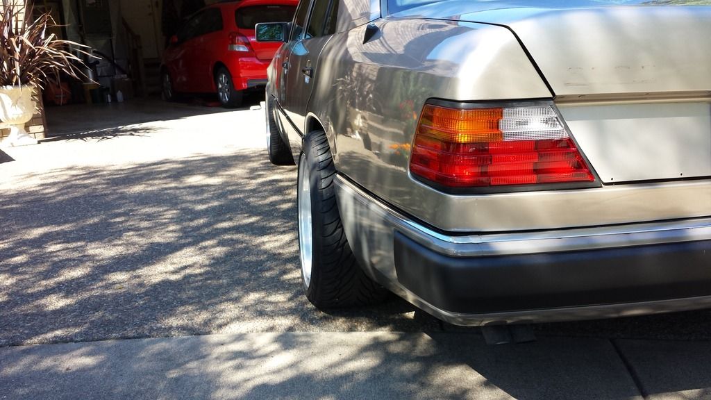

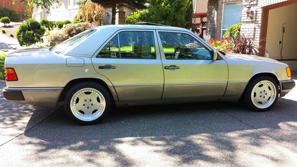

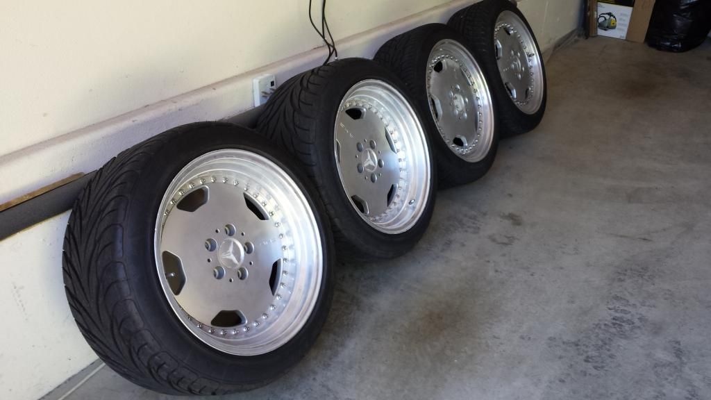

          My buddy has a German wrecking yard and I spotted a 400E that I will use the stock springs and cut them for now because their are no suspension really that I know of that are out there for sale to make to the low I want them to go and probably get shorted struts to make it work. Also I actually picked up a set amg aero monoblock 3 piece by oz racing wheels found these at pick-n-pull on a late 90's sl. Actually legitimate wheels stamped and mark in the back. I was really surprised to run into them at a local yard. It was like finding gold in your garden. lol. Super stocked about the find. But I have 4 sets of wheels e320 bottle cap looking wheels, and AMG star looking wheels. But we'll see where it takes me when I lower it.
          Btw I test fitted the MonoBlocks the fitment is insane. the rear fit pokes so much. haha

            heres another picture of the rear poke,

                          you scored on the wheels
                          just make sure there aren't any hidden faults or cracks.. these wheels are prone to that
                            I sure did, I was surprised they were just chillen at the yard. Really... so I'm going need to check them out really carefully or might have to have them clean up and checked out by a wheel repair guys here in town. Btw I picked a few more sets from local folks in town. just to have a variety of sets to see which one of them fits right when I lower it to the height I want it at.

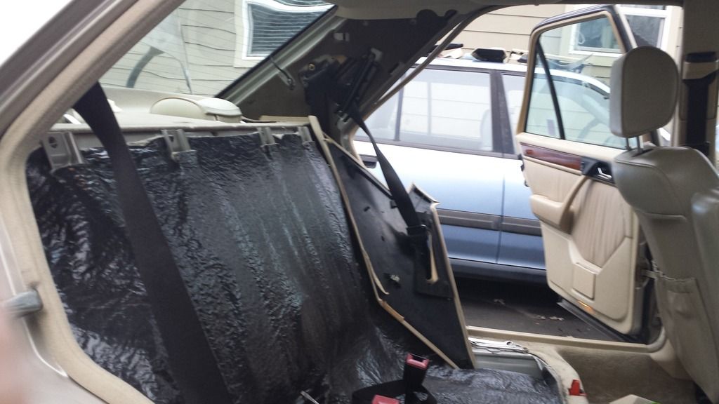

                              So my moon-roof broke on me, on one side the aluminum bracket just snapped. Went to pick-n-pull to hunt down a w124 where I could take of the moon-roof to fix mine btw my headliner is disgusting it started sagging so I decided to go after it as well. Went to fabric depo and got chocolate brown fashion leather to wrap my all one with. Since I have a friend in the interior auto restores I gave the headliner to him to fix meanwhile I get the moonroof rebuilt.
