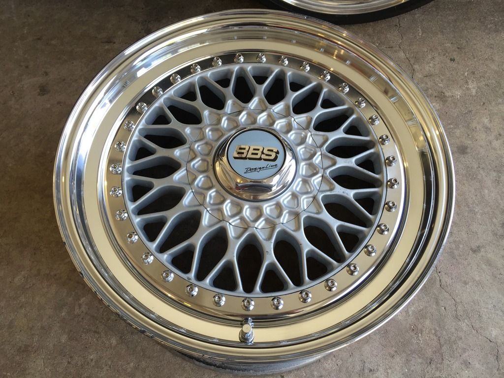

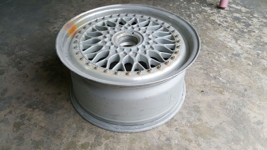

      Got my tire in for my spare RS that I rebuilt, I still need to seal it and get the tire mounted and then get an adapter made.
      Here is how I got it
      And here is how I got it looking with some elbow grease
      Its not perfect but its only a spare so It will do for now. Ill end up getting an RS198 to match later.

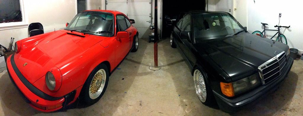

      And heres the two 80's babies tucked away in my dirt garage.

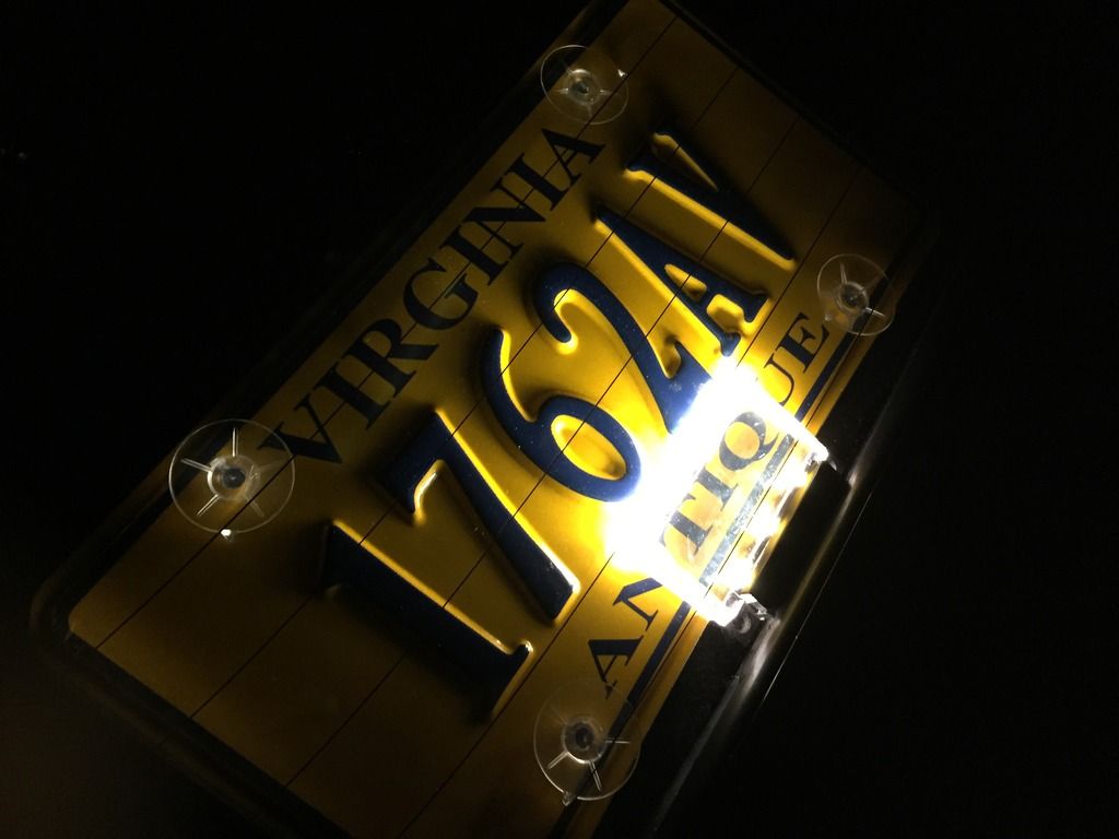

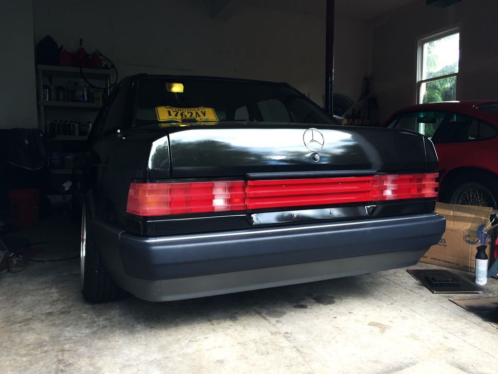

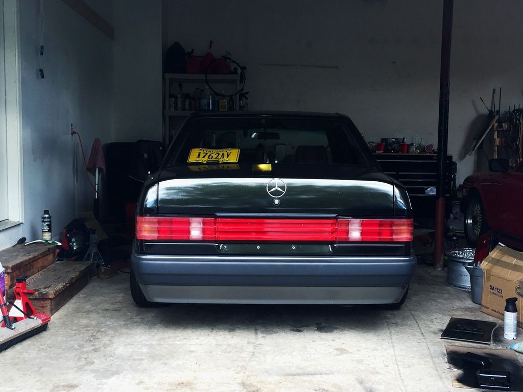

                                Now that I got that out of my system we can move on to the pictures of the tails and heckblende and my ghetto licenses plate location and lighting

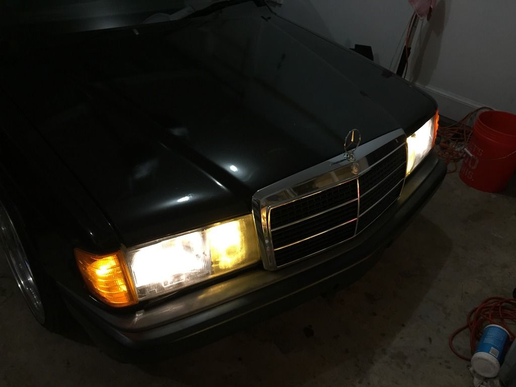

                                Also got my headlight working again ( still waiting on the new ones )

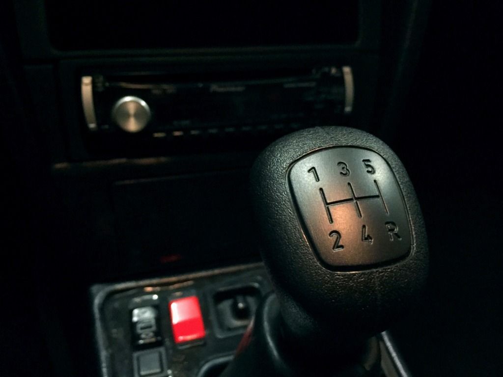

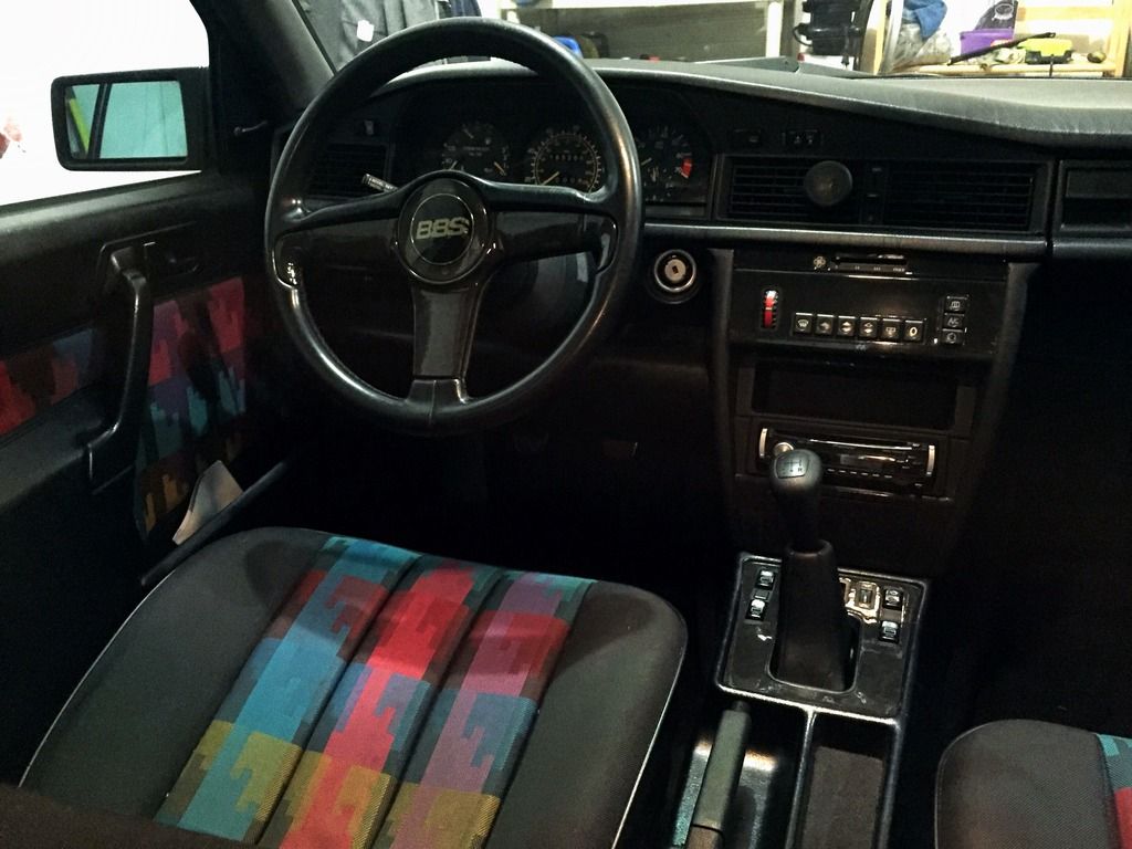

                                And the interior is finally complete (except for the head unit, I want a factory one)
