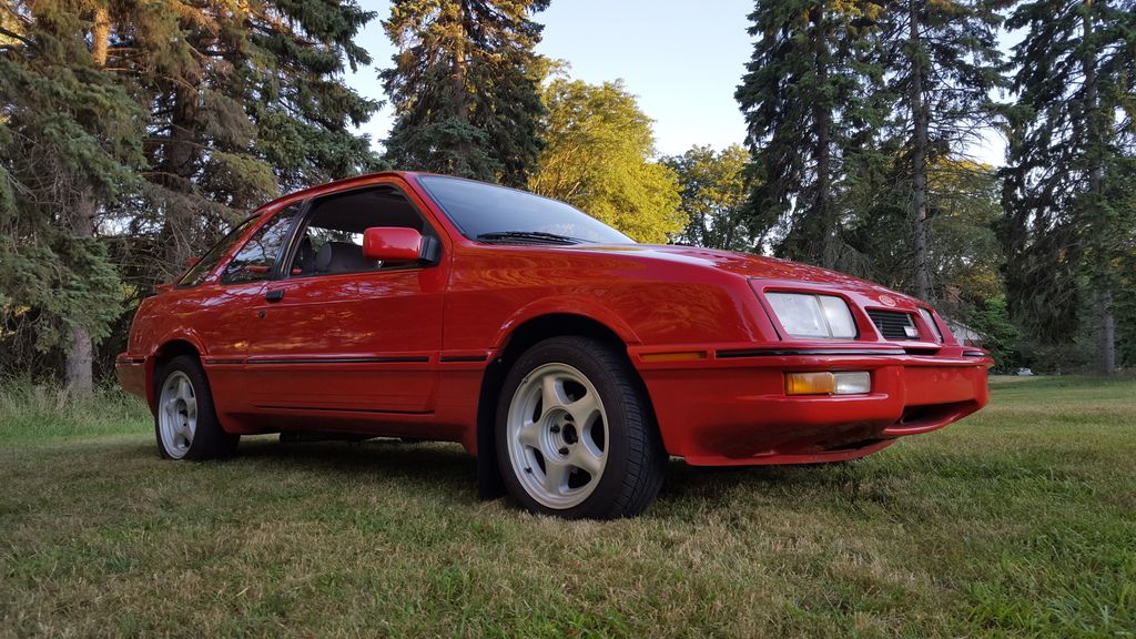

    Anyways here's some photos of the car:
    (Sorry for the bad quality pictures, quality should get better since I just picked up a Cannon
    T5).
