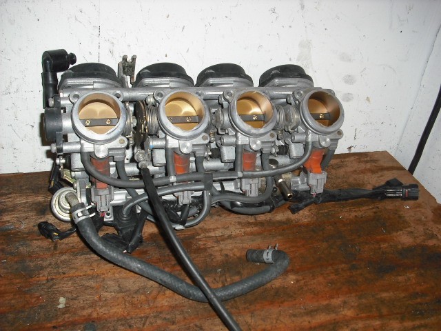

    Originally posted by DER E30 View Post
    What about motorcycle ITBs? Like R1 or GSXR 1k? You could print an adaptor block/manifold and avoid machining the actual throttles themselves. I'd be worried about the precision you could get out of the throttle blade to housing clearance, most OEMs have stinking tight clearance. I can picture having different amounts of vac leaks depending on the cylinder could be a tuning nightmare.....
    Only thing is I can't picture how big they'd need to be for an LS, Bikes might be still to small.
    http://forums.vwvortex.com/showthrea...-ITB-directory
    Looks like Busa throttles are 46mm and gixer 1k are 42mm, 600 throttles like 36-38mm
    Another nice part about bike throttles is they typically have integrated injectors and fuel rails with them. One less headache to worry about.
    Sorry, should have been more clear. I want the printer or casting method to make the intake runners, to make the transition from the cathedral port on the head to the round port on the itb.
    Ill be using Ducatti 999r Throtte bodies. They were only 2 cylinders but were large 2 cylinders, so they had large throttle bodies, 52mm. So thats not the issue. Its going from this shape,
    to this shape on the itb (the left side of photo)

  • DER E30
    replied
    Pretty cheap also,
