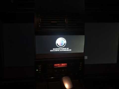

For all of this gear up, NBT was best choice (reason No.1 why is in car) and it is coded to Hi-Fi flat output,added RCA Gladen interconnects.
Still i have another solution to connect NBT-DSP via MOST interface and then all signal path will be pure DIGITAL
