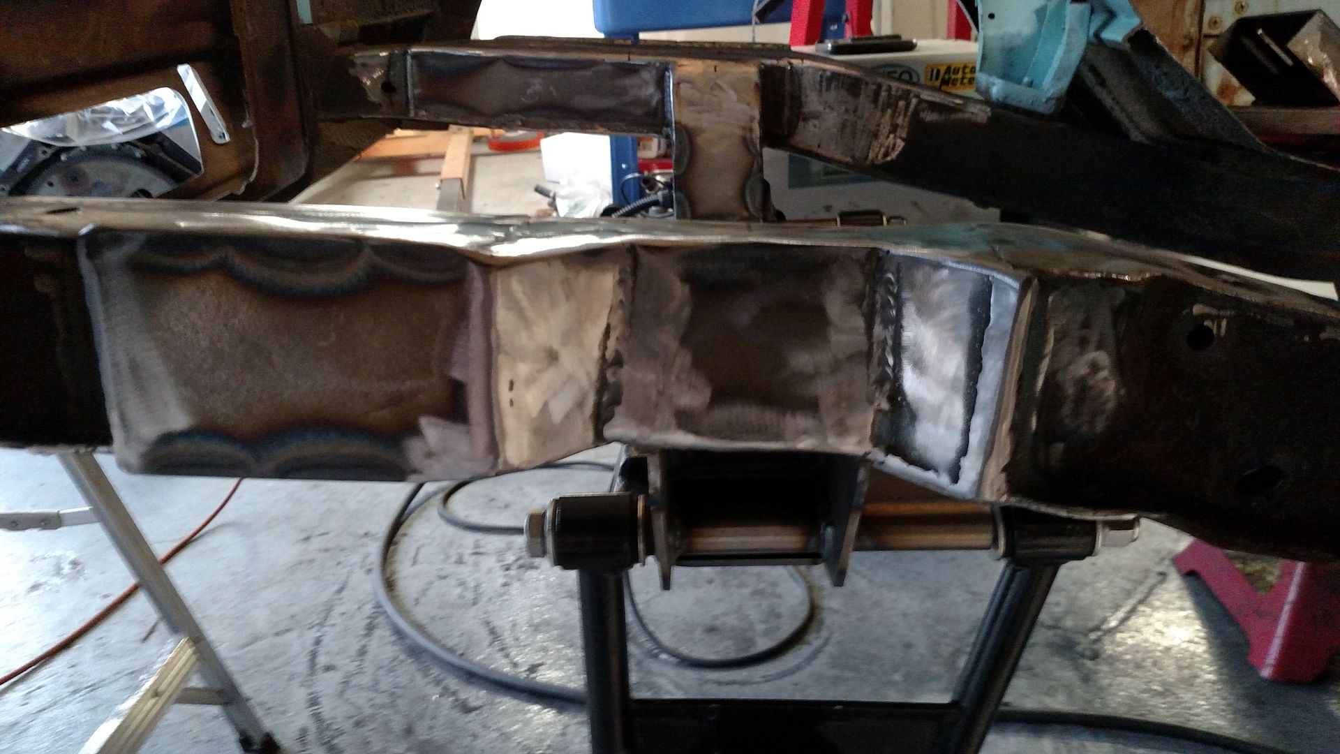

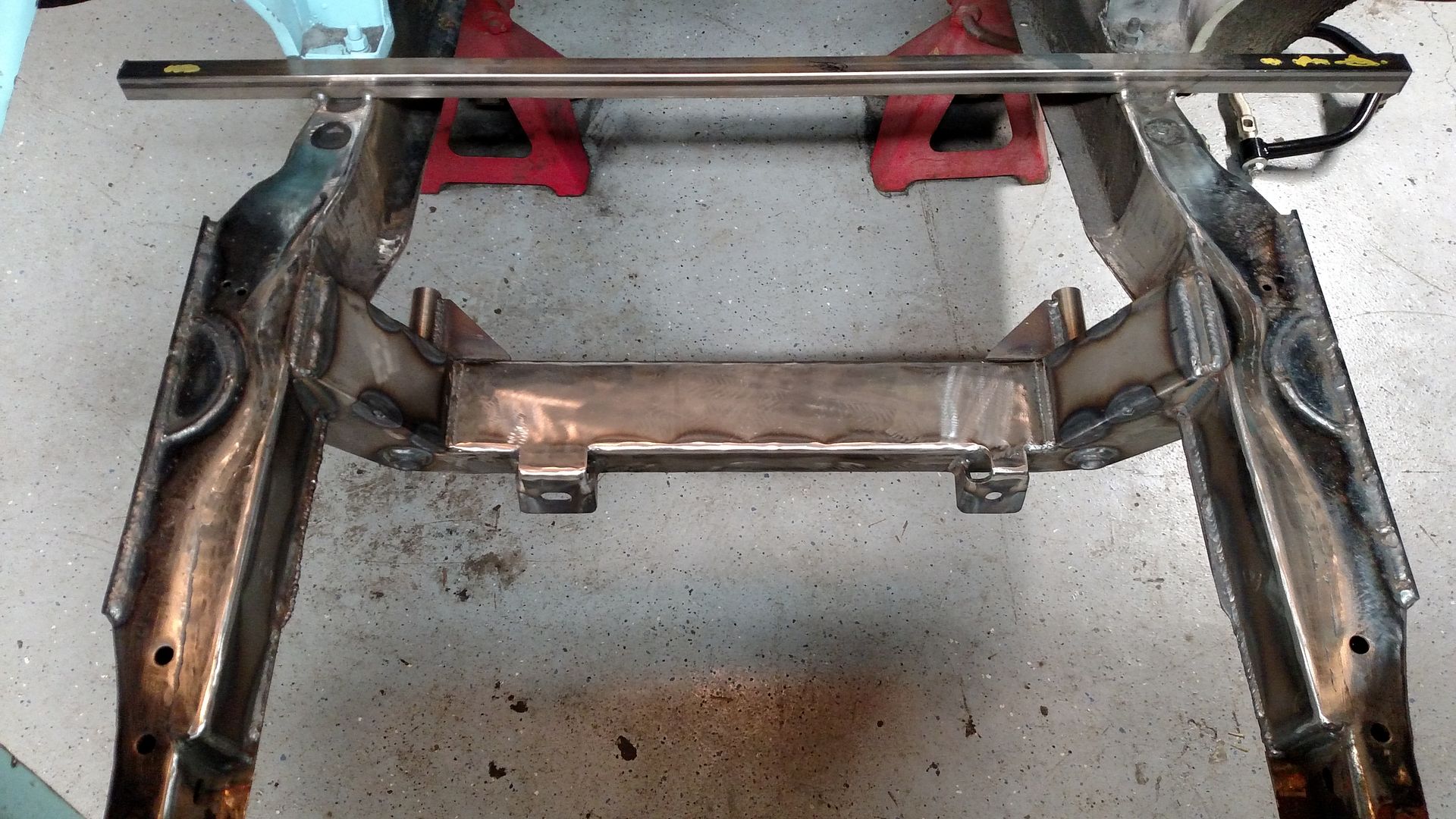

    A few weekends ago I got the crossmember and the frame boxing all burned in for good.

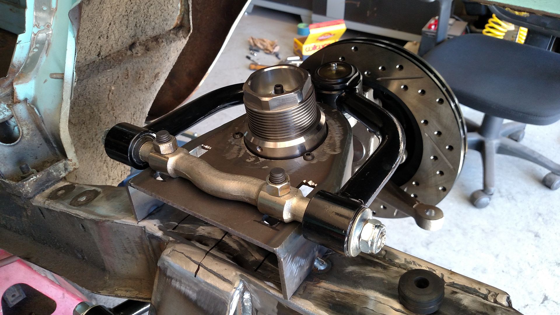

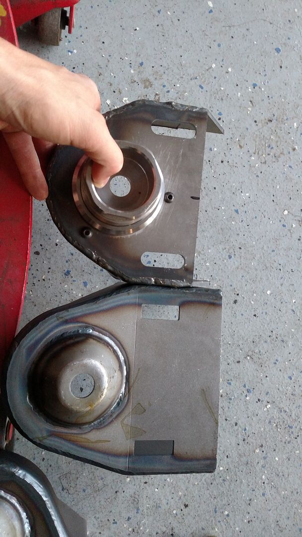

    Long story short the geometry on the welder series spring hats isn't good at all so I ended up buying a different set that has more distance between the spring CL and the a arm slots which allows for proper camber setup.
    This was the first test fit of the new spring hats and I still had to slot the holes another inch back in order to get the camber right.
    It was about 4 degrees positive at this point.
    And here's after slotting them and installing the ride height adjusters.
    About 1 degree positive and still room if I want to go slightly negative.

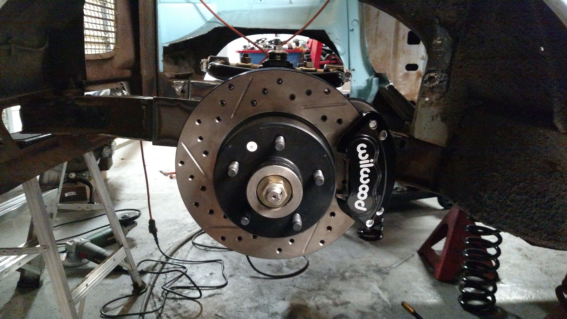

    Also test fit the Wilwood calipers.

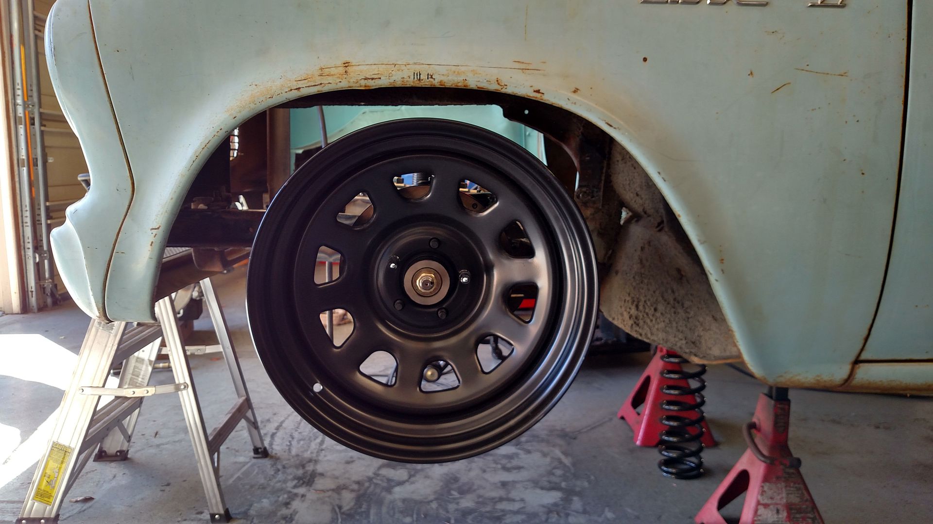

      Which brings us up to the present, I finished up the the frame recess for the spring on the driver's side yesterday and just need to mimic the same on the passenger side.
