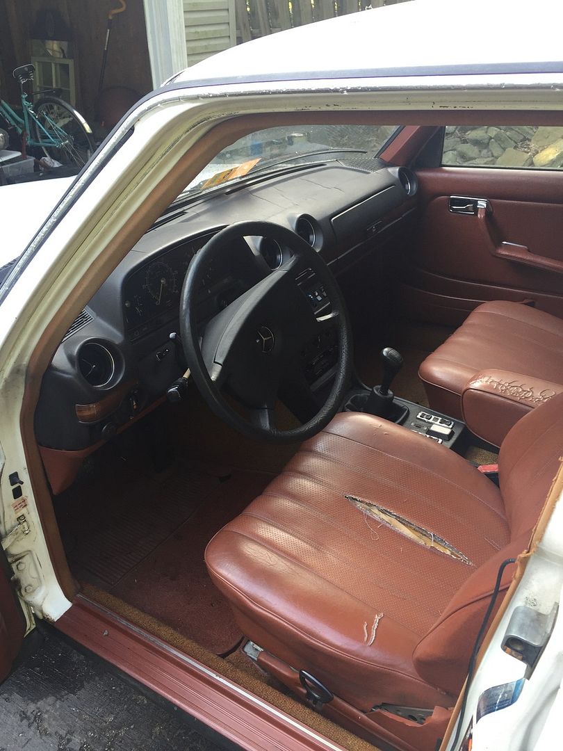

    So a few months back I decided to pick up a car to work on my fabrication skills and just all around learn any and everything I could. After a few weeks of looking I ran into a post on craigslist for a guy selling a 82 240D willing to barter, so I offered him my new tool box and 200 bucks. Before I knew it I was holding the keys and the title!! Then half way home it shut off I paid more for the Penske truck then I did for the car.
    After getting the car home the question was what to do with it. After looking at other w123's that are out there I noticed that once they are laid out it become extremely noticeable that all the cars height is in the roof. So what better time to take my not so great fab skills to the next level and try my hand at a chop top.

    I've always wanted a manual W123, great find! Can't wait to see how this chop top turns out!
