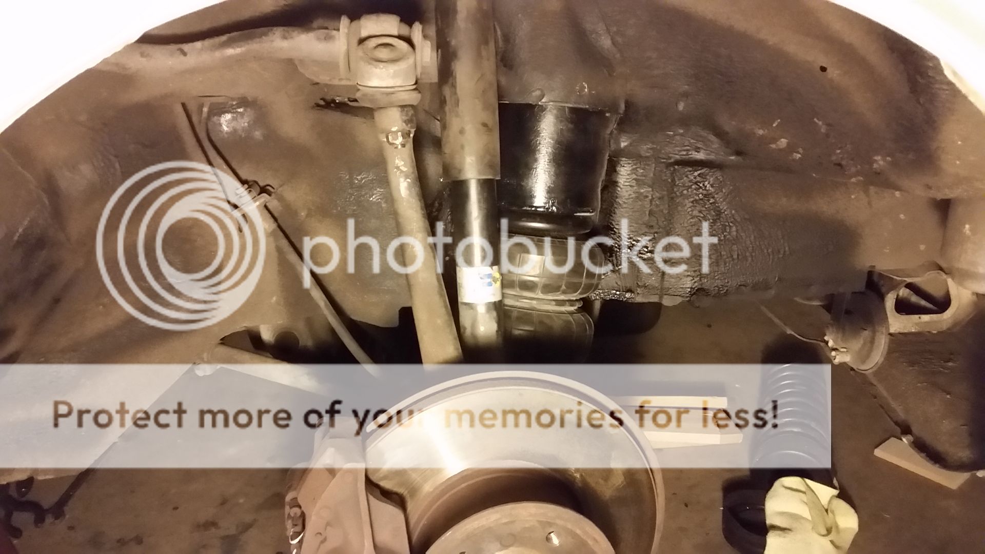

    I touched up the undercoating and painted the mounts. I did discover that my ball joints are shot so I'm going to order new front end parts. Control arms, bushings, shocks etc. I'm just getting antsy to drive it. People at work are sick of hearing about it!

        • #19
          So I decided to hide the wiring on the back side of the panel. Really cleaned it up in my opinion. All I have left is to connect air lines to the manifold, connect the compressor power supply through the tank pressure switch and put the tires and wheels back on the car. I plan on doing a test on it tomorrow. Fingers crossed, let's hope for no leaks or failures!

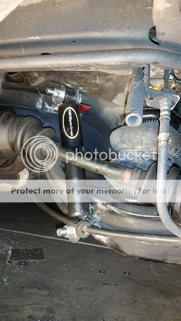

                  • #24
                    Shocks
                    Made some brackets from some angle iron I had in the garage. Welded some herky bolts onto the lower control arms and tested for free movement and clearance. Good to go. The car drives straight, rides great and handles well.
                    • #25
                      The shocks are for the front of a 1949 Plymouth Deluxe. I measured compressed length, extended length and tried to find a car with a similar weight to the Benz. Kind of "eyeball engineered" the mounts. We'll see how it works in the long run.
                      • #26
                        search for dual eyelet suspension, the more familiar (least expensive) C4 corvette rear shocks

                        • #27
