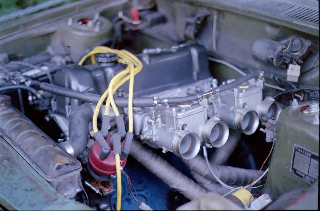

Finally got around to getting my header installed, Primed/painted then wrapped. Nowhere local does ceramic coating and with me leaving to ontario for work in a few weeks decided to go this route so the car will be driveable while I'm gone incase dad needs to move it in/out of the garage.
Spent a good 30 minutes turning it every way possible trying to make it fit without dropping the centerlink but eventually had to go that route. Of course it didn't want to budge so after spending awhile beating on it I eventually went out and bought a tierod end wedge kit and had the 2 joints off in 5 minutes. A lot can be said for having the right tool lol.
Tomorrow morning I'll go about putting the 45s on and then I'll be waiting for my valve cover gasket, throttle cable and bottom linkage that I ordered to arrive.Last edited by CrunkGoat; 07-11-2017, 05:54 PM.Instagram @markrogerson
