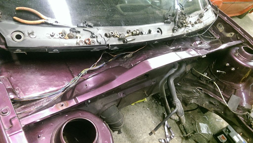

    started re routing wires got headlights running down the chassis legs and a few things routed in the rain tray

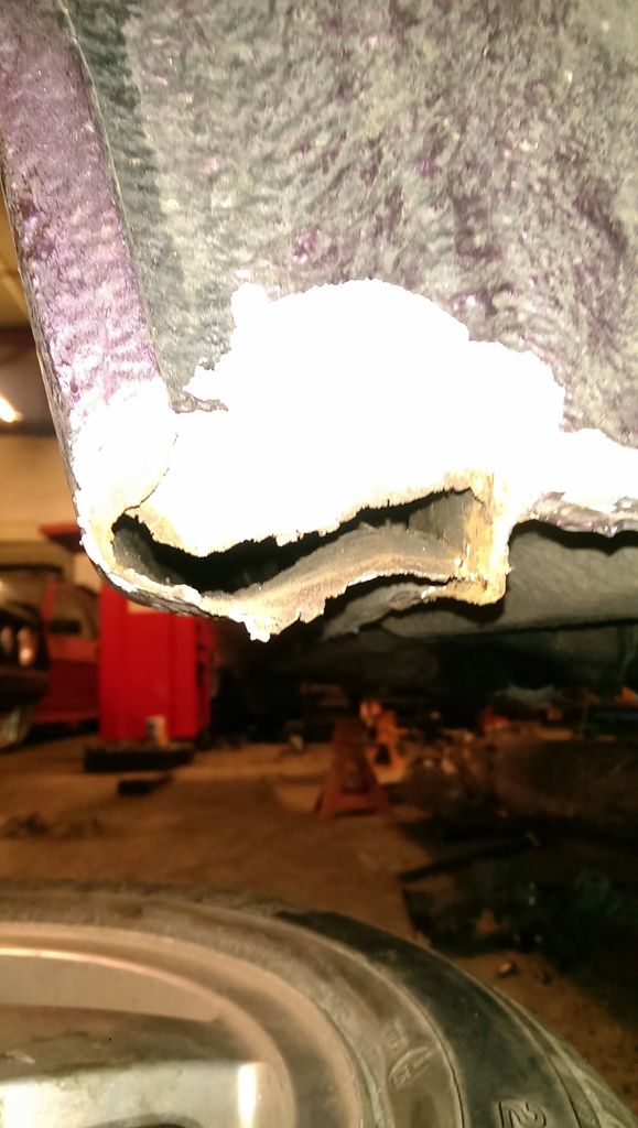

    found a couple bad rust spots that I still need to sort.
