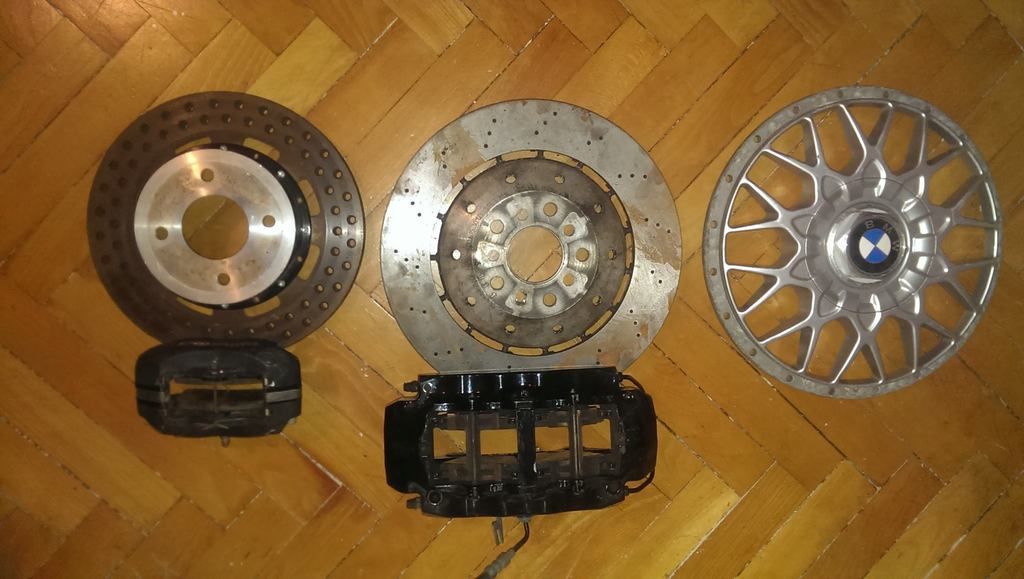

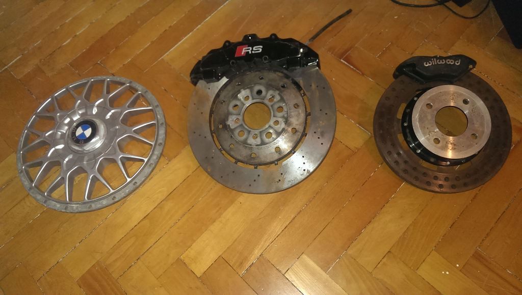

    You are right,i'm waiting for it too but first i have to fix some electrical issues.
    Also i have to put these on :
    365mm 8 pistons, 4pads Audi RS6 calippers and discs on front, 312mm 4 pistons wilwood on rears.(that's an 17" center - for comparison)
