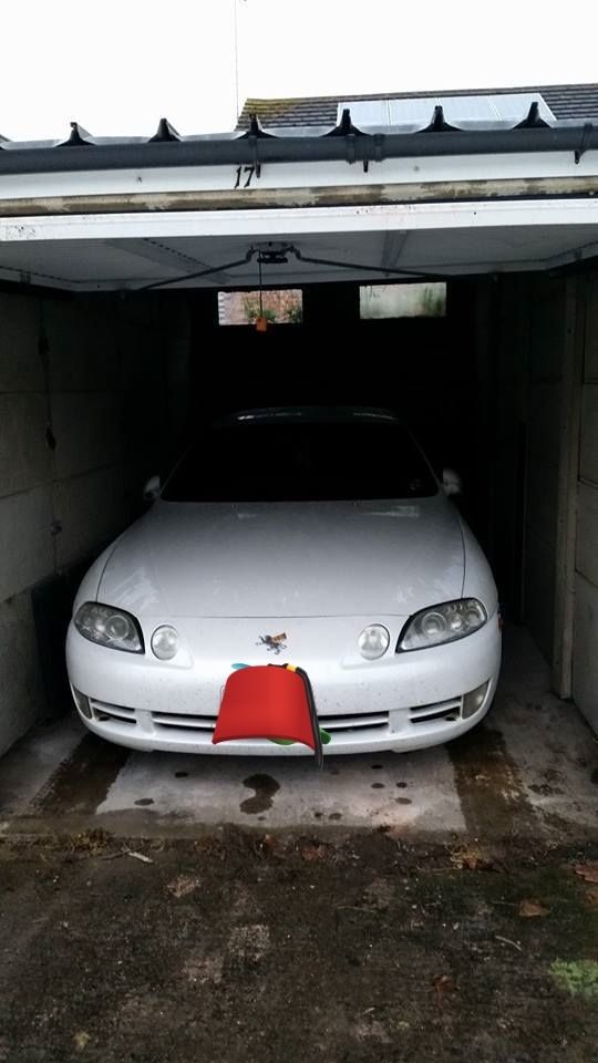

    Bought myself a Soarer in March 2014 and have been building it since then.
    Im coming towards the end of the build now, maybe 6 months work left (depending on how much money I have to put in to it) but decided its about time I created a build thread for it.
    Lets start with the day I bought it, she wasn't very pretty, needed a lot of TLC and had some ugly as hell "Lexus style" headlights but had a few really nice features that I could work with. Including a set of 18x8.5 and 18x9.5 Work Rezax1 wheels which were in terrible condition but had a lot of potential, but we will come back to them later!

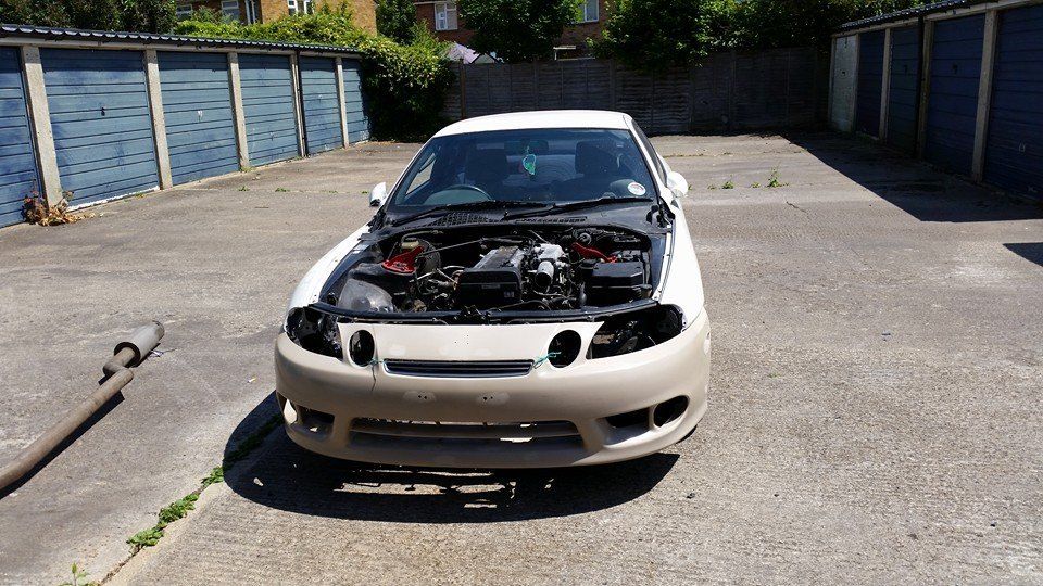

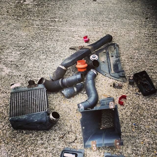

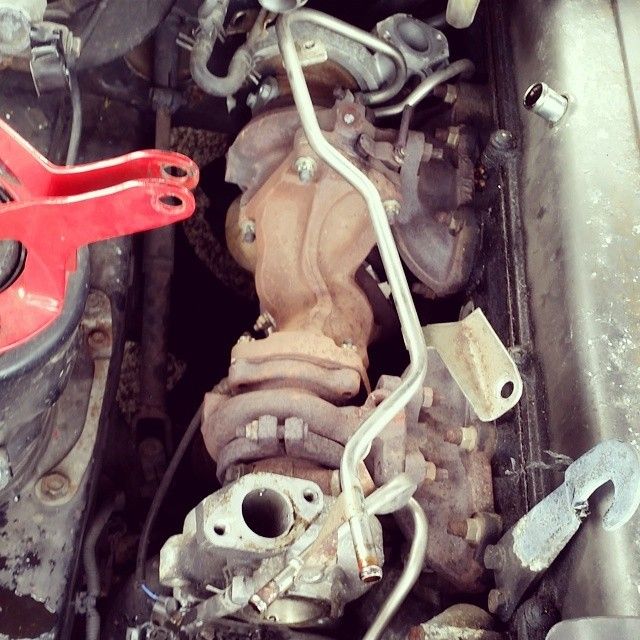

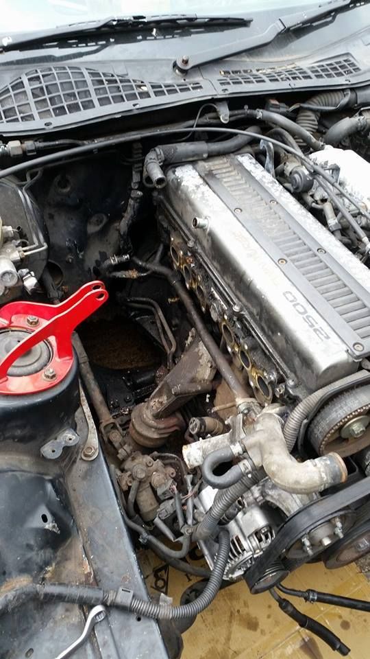

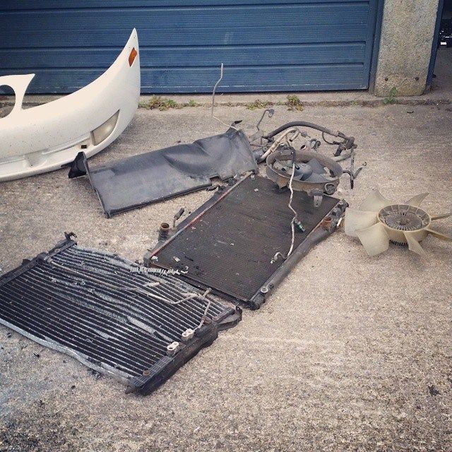

    From there I proceeded to strip out all the junk that I didn't need anymore. The stock radiator, the air conditioning and the factory side mount intercooler all got scrapped.

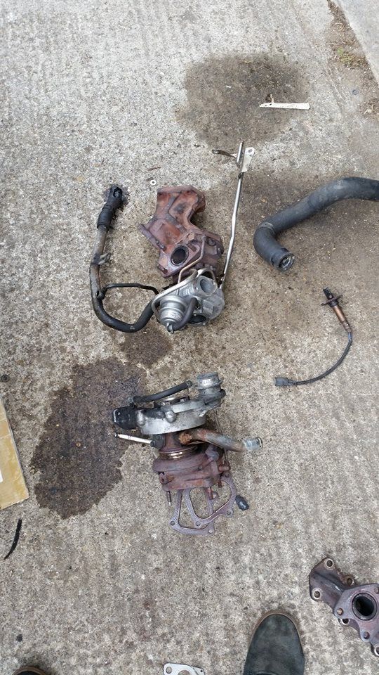

    As well as binning off the little factory twin-turbos that the 1JZ under the bonnet came with

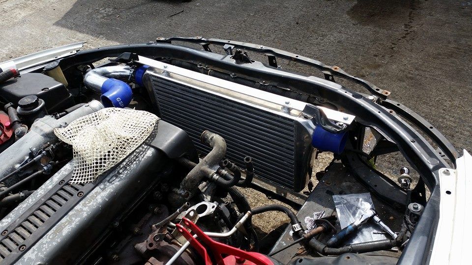

    Which opened up a lot of space in the engine bay ready for the mid mount intercooler I decided I wanted to run

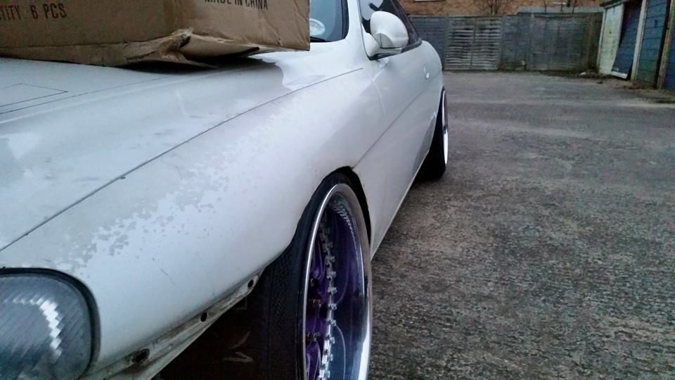

    Next up came a set of HSD MonoPro Coilovers to bring the massive coupe down to a Stanceworks worthy height

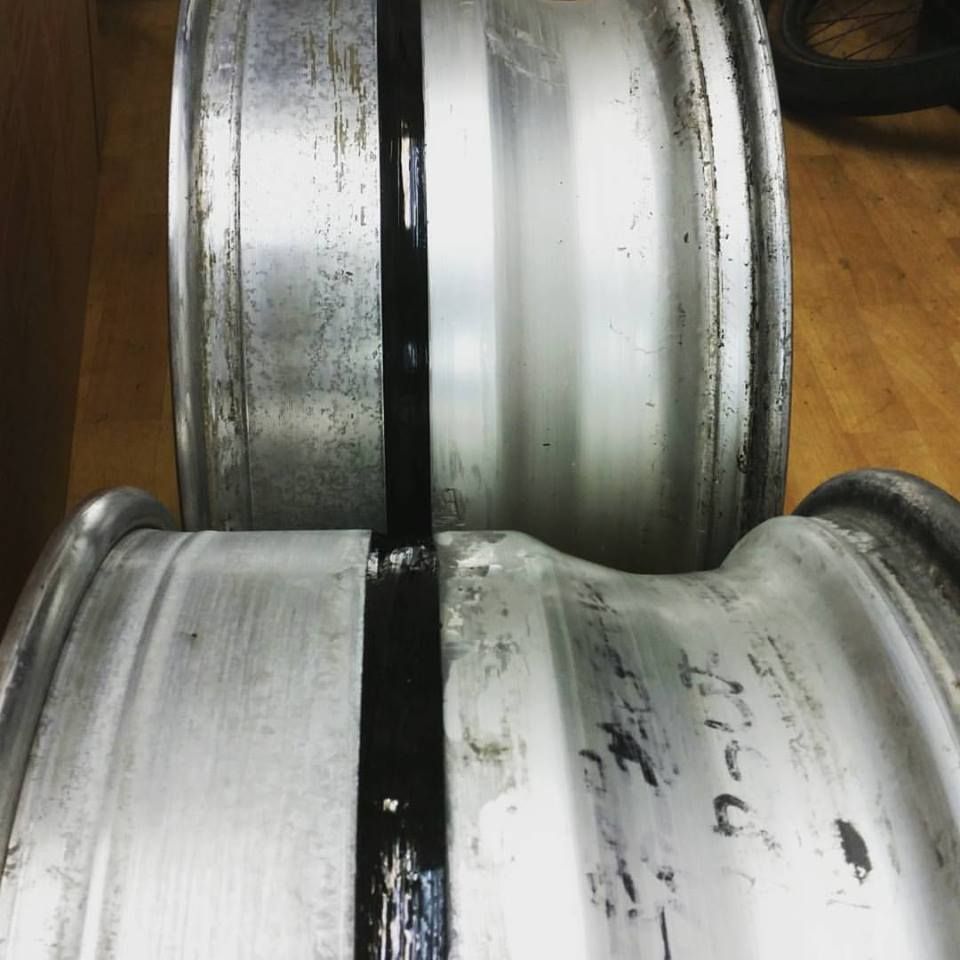

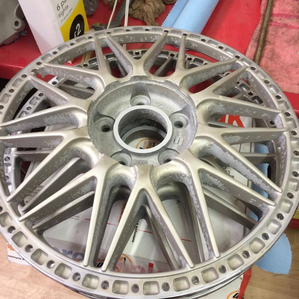

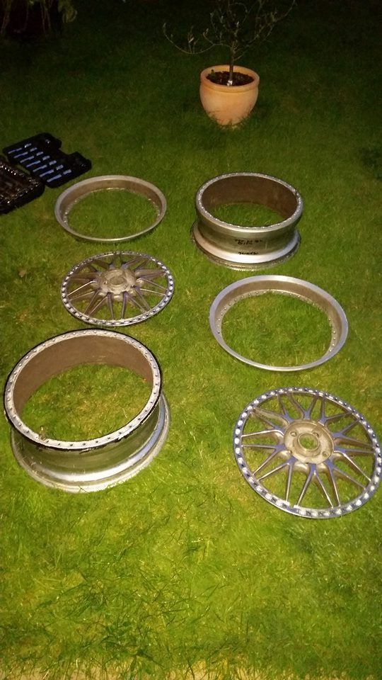

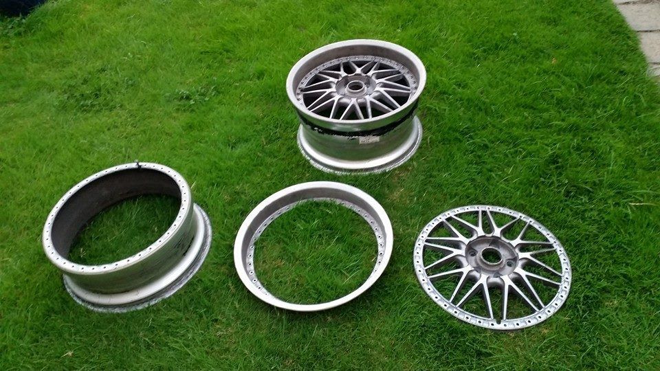

    Now you can see the Work wheels I mentioned earlier. At 8.5" et45 and 9.5" et45 wide they were no where near manly enough for what I wanted! So I stripped them down and sent the centers away to be sand blasted ready tor some fresh paint
    All 4 were done but I only took pictures of 2 or them. Unfortunately, many years of being poorly looked after by the previous owner has left them pitted and far from perfect. But I think they will be fine with a lick of paint. I as I dont have the centre caps I had the threads machined off to give them a cleaner look.

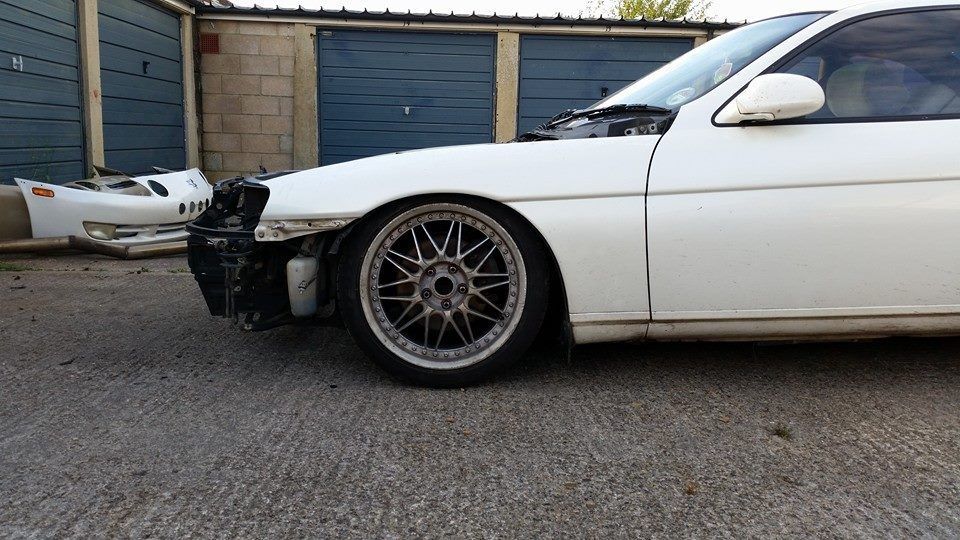

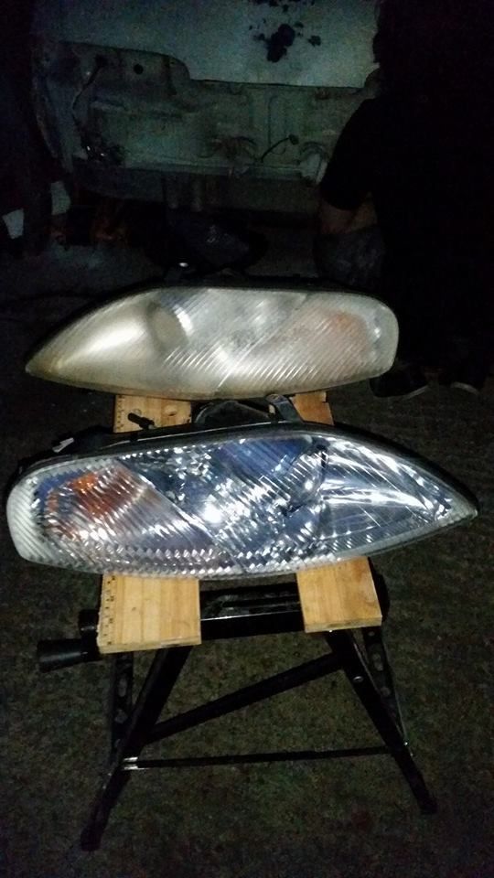

    I got very lucky on eBay and managed to pick up a BRAND NEW unpainted facelift front bumper and some pretty tatty OEM headlights
    Which with a good polish came up good as new!

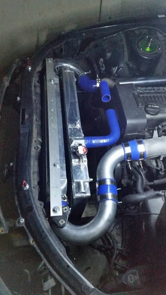

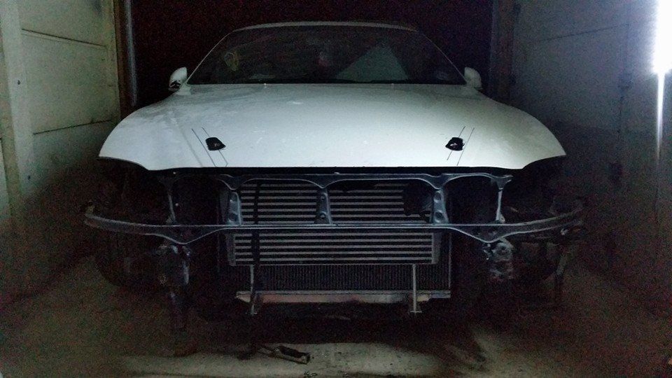

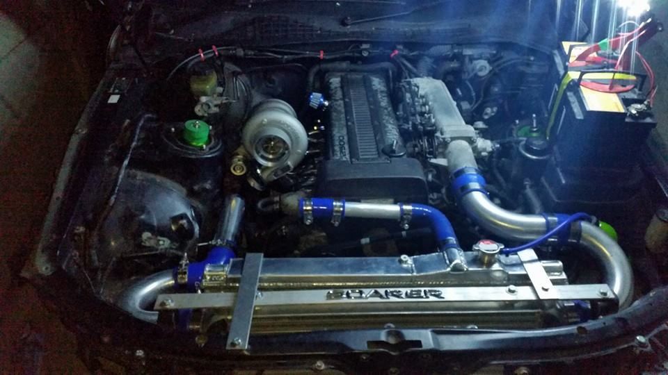

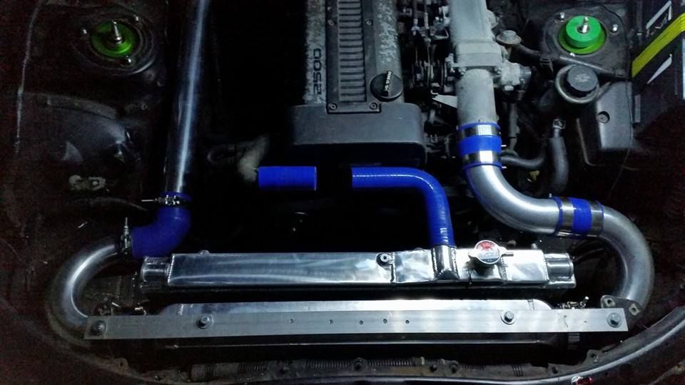

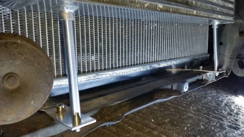

    I also fitted my a new 50mm aluminium radiator and started mocking up the intercooler piping
    It looks mean with no front end on it!

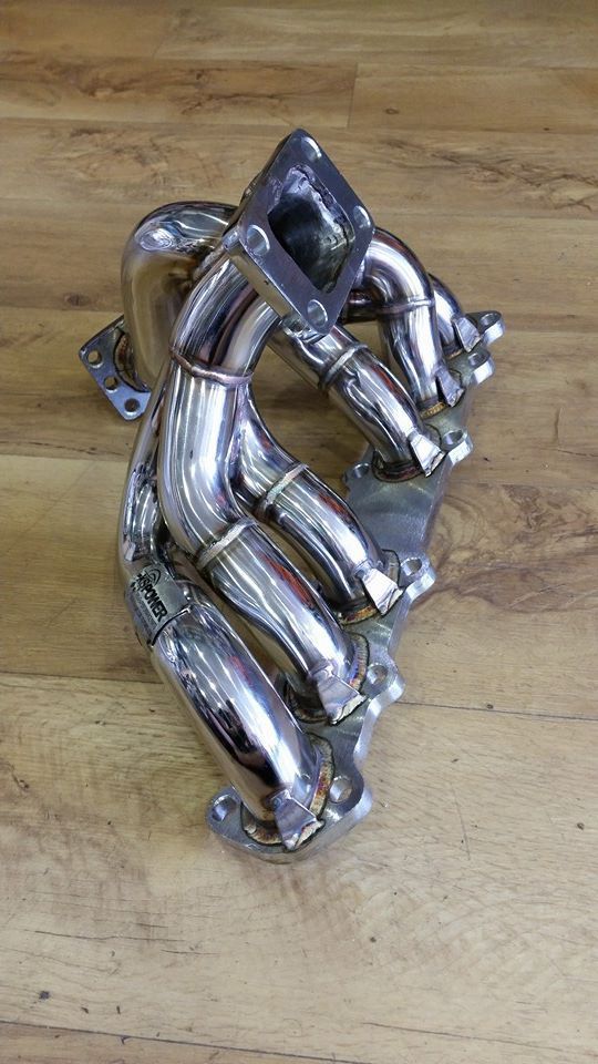

    THEN THIS ARRIVED!!!

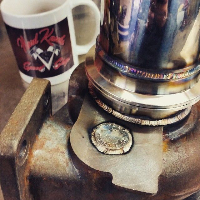

    and I bolted a little Holset HY35 Turbo on to it

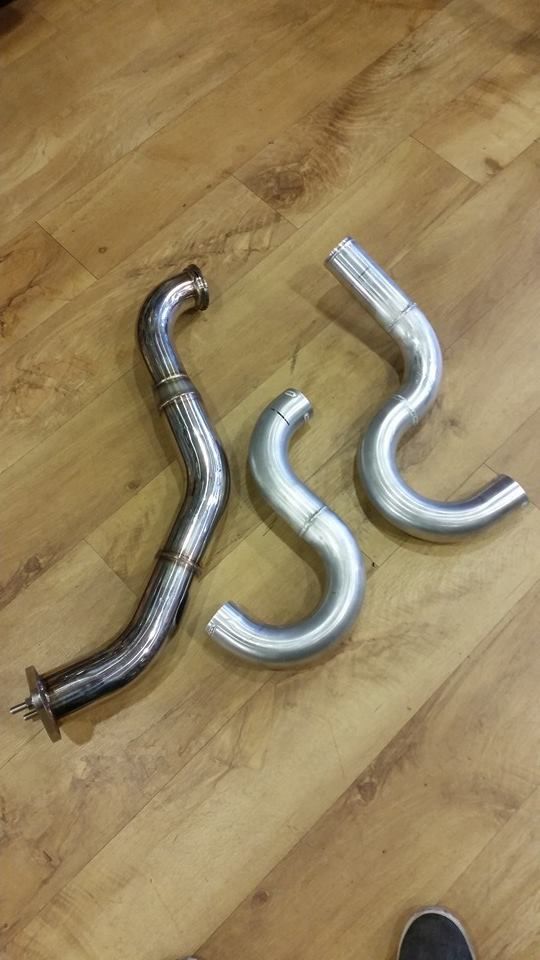

    The internal wastegate didn't stay though. I had the back of the turbine housing milled off, welded the internal gate closed and replaced the stock 2.5" V-Band outlet with a 3" stainless V-Band outlet.

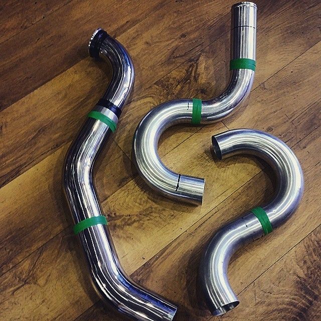

    Mocked up my dump pipe and intercooler pipes one final time then took them to be welded

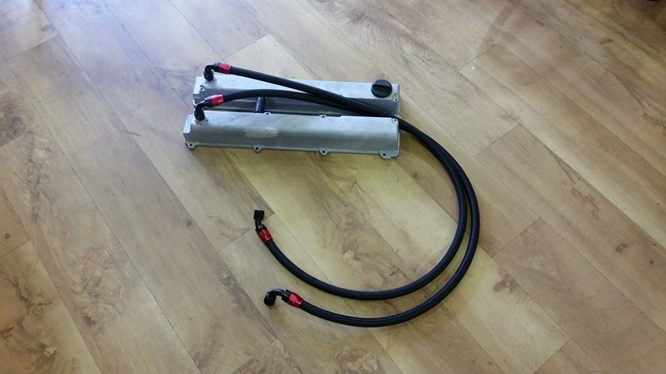

    Sand blasted the valve covers and had the factory breathers and PCV welded shut. Welded -10AN fittings in to the top for my catch can setup. It has also beed painted black and fitted back on to the car. But I haven't got any pictures of that yet.

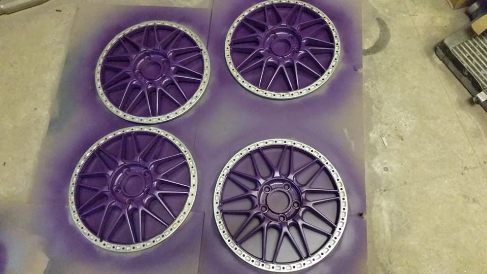

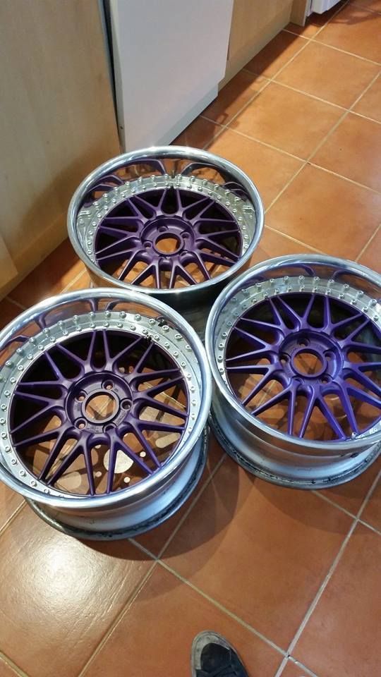

    BACK TO THE GOOD STUFF!!! My new lips arrived from America!!! Time to start rebuilding the wheels.
    Fresh galaxy purple paint on the centers to start
    I got a bit carried away building the wheels (I was way to exited...) i forgot to take photos.
    Buy here is the finished product! 18x10.5 et20 and 18x11.5 et20

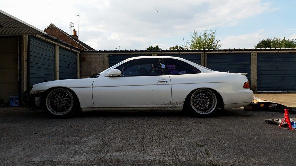

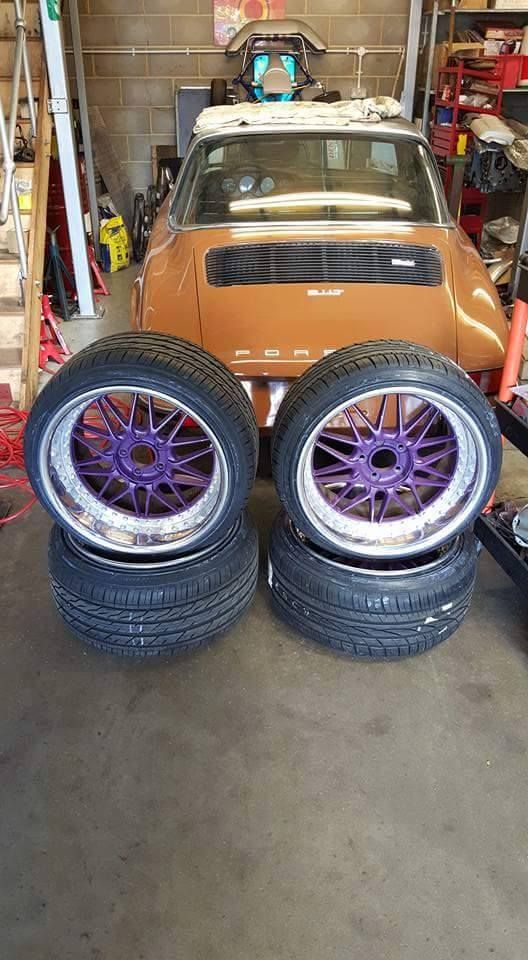

      Fitted some tyres!
      235/40/18 on the 10.5J fronts
      and 265/35/18 on the 11.5J rears

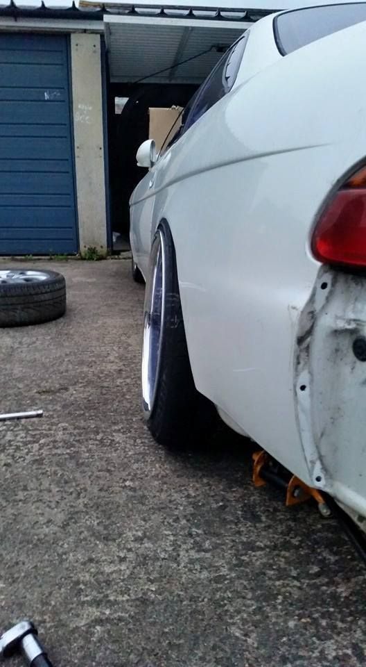

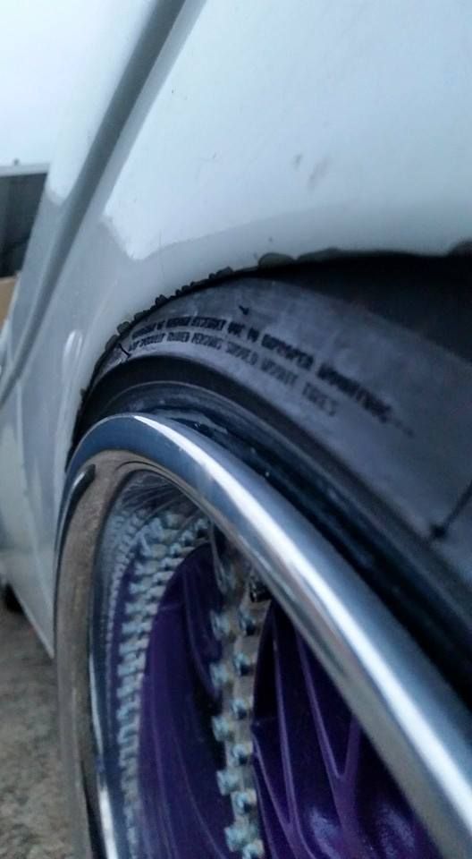

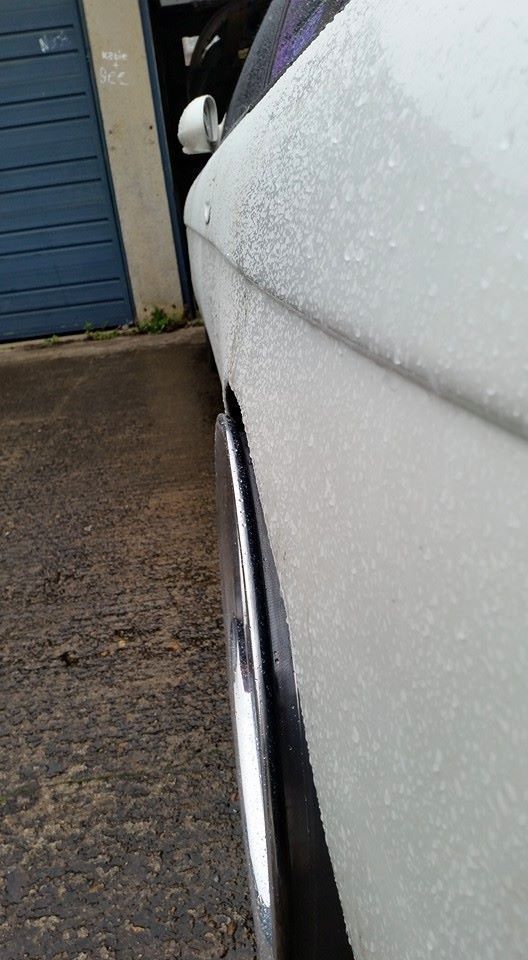

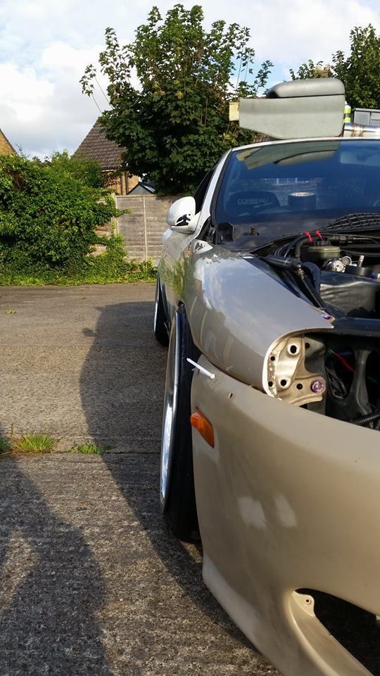

      Got them on the car (kinda...) Rear arches are definitely going to need pulling to fit but I think im going to have to go for smaller tyres in order to get rid of the camber...
      The front tyres are going to have to be smaller too as they rub on the inner arch pretty bad, so im gonna go down to a 255/35 on the rear and 235/35 on the front for more clearance. Ive also put 20mm spacers on the front since taking these photos so fitment is a hell of a lot better!

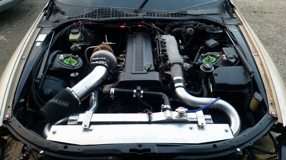

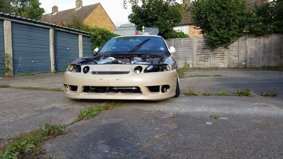

      I also finished up everything in the engine bay.
      So now all I need is an ECU so run it all and an expansion tank for the radiator.
      Also fitted some electric radiator fans and controller, catch can, intake pipe and new front wings (Because i destroyed the white ones trying to fit the front wheels with 235/40)

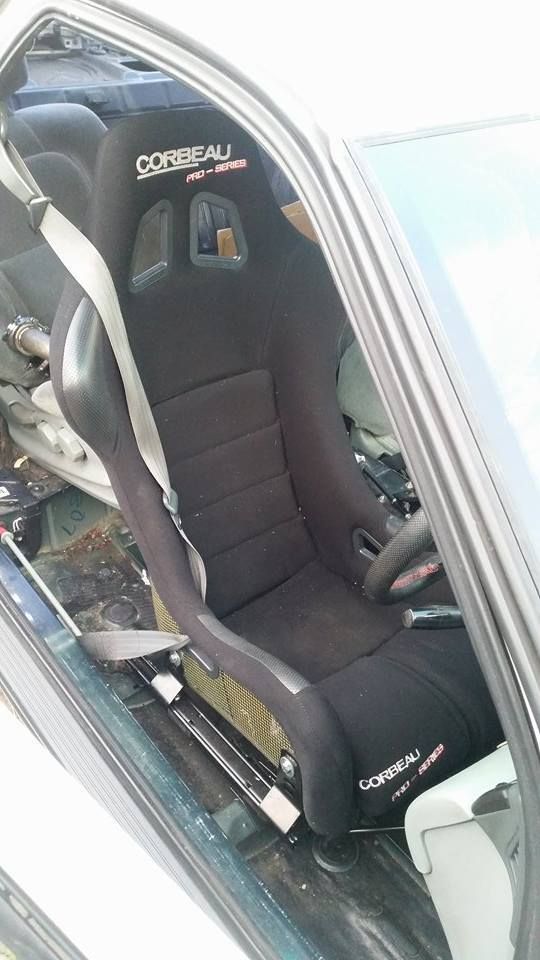

      But for today I will leave you with a photo of my new Corbeau Pro-Series Carbon/Kevlar seat I picked up and fitted
      (Please excuse how messy the inside of the car is...)

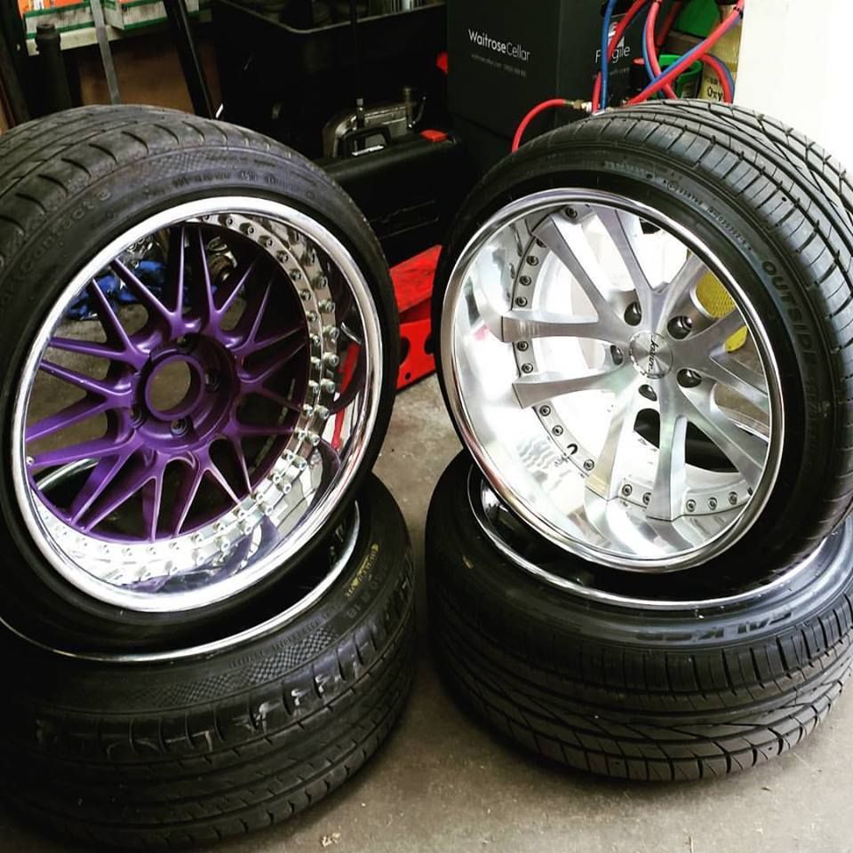

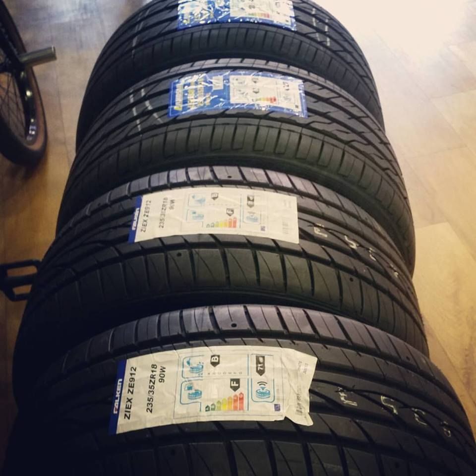

            But my new tyres arrived today and I got all exited!
            Also I resealed my wheels in preparation for new tyres
            The tyres are being fitted as I write this. So will have updates soon with them on the car and getting my fitment dialed in!

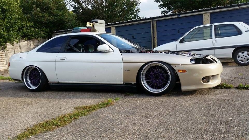

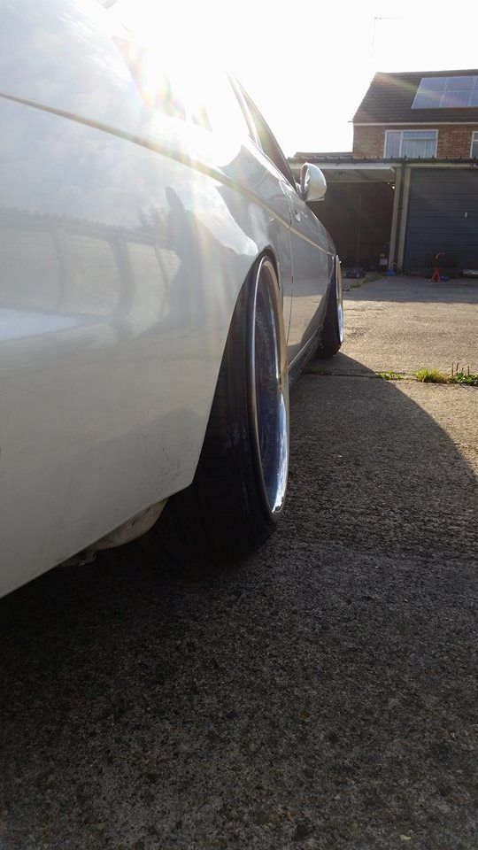

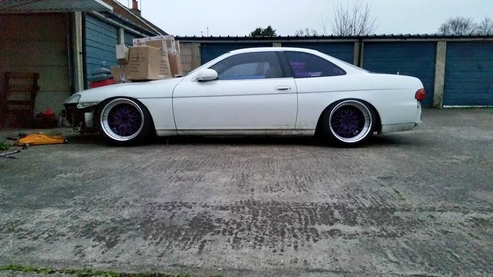

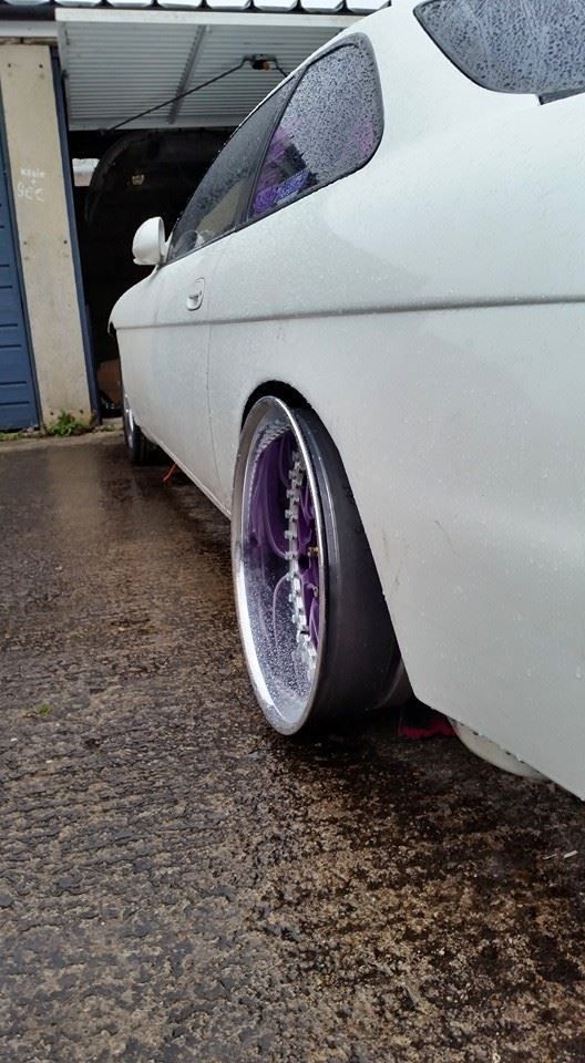

                  Got my new tyres and got them fitted up a few days ago! Im now rocking a 235/35/18 up front on the 10.5J and a 255/35/18 out back on the 11.5J
                  But no one cares about that. Lets see them on the car!!!!

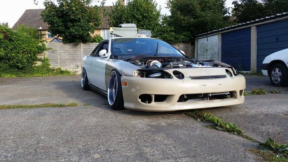

                  I've also maxed out my coilovers now so she cant go any lower
                  Desperately need to get some adjustable rear upper arms so that I can get rid or that negative camber. Front camber is about perfect though, could possibly do with a touch more. I would really like to get the rear sitting a bit lower and tucking the lip, so I might need to get some shorter springs and I think im going to need stiffer springs up front too to stop the tyre hitting the inner arch.
                  Thats all for today folks!
                  Im sooo freaking happy with how well it all fits now and how the car is sitting. Need to get round to replacing the bonnet so it looks a little less "mad max"
                  Im gonna leave you today with a photo of Zach Triggs SC300 (if thats allowed?) his car has been a huge inspiration for my build and I love it! If he can tuck rim on a 215/35/18 I sure as hell can on a 255/35!!!

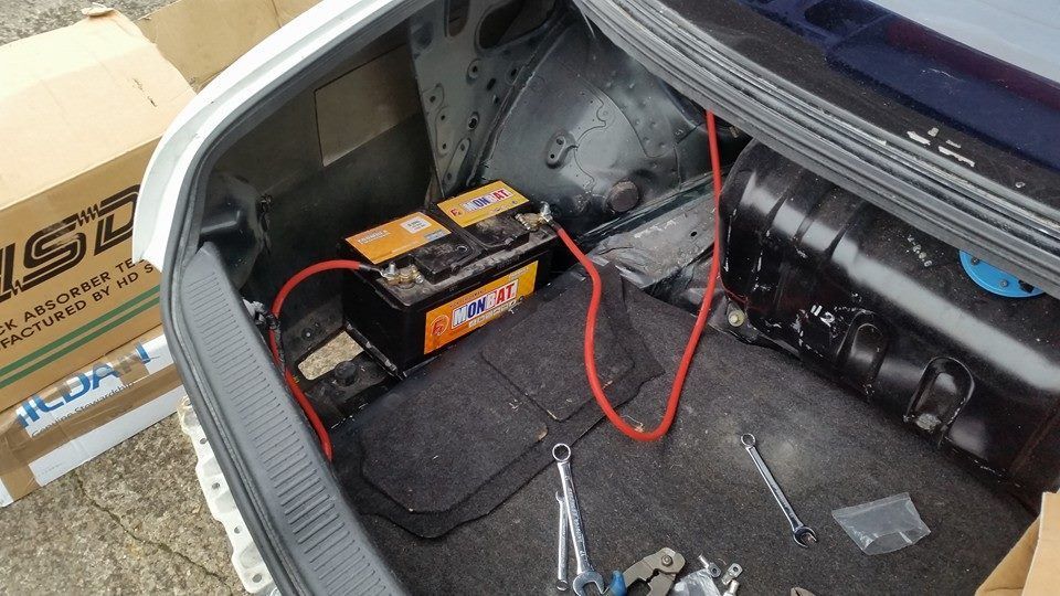

                    Finished relocating the battery to the boot/trunk

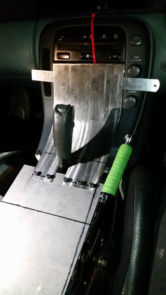

                    And started fabricating my stainless center console which will house a few gauges and my boost controller
                    Yes is is still an automatic
