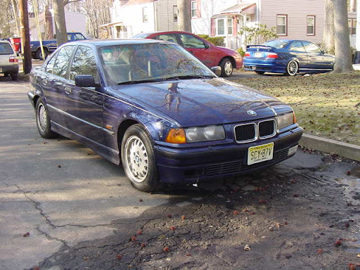

    Just brought her home for the 1st time

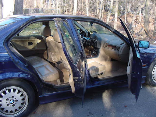

    Clean on the inside

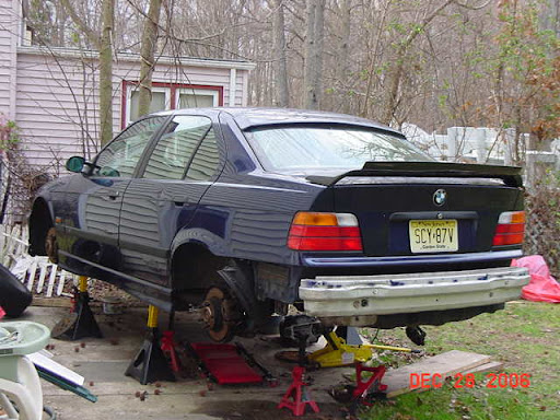

    Sitting in the Backyard waiting for a Tranny - Auto to Stick idea is conceived

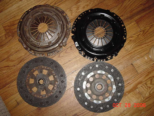

    Got the new clutch and pressure plate:

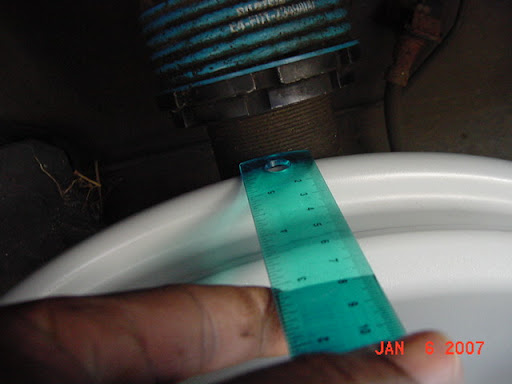

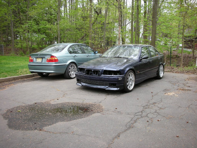

    Tried on new rims, check clearance and width

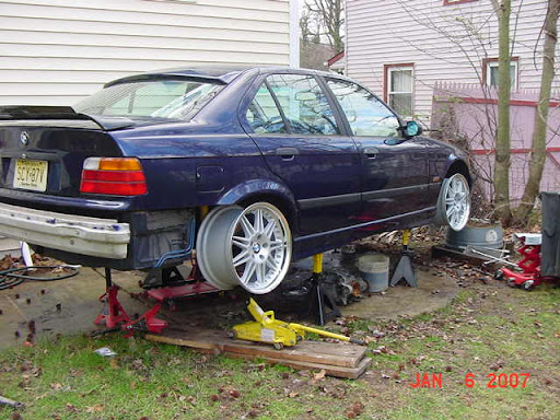

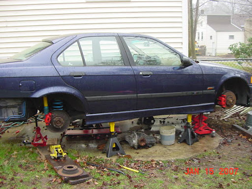

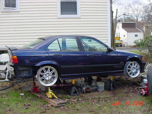

    Auto to Stick - Installed Coilovers at the same time:

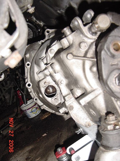

    Final hoisting of the trans Harbor Freight Jack was integral and very cost effective

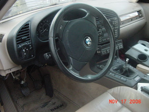

    Pedals - Shifter and Trans in

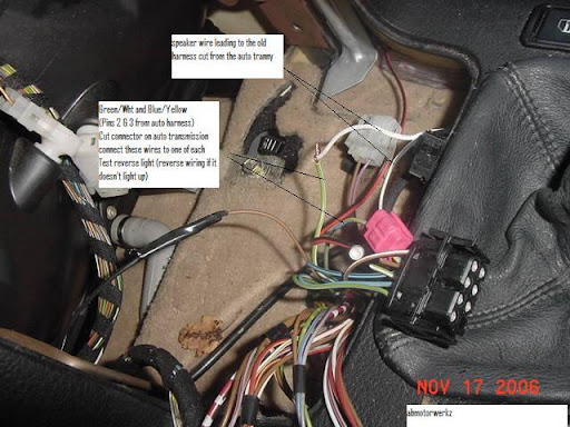

    Wiring just so it would start and retain cruise control, etc

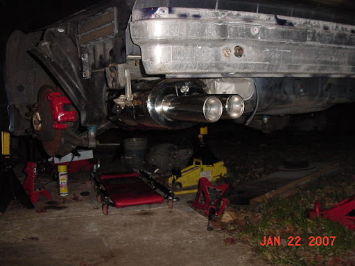

    Installed new catback exhaust - yeah January freezing outside but I was motivated

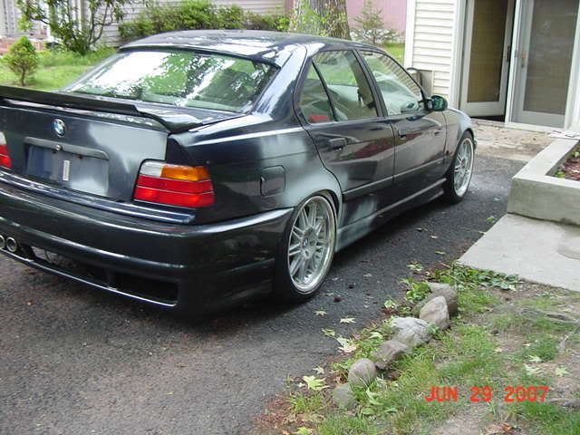

    Just after experimental driveway paint job
    Shortly after paint Job

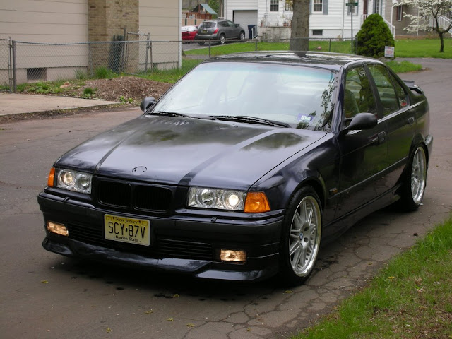

    So here is where it is present day with still lots more to do before I am satisfied,
    At Home

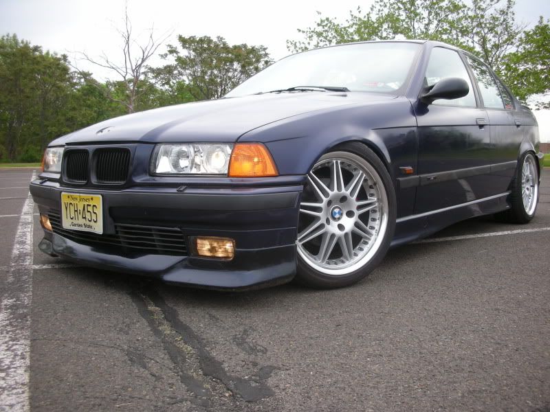

    Parking Lot at Work
    Parking lot at work II
    Parking lot at work III

            Not feeling the kit or the headlights... but I can appreciate the effort you put into it. I wish I was that motivated to do shit on mine :/

                not feeling the bumpers kit. like the roof lip you should of molded and modified the front lower lips.also yeah the manifold conversions fun. how many miles? how long did the auto to Manuel take my friends about to try this
                Jacques Cousteau could never get this low
                  Yeah..a lot of people say that and some don't about the bumper. For me there is a reason. I've had many bumpers that are offered for these cars, I didn't want anything that would not be flexible if it touched the road (i.e. no propylene, def no fiberglass, and the stock M3 bumper is too short and lips for that bumper typically rip off eventually. This one does the trick and is made almost out of rubber and doesn't complain from the odd "grounding out". That being said I'm leaving it although there are many more attractive ones out there...but I mean to drive this car..
                  The auto to manual with every single part on hand can take two able bodies about 2 days to finish including removing the existing tranny and installing the new one. It was a great project and I came away with a great feeling of accomplishment and satisfaction after all I'm just an Internet Mechanic LOL..
