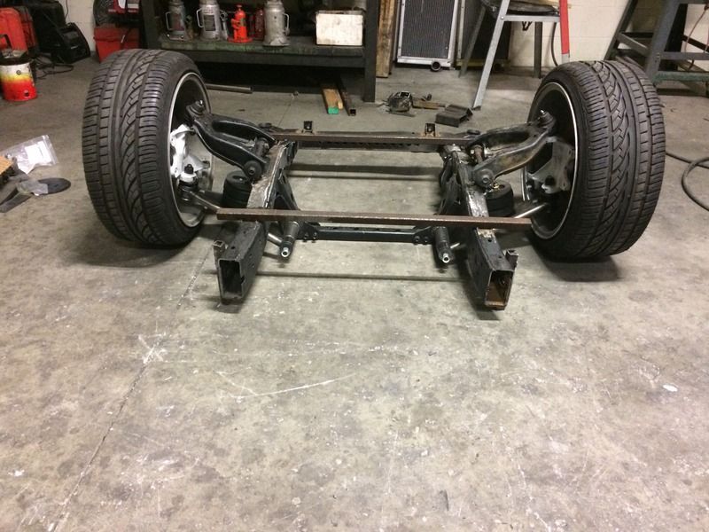

  • #DrgnBnz
    replied

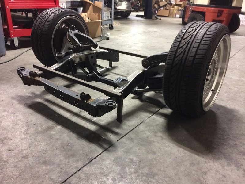

    More Progress on the fame, hope to make her roller in the next few weeks

  • #DrgnBnz
    replied
    Originally posted by Asshole Bicycle View Post
    Why the positive camber?
    Originally posted by drifte View Post
    Yea, kinda looks like positive camber aired out and aired up. Is the lower control arm too short or something?
    I think this mite be a bit of an optical illusion due to the camera angle. Also the upper arms are still adjustable to compensate for camber and castor but currently have no shims in them at all. Although the design with the shorter upper will cause positive camber at full lift, the car will almost never be driven at that hight. I will try to get some better pictures later

  • drifte
    replied
    Leave a comment:
  • Asshole Bicycle
    replied
    Leave a comment:
  • #DrgnBnz
    replied
    Spent the weekend out in vegas for stancewars and waterwerks
    But now back to my project hoping to get the main rails down this coming weekend but till then
    Down
    UP

  • #DrgnBnz
    replied

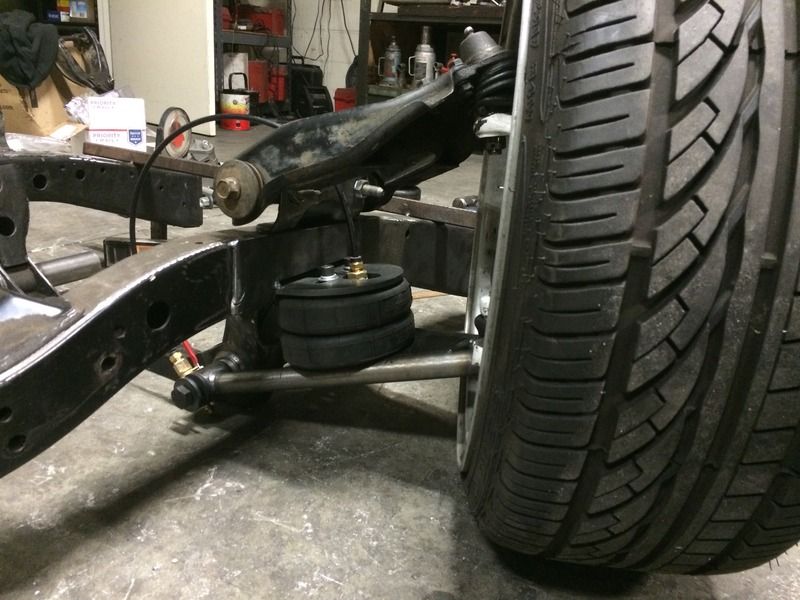

    Waiting on some fittings in the mail, then will get picks of lift hight, I can only do one bag at a time right now

  • #DrgnBnz
    replied

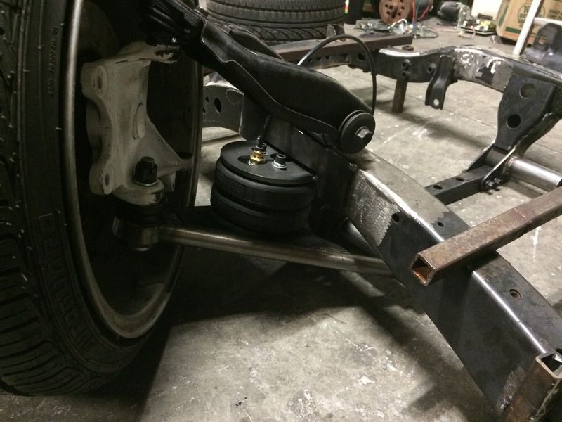

    Fronts just about done, everything is taked up and clearances are good, just need to gusset and finish weld
    This set up gives me 9" of lift
    [IMG][/IMG]

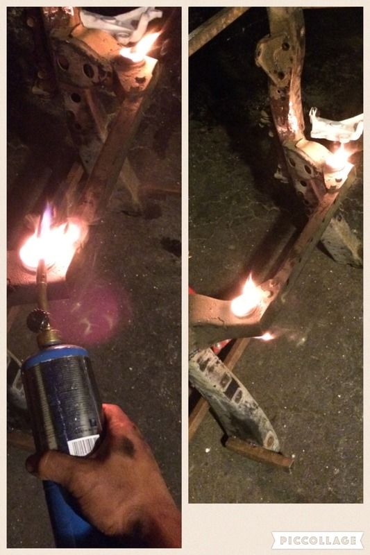

  • #DrgnBnz
    replied

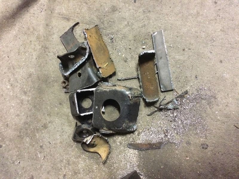

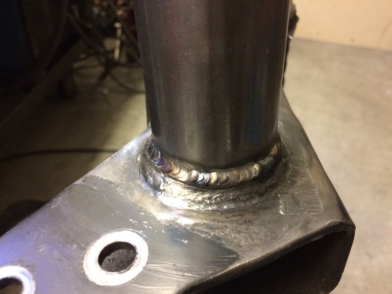

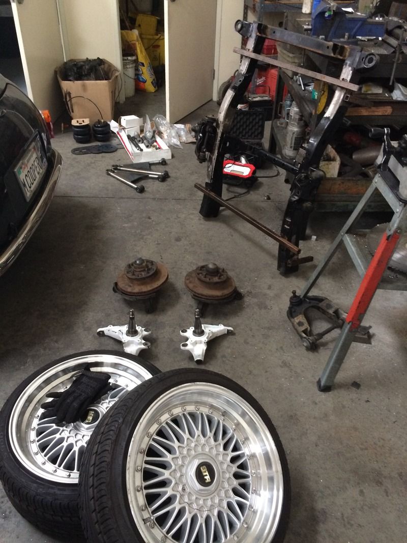

    Got a lot done over the last few days
    bushing removal
    Start to the weekend
    TIG for the win
    left overs
    front clip Update coming soon, still have a few things to finish up
