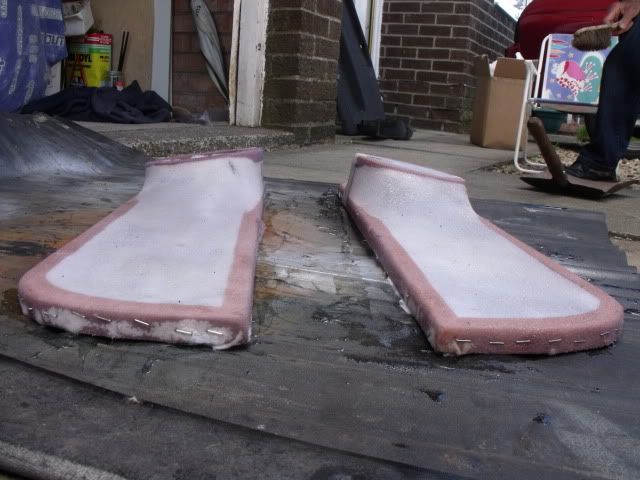

    some pics of engine swap and door pods I made (sounded ok but didn’t look the greatest was a first attempt at that sort of thing (these were scrapped at some point also)

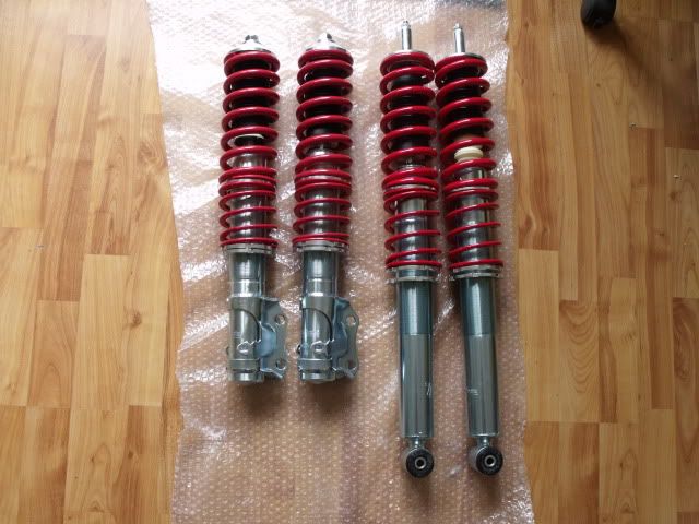

    Shoved some cheap coilovers on
