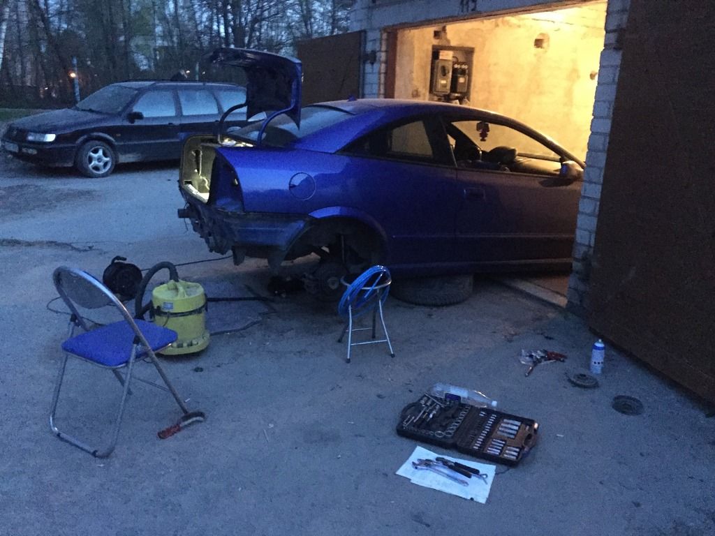

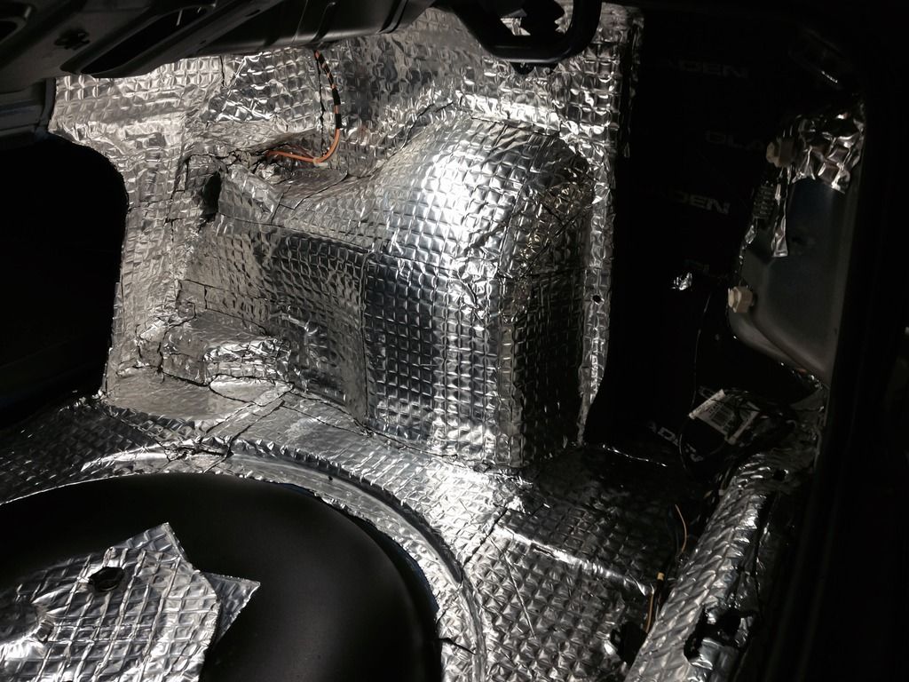

    Did alot of work this weekend

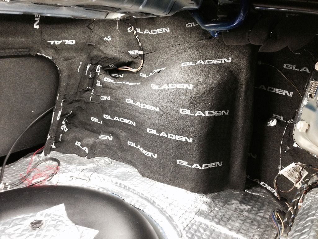

    Finally finished applying vibro and sound deadening.
    Few pictures from the earlier applying process. Going to put more pictures later

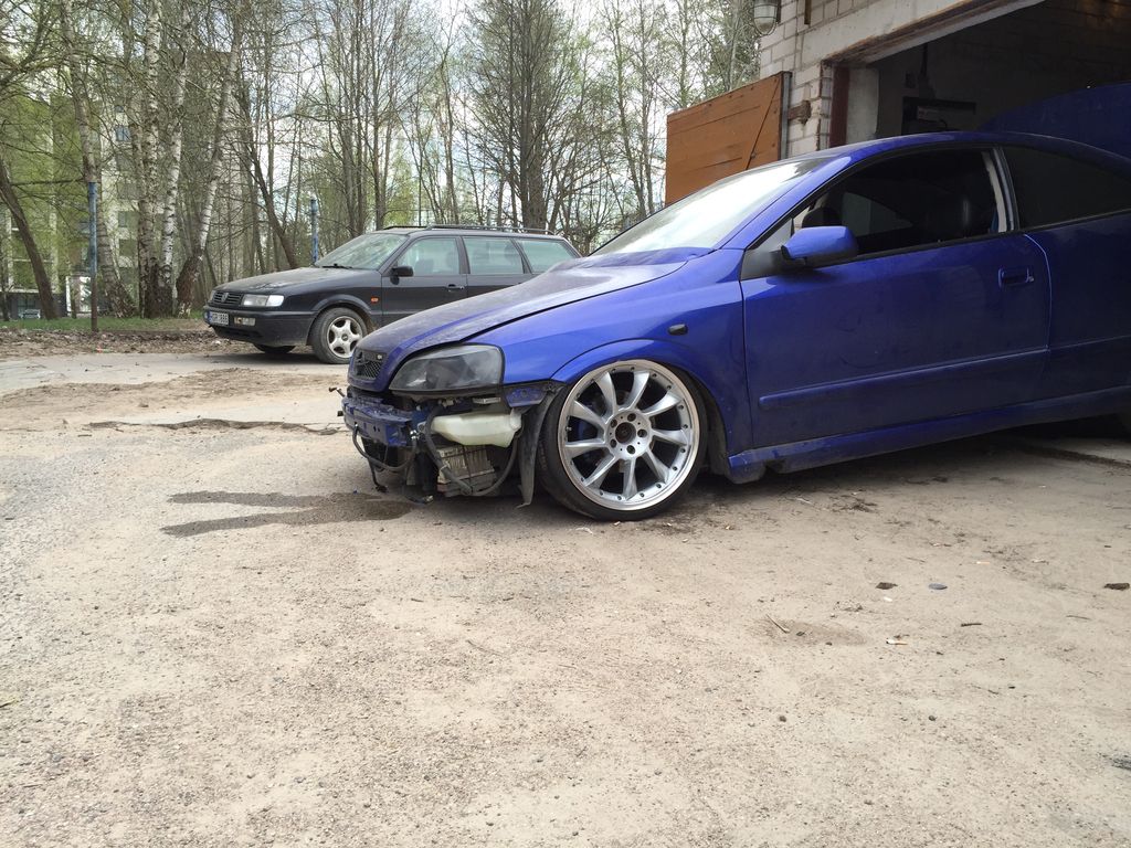

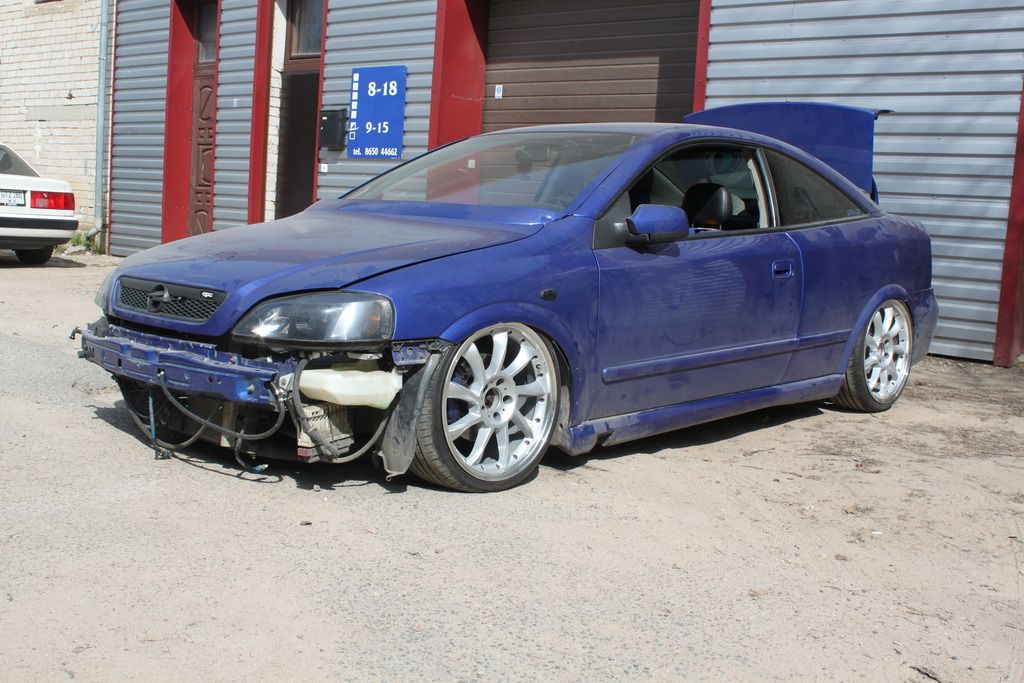

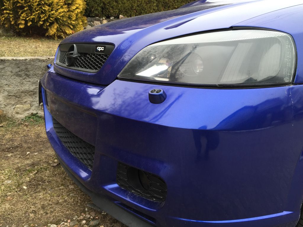

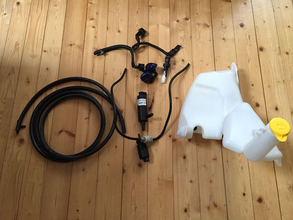

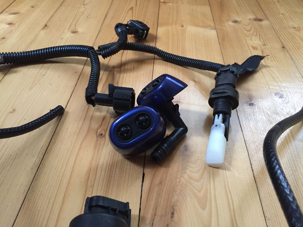

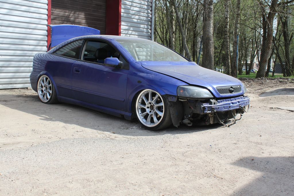

    Next day fixed my bumper holders(carriers IDK how to spell it correctly) and added a headlight washer system. I have some leaking now, because i decided to use few of the old OEM connections...Going to fix it next weekend
    In my opinion the front end looks much better with washers

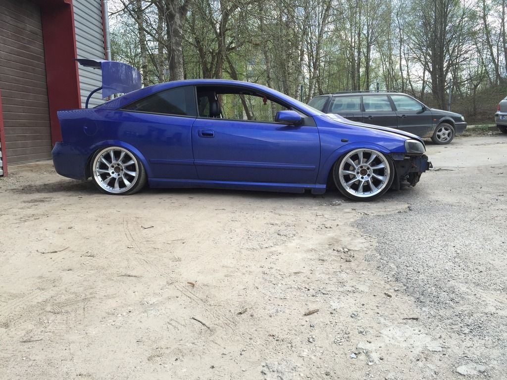

              Season is almost opened

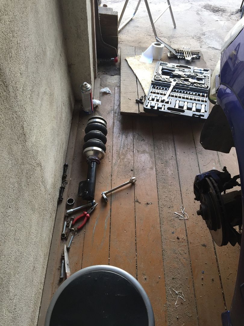

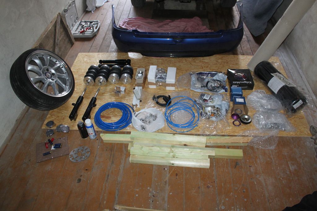

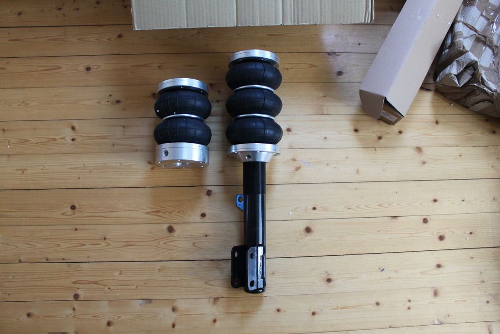

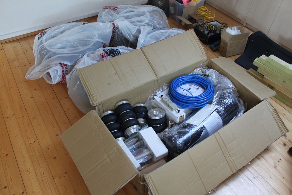

                So after receiving my airride kit, for sure the first thing was to open the box and make few shots

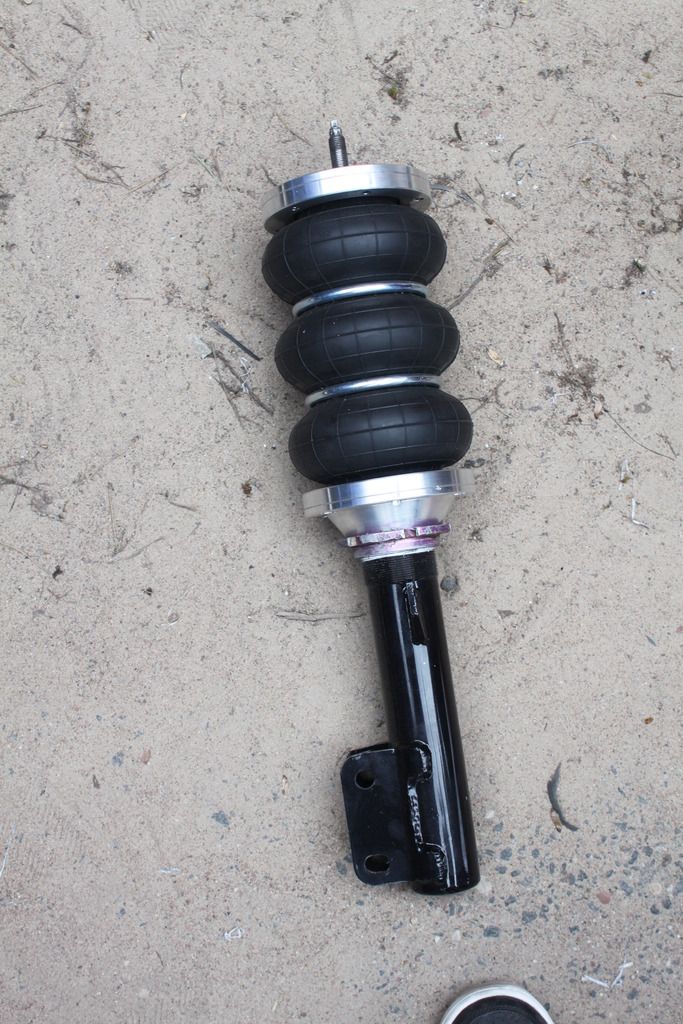

                Then test fitted my bag on my coilover to make sure measurements are okay and everything fits well. As you can see from bag is Rubena 3 and rear is Rubena 2

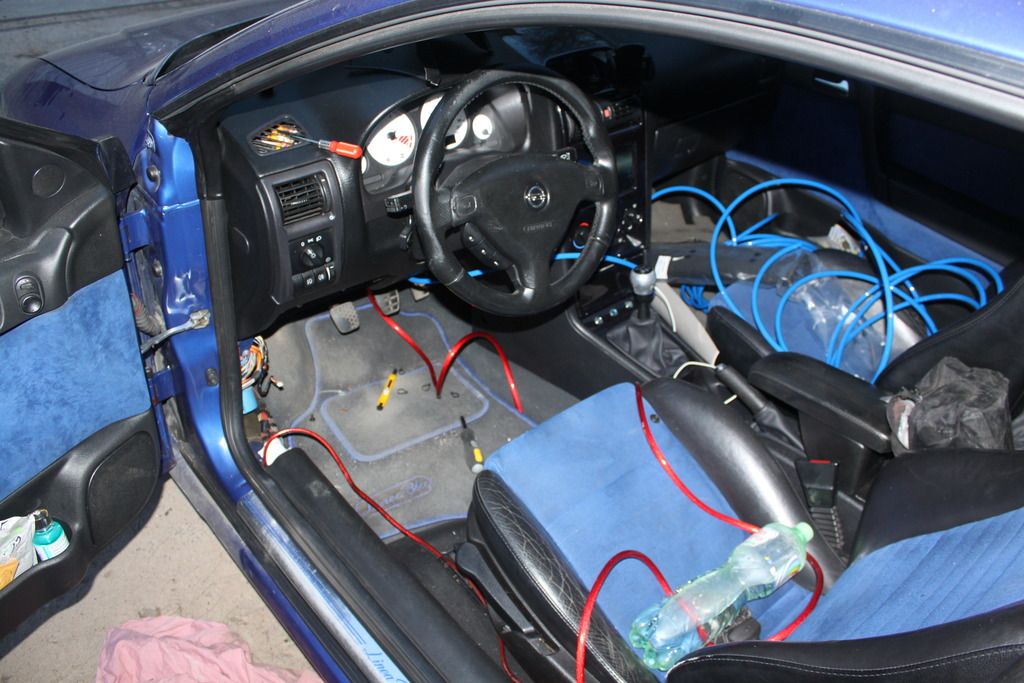

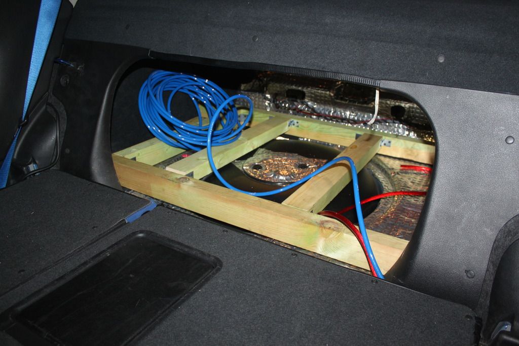

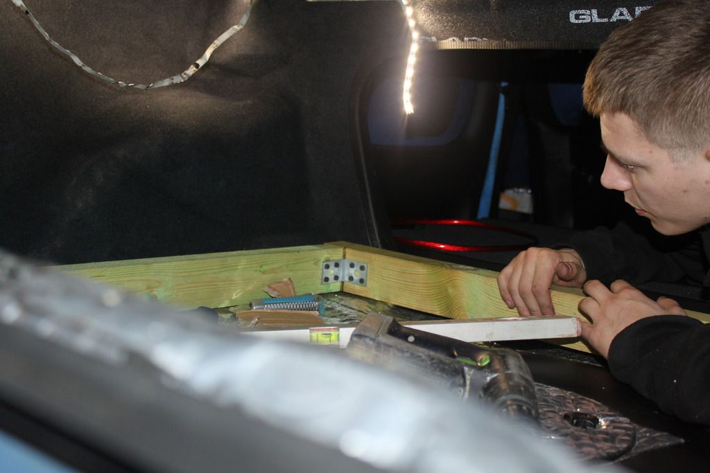

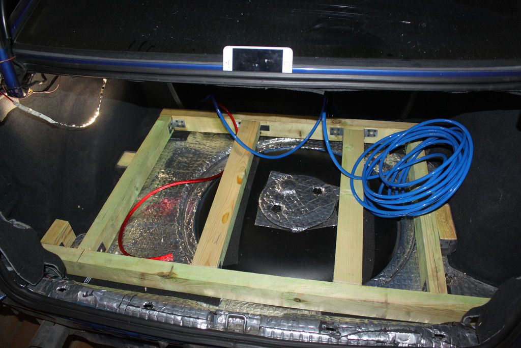

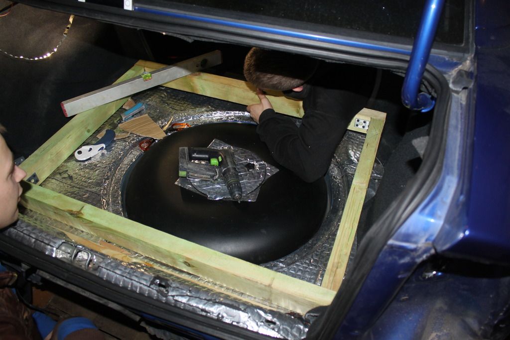

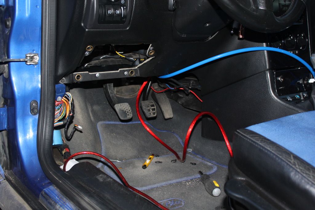

                So while my friends was making a frame for the boot, i layed the airlines from the front to back and the cable from the battery to the boot.
                Guys already had some progress
                Shot from inside:

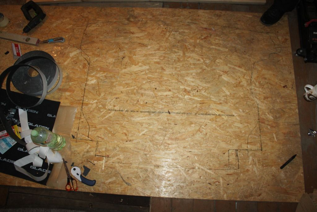

                Then it was time for the cover, alot of measurements and the shape was on the panel.

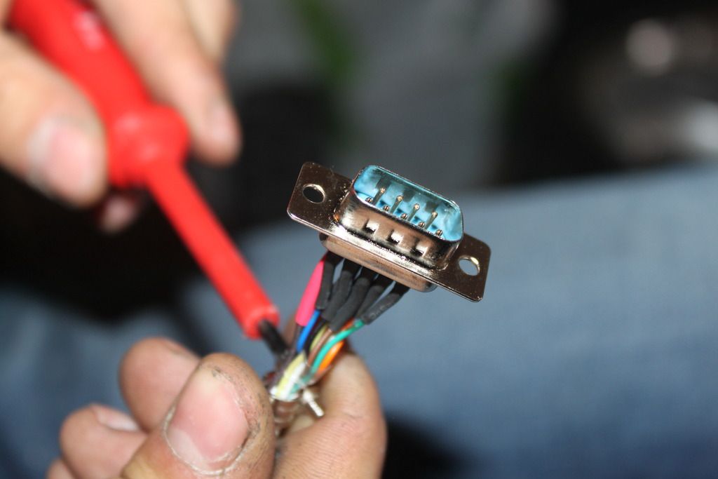

                While guys was making the panel, i ran remote control where i wanted it to be.

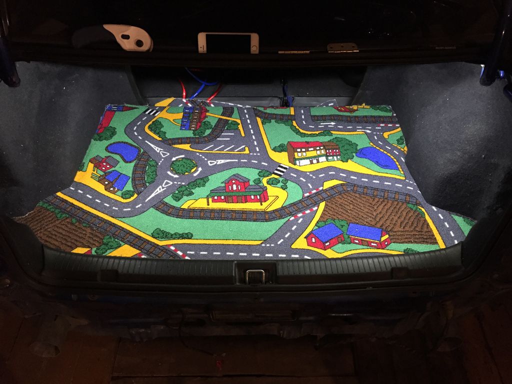

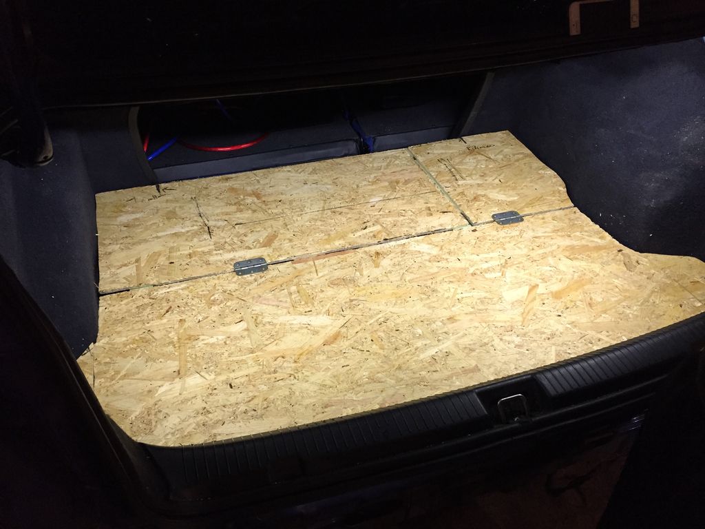

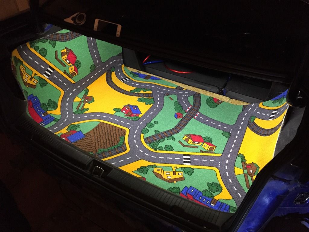

                Then test fitted the rug, but we didnt like how it looked, su used another piece of it.
                Finished making shape.

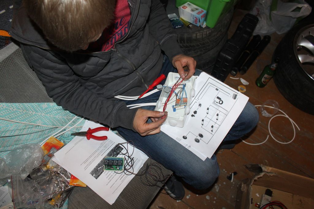

                Then it was time for AirRide things.

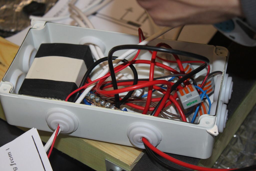

                Electrical things...
                Suspension things...
                More electrical things...

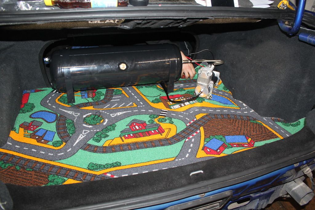

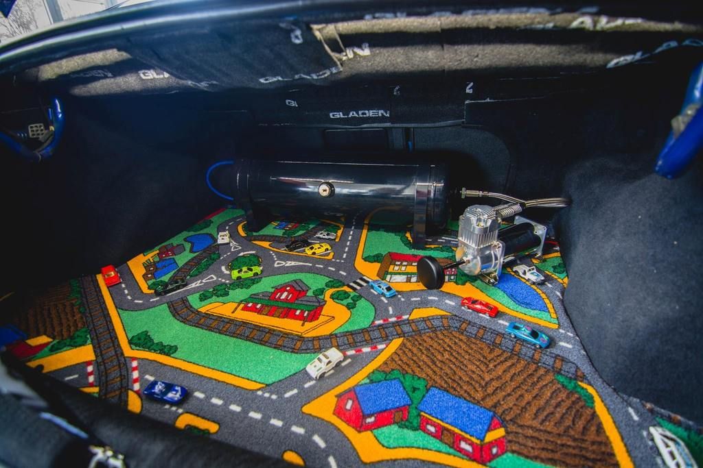

                Fitted the tank and the compressor

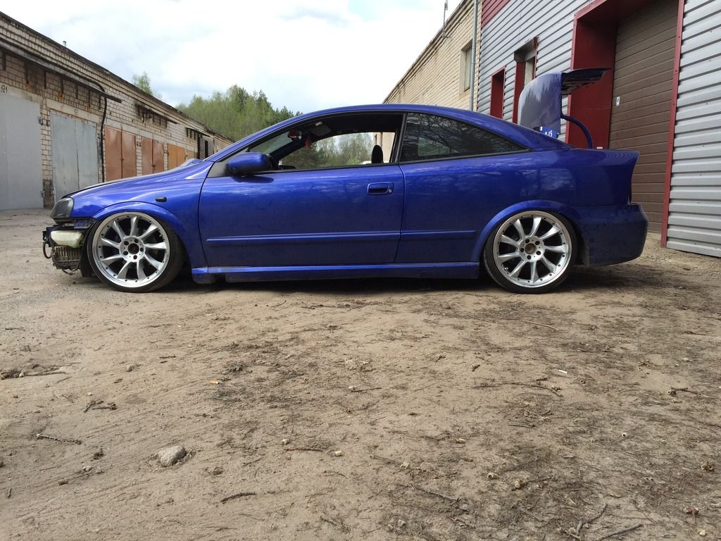

                And some full car shots
                Then the front was leaking very badly, so removed the bags to reseal them.
                And then everything was ok, but the front end is now sitting too high. Someday i will remove the coilvoers again and make it lower by 1 - 1,5 centimeter.

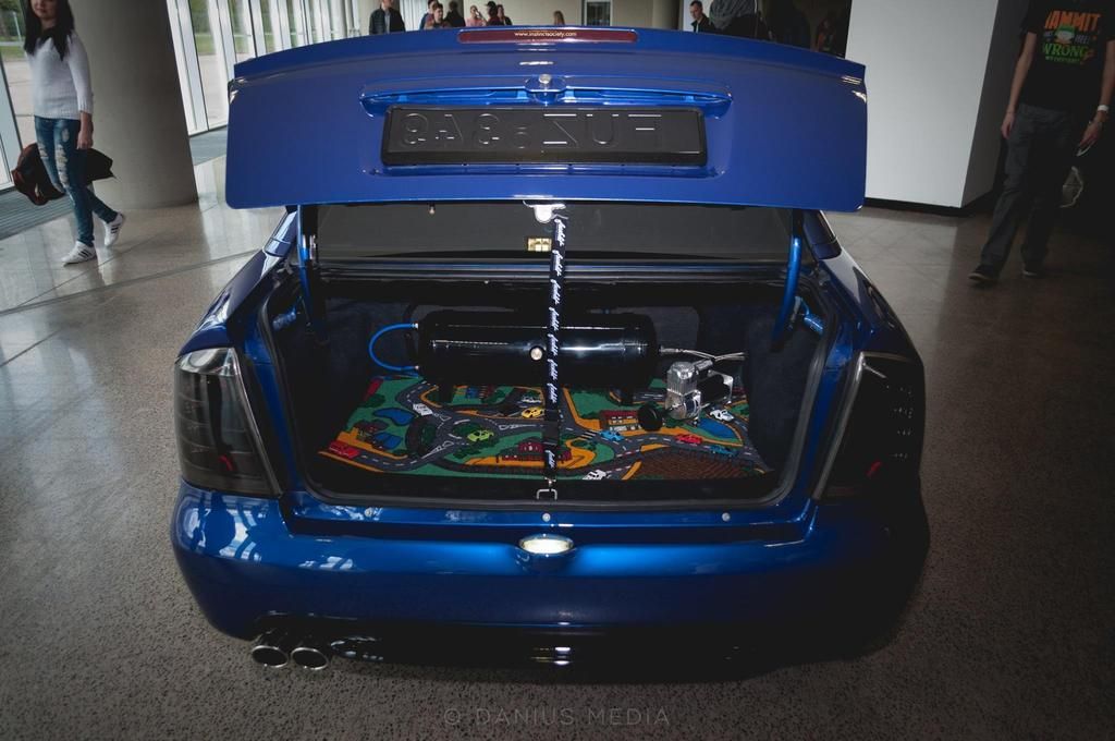

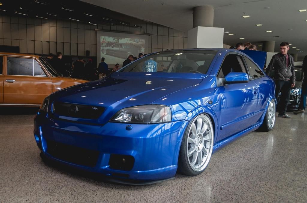

                And then on the weekend, attended at freshfit season opening event.
                So in short:
                Season is opened! Started this season with modified rear bumper with M-Tech diffusor, custom exhaust, airride kit from airridesystem, Lorinser LM6 wheels and kind of funny trunk interior.
