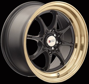

    Here's a teaser of the wheels I got:

    Wheels i'm thinking of:
    1st choice:
    2nd choice:

      Always loved omnis ever since i first seen a picture of one. Choice 1 for wheels is for sure better imo. This should be good!!!
        I was thinking of those or these:
        These are more around my budget.
