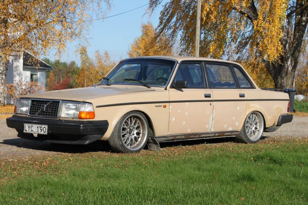

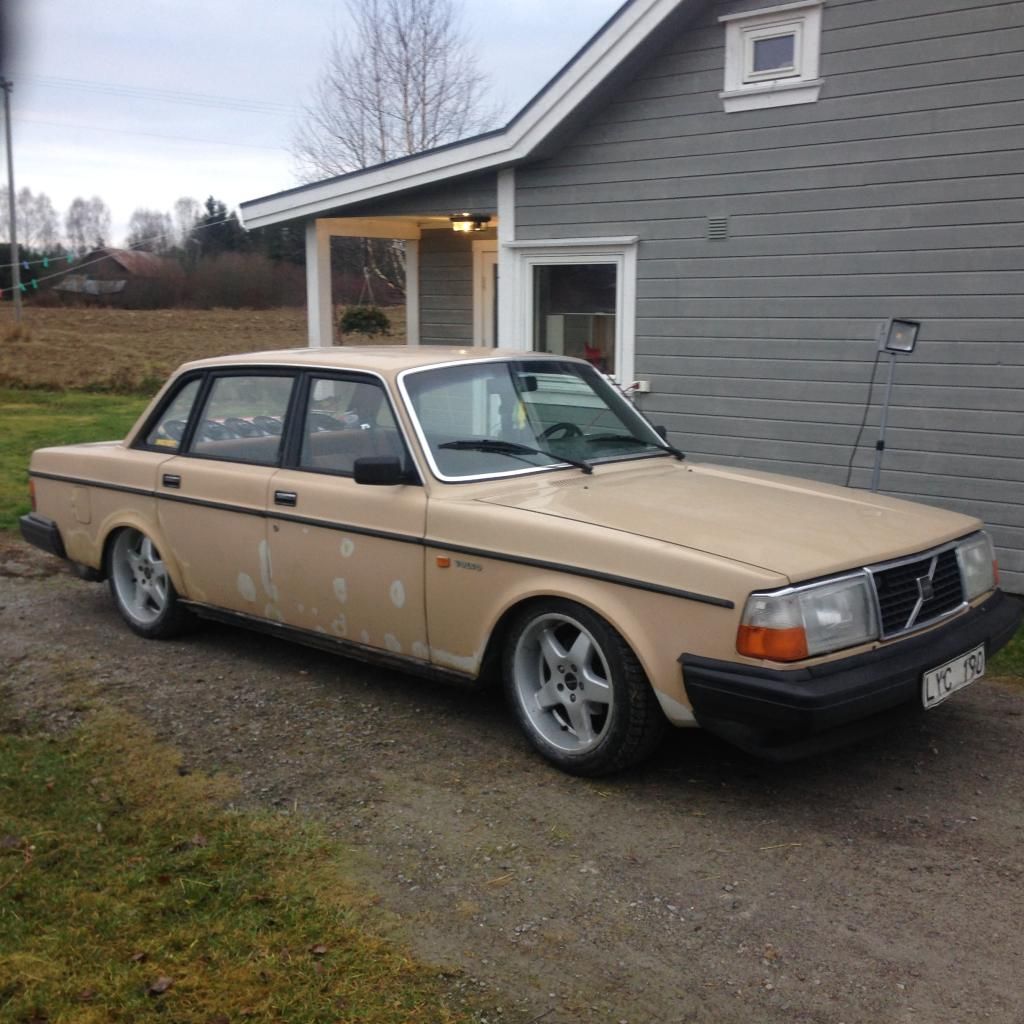

    going to post some pictures and stuff about my daily ride, bought it for 4000 Sek, thats about 500 Usd, so yeah, not a huge investment, but it runs good and is in quite good technical shape, to be a 1984, B21a, pure carburator madness, 100 wild Hp, and a 4 speed.
    sadly i have no pictures of it before i lowered it, because i was so ashamed of how it looked 30 feet high in the air with 14" rusted steelies.
    but here are som pictures of how it was looking this summer, with 17x8,5 bmw y rondell rims, and 205/40

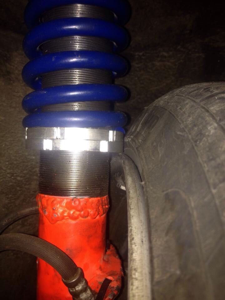

    i built coilovers for it myself, the one you can buy for these cars are extremely expensive, and you cant really lower it that much.
    i used some original struts, and shocks from saab 900 NG, they fit perfectly in the struts, but are 3" shorter, so i cut and remover that length from the strut, and welded together, cut off the original seat for the spring, and machined the strut to make the coilover sleeves to fit, and then machined the upper spring seat i got with the sleeves, so that it would fit the saab shocks, the springs i uset was 550lbs 7" i think, worked good
    The Welds look bad, i know
    i Also mounted them with the "quick steer roll correction" parts from Kaplhenke, to make the control arm and wishbone stay in the right angle, while the car is slammed, this part made a huge difference, recommend it!

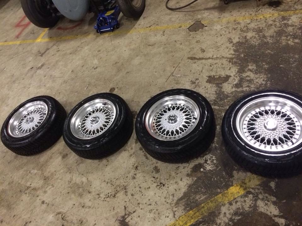

    also, i bought some new wheels, the old owner is going to ship them to me tomorrow i think, they are 3 split 15x7 OZ vega's, with 5x108 bolt pattern, my plan is to rebuild them to 16x9 and 16x10, so if anyone got some tips or know about parts for these wheels, yell out

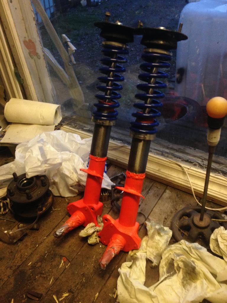

            Read some on some offroad forum for jeep or something, and found out that many of them use 240 rear shocks, and they made a list of shocks that fitted bolt on, and the shortest on that list was front shocks for saab90/99.
            So then i bought some shocks to see, and they were about 1,5-2" shorter than the original
            Here they are all way in
            Saab vs stock
            And fully out
            Saab vs stock

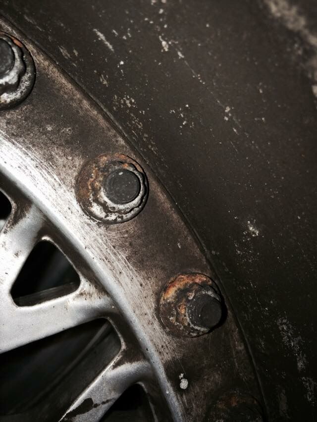

                  need some help, the seller and i aren't really sure if the rims are 2 og 3 split, i have read on some forums that if the centercaps are 2 pieces, they are 3 split, so far it sounds good but, it looks kinda 2 split from inside of the rim, does anyone know, need help with this please, have 2 pictures only from the seller, hope someone knows if they are 3 split or not.
                  i've already asked the seller if he could take of one tire too see but he didn't had the opportunity to do that

                      you're welcome, they come without bushings though, but the original bushing for volvo shocks should fit

                              Got the wheels now, they look good, i have made some small measures, but need to get the tires off soon so i can start working on them👍
                              I measured the diameter from one bolt hole to another across, and it was 12" ca, not a presise measurement but, ill do that later, so then the senter is 30 hole, and 12" +- 1/2" does anyone know what lips and barrels couls fit theese then?😊
