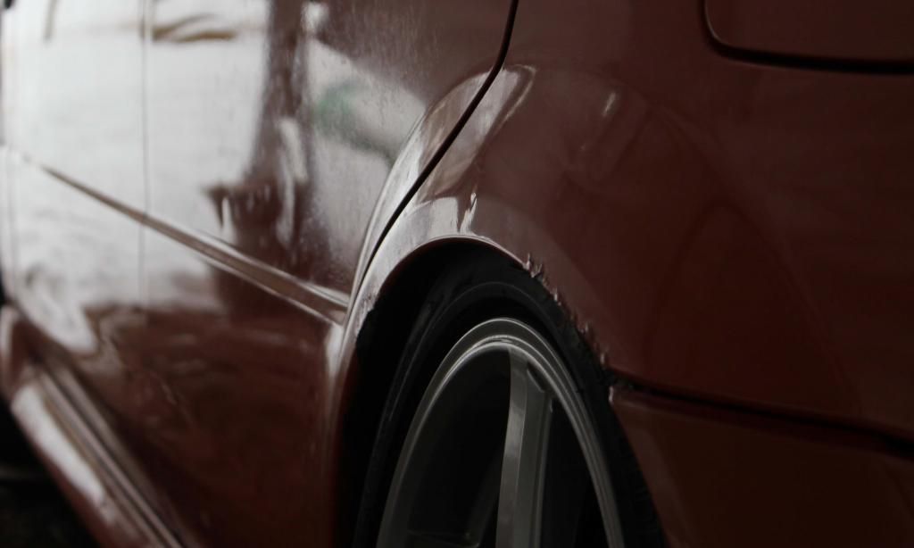

    So spring of 2013 I spent two months doing research then trial and error to learn some semi questionable body and paint work. When I wasn’t at work I was under the car, grinded down all the rust I could find, most of which was fortunately just on the surface, and sealed/repainted the subframes, ¾ of the underbody, and some spots in the engine bay.
    Blending the fender arch repair was definitely the most intimidating part of the plan. I wanted to blend in the smallest area possible, but at that point I had never blended anything, or even painted more than a lip. It’s difficult being a perfectionist and a beginner.
    Not really great work, but I had to start somewhere. Blending was fkn intense, so much trial and error. I almost lost my mind out there lol. But in the end I managed to keep the color fade close enough to the arch line that it tricks the eye.
    I was quite proud of myself at the time. Felt so good to finally wash, clay, and detail the paint.
    I don't really have any good in-progress shots of the fender work but here's a before/after

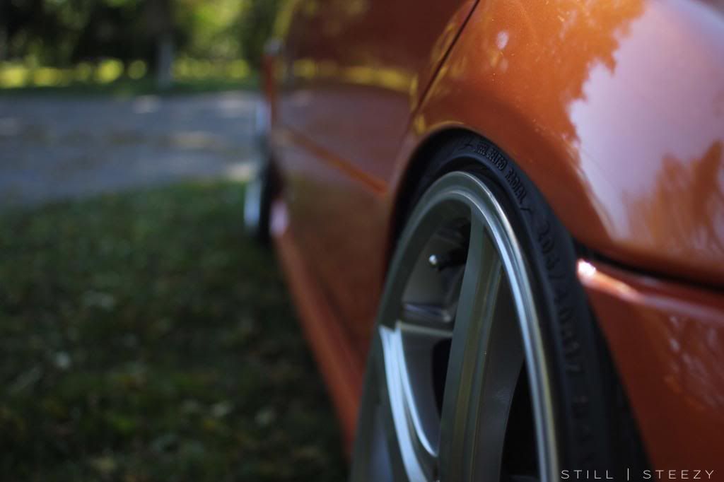

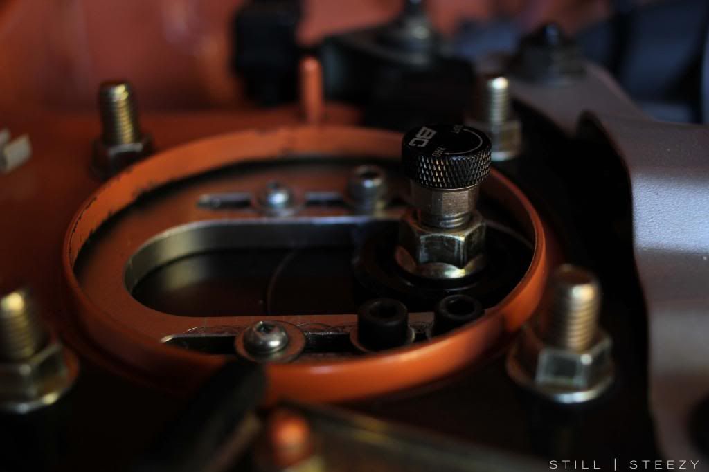

    The winter before the restoration was spend collecting parts so while I had the car up I started installing things.. Harder springs, Ksport rear camber plates with custom spring perches, and Megan Racing lower lateral links for more adjustability. Among a bunch of little upgrades and deletes; Split Second air/fuel controller, a custom air box and a HKS filter, air ram, bronze oil shifter bushings, Nyloil Shift-tranny brace bushings, and one step colder NGK plugs. StopTech slotted rotors and Hawk HPS pads. The SMIC was upgraded, and later I added a modified aluminum intake and hot pipe, with 1” bypass tubes and the Boost Sciences RDV to kill compression surge.
    The interior got some attention too; pos Grip Royal on an NRG adaptor with self fabricated steering wheel spacer, and turn signal “engage-r.” Covering that is a custom bezel which contains the homemade horn connector, and is wrapped to match the wiper arm delete. Behind all that is a rare dual gauge surround holding a boost gauge and AEM wideband. All the removable window control, lock bezels, shifter/cup holder area etc were wrapped in Avery gunmetal vinyl. The dash center piece got the same treatment but with the outer strips as "brushed metal" vinyl covered in custom printed tint. The handbrake handle was adapted for a leather “wrap” and I had perforated leather shift boot made with orange stitching to (sorta) match the seats.

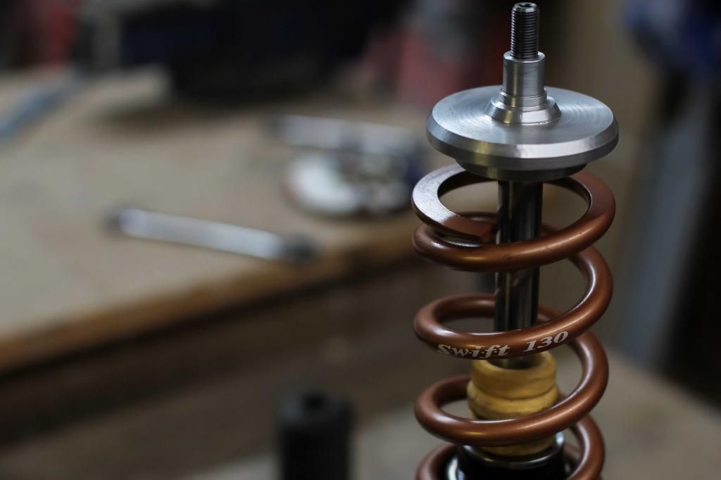

    2013 was spent being relatively functional, looking sunk and somewhat oem+, still on the fence about doing my own thing. But last summer I moved on, retrofitted and refinished headlights. The BC coilovers now contain 152 mm Swift Springs rated at 11 / 13 kg/mm. Lathe turned fog deletes that induct air to the air box. Custom side sills and rear spats. More paint work, rear bumper, front pass fender, badge deletes, and a shaved hood.

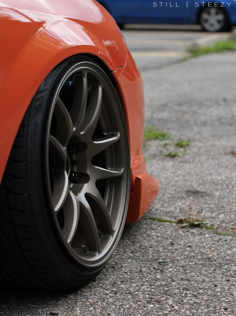

    The CR kai's are 17x9 et17 accompanied by 215/35 Fk452’s. The wheels actually came straight from japan to me, and took their sweet fkn time, but I ended up getting a nice deal because they weren't the color I ordered. I don’t really dislike the bronze but I’ll probably get them powder coated in the spring.

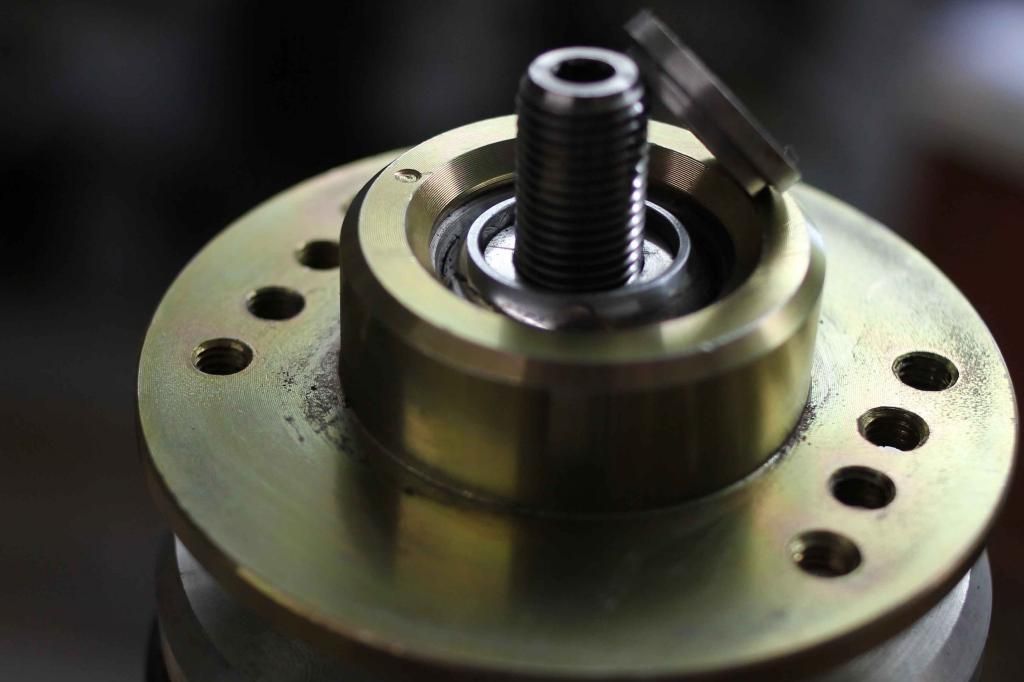

    Thanks to my father for having sweet tools, and letting me use them, I have lathe turned aluminum rear spring perches, and pillow ball washers. Fly slotted front and rear camber plates for more angle. And a bunch of little stuff like the interior bezels or clear poly dust covers for the camber plates.

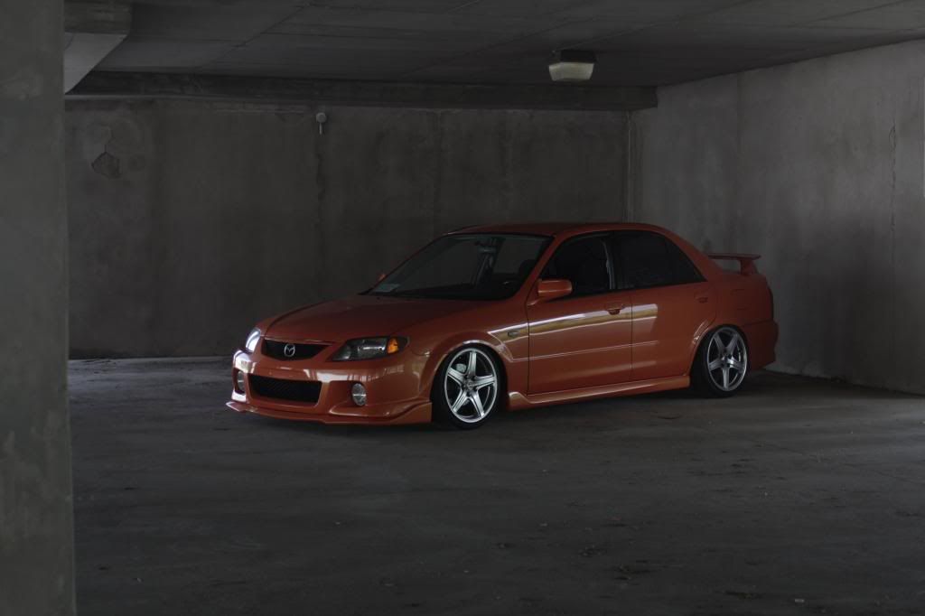

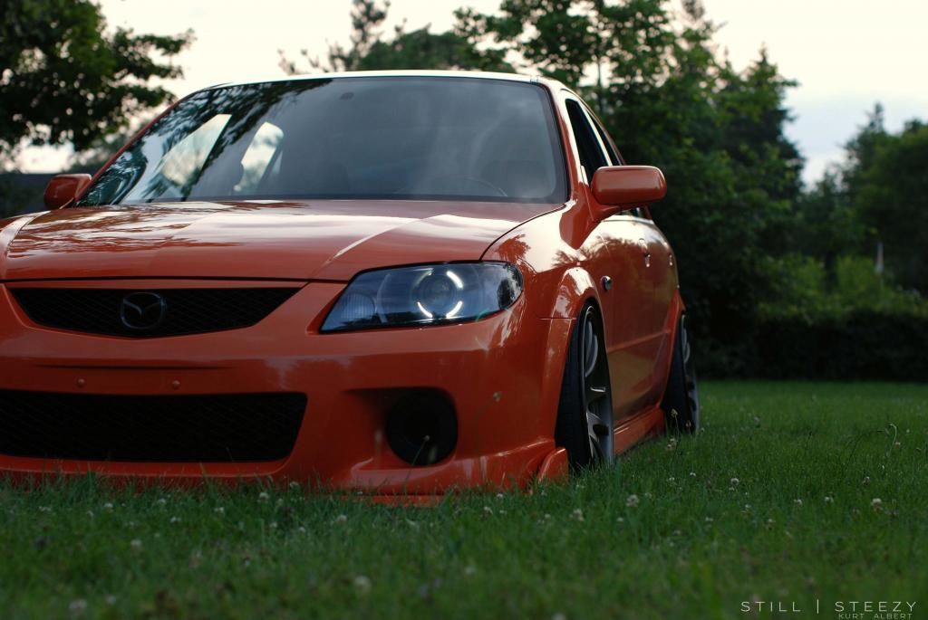

    And this is how she sits as of now.

              You have any pictures taken while machining your custom pieces? Love to see some of the detail that went into them.
                          Thanks man, glad that showed a bit in my writing. I don't really have much in the way of detailed documentation. But I'm working on a lil video edit at the moment that shows bits of that.
