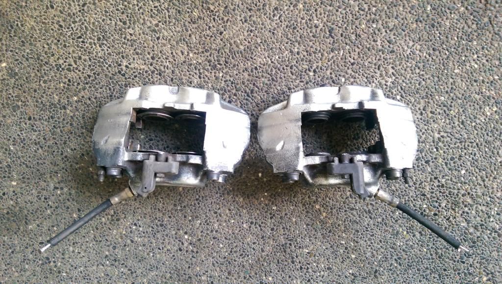

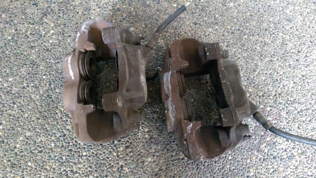

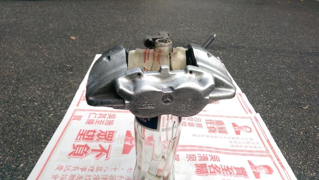

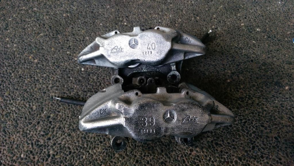

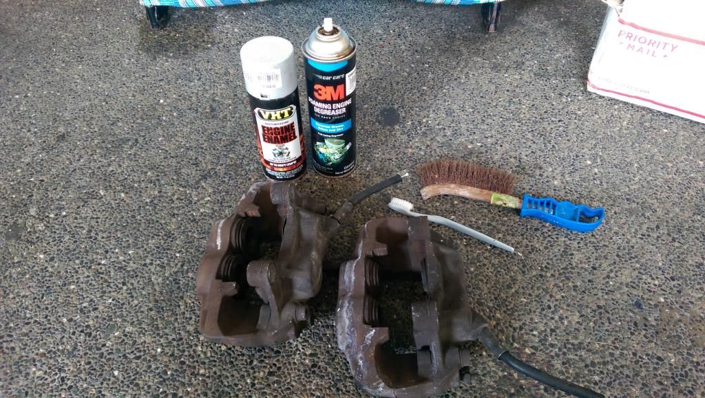

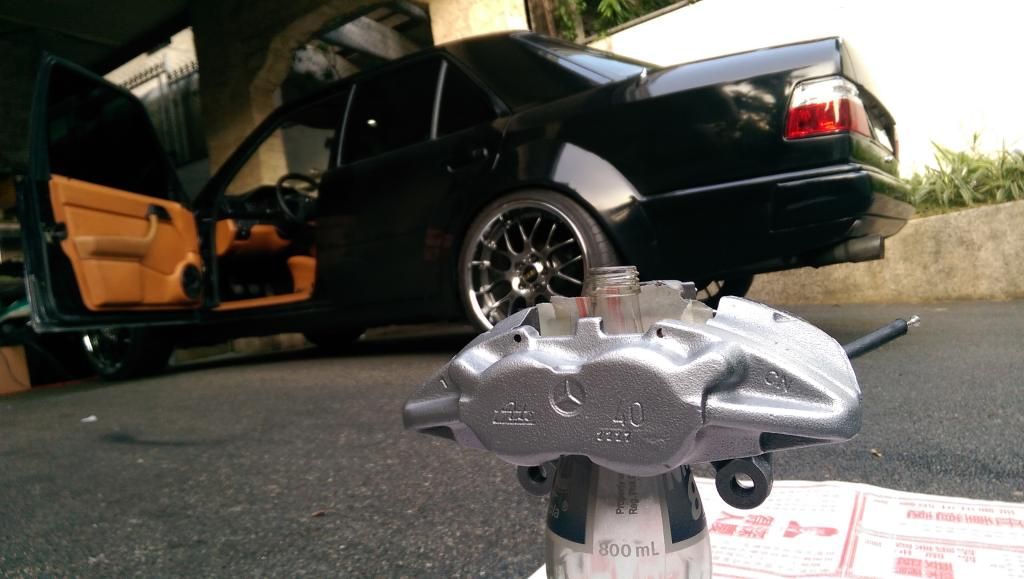

    Anyways, these are 4pot calipers which came from a 400e and should be a direct bolt on to my 260e. Only things I will need are proper sized rotors(12" in diameter I believe, and to adjust the back plate behind the disk because of some clearNce issues.)*
    As for nap, I decieded to give it some cleaning and a fresh layer of paint.*
    I'll be using a wire brush, a tooth rush, engine decreased, and lots of water. Silver VHT paint for these calipers!*
    I started by soaking it in engine decreaser for around 5 minutes and started scrubbing the living hell out of it.came out silver and shimmery Hahahaha*

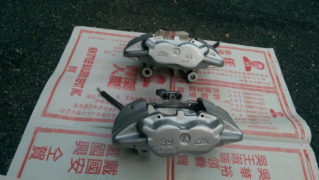

    Then after that it's off to paint! I masked the insides so paint won't go in the pistons (will do a caliper repair kit on it after so make sure it performs like new)
    And then paint!!! It came out looking really nice!! Looks new to me! Haha*

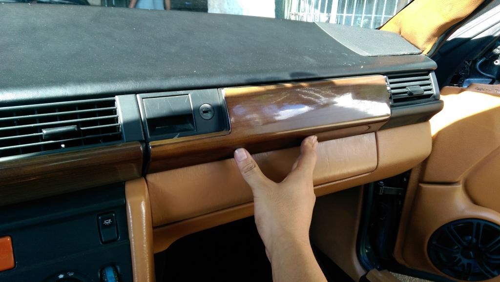

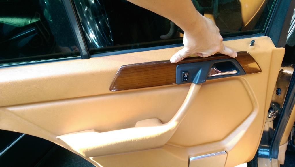

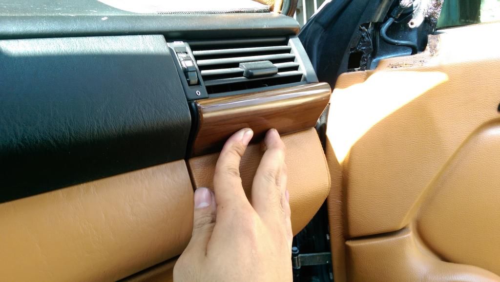

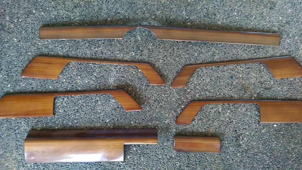

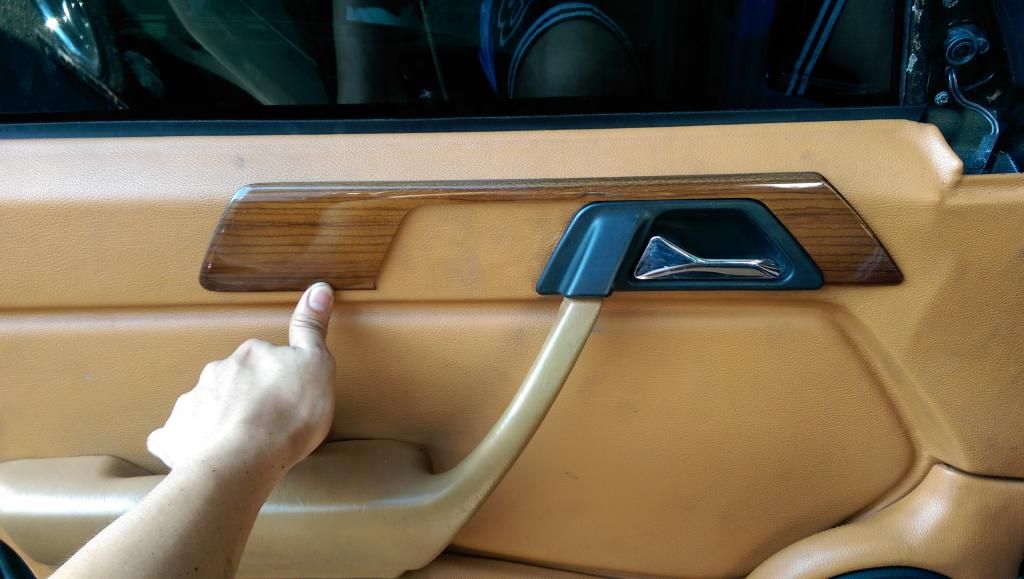

    A few weeks back I was able to buy a set of wooden trims(for higher w124 models) for cheap on ebay and they finally arrived yesterday!*
    I test fitted everything and it went well...*
    Except for the front doors.. Apparently. the ones I got are for the ones with electric seat controls on the door cards. And mine doesn't have those, which leaves a huge empty space in between the wood and the balck plastic thing.*
    Now .. Here's what I'm planning to do. I plan on cutting the wood trim and make it fit and connect it again. It should look okay after!*
    I was initially going to go with the oem wood color but it just doesn't blend well with the tan interior. it looks kinda goofy IMO. )*

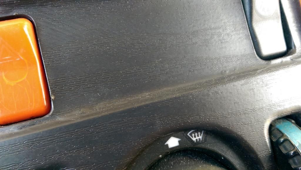

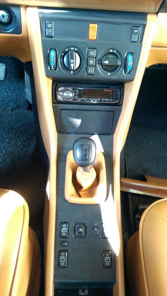

    so my plan is to wrap everything in black wood vinyl what I did with my center console:*
    And then apply a thin layer of resin and clear cost to somehow make it look like real wood that is laminated. It shod look good with the color scheme of my Interior(I hope)*

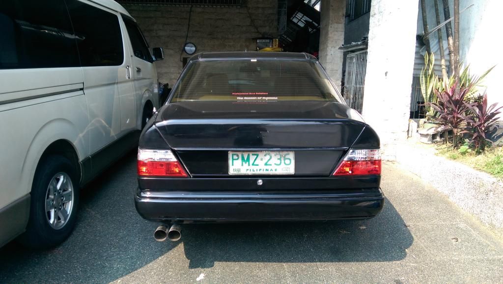

    I think amber corners, particularly on a pre-facelift. I don't know what the situation is over there, but the Euro models have a darker amber corner than the North American ones, which are very orange. I think the Euro-spec ones would be lovely.
    I almost think I'd like to see the Mercedes star reappear on the trunk lid. Seems like something's missing back there.
    Nevertheless, dramatic improvement. Now get. that. shit. low.
    Thank you Sam! I appreciate it! I'm definitely getting Amber corner lights. Just having trouble looking for some haha. These items are like gold here in the Philippines. Very rare!
    I'm also looking for a proper Mercedes star badge for the trunk as the one I had before was incorrect and was too big. that's the only emblem I'm leaving there
