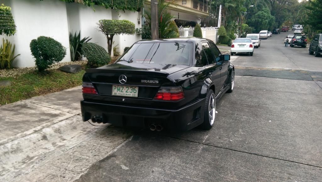

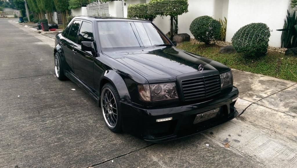

Thanks man. The wheel arches were made using some illustration board and expandable roam. that's where I curbed our the shape and based it on the original one. They're not perfect but, close enough. HahaOriginally posted by TeckniX View Postpretty cool project and I respect the DIY body kit - how did you keep all wheel arches with similar curves? Also how did you make your side-skirts?

The side skirts we're made using my friend's mold. I think it's a replica of one of the benz's side skirt. Not sure what model exactly.

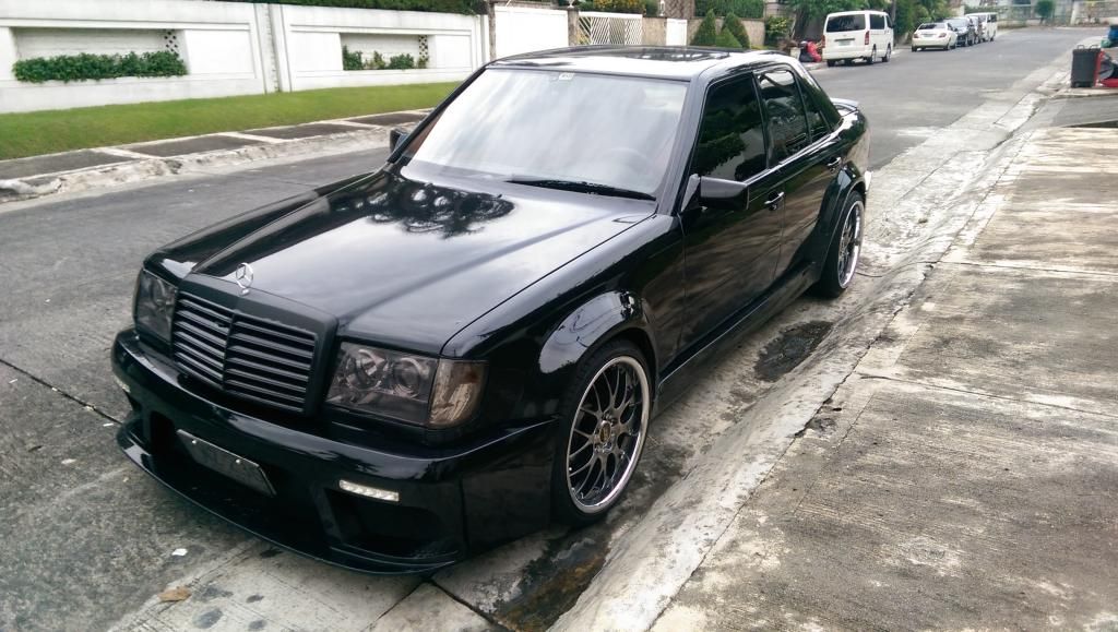

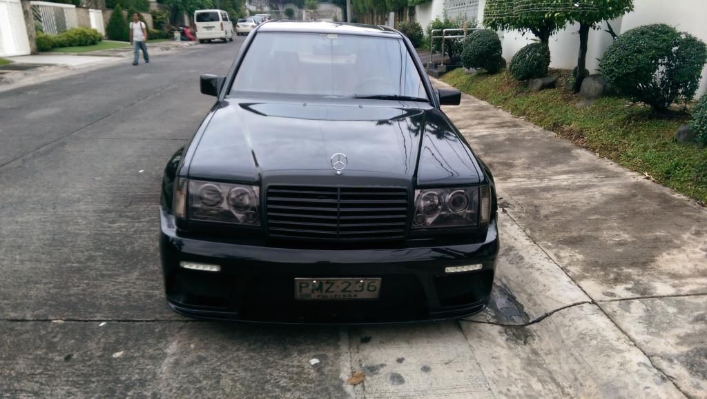

Replaced my headlights with a different kind of projectors. I like it better than the older ones I had. Then I applied light smoke film to darken it a little bit. I'm going for the dark murdered out look.

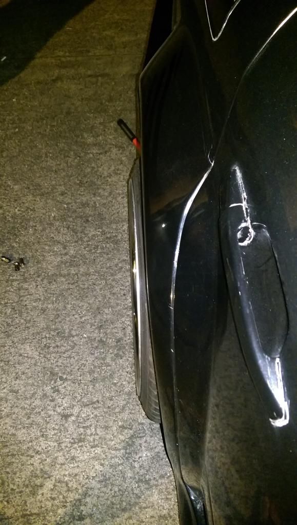

And I also added a 5mm spacer at the rear to bring out the wheels a little more. Exactly what i was looking for. (still cant find wider wheels. its hard to find wheels like this in the philippines - wheel that are wide and cheap) hahaha

I think you should change the headlights back to the OEM, wider wheels and more low. Other than that this car really looks good for a homemade body kit! Keep up the good work.
Thank you! About the headlights, I respect your opinion, but i just really like the look of the projectors on this car. Gives it a modern touch. I just want to make it look a little bit sporty (although i know the 260E isnt sporty at all) If the future I plan on getting a 400E or a 500E and I plan on keeping that bone stock or OEM.
