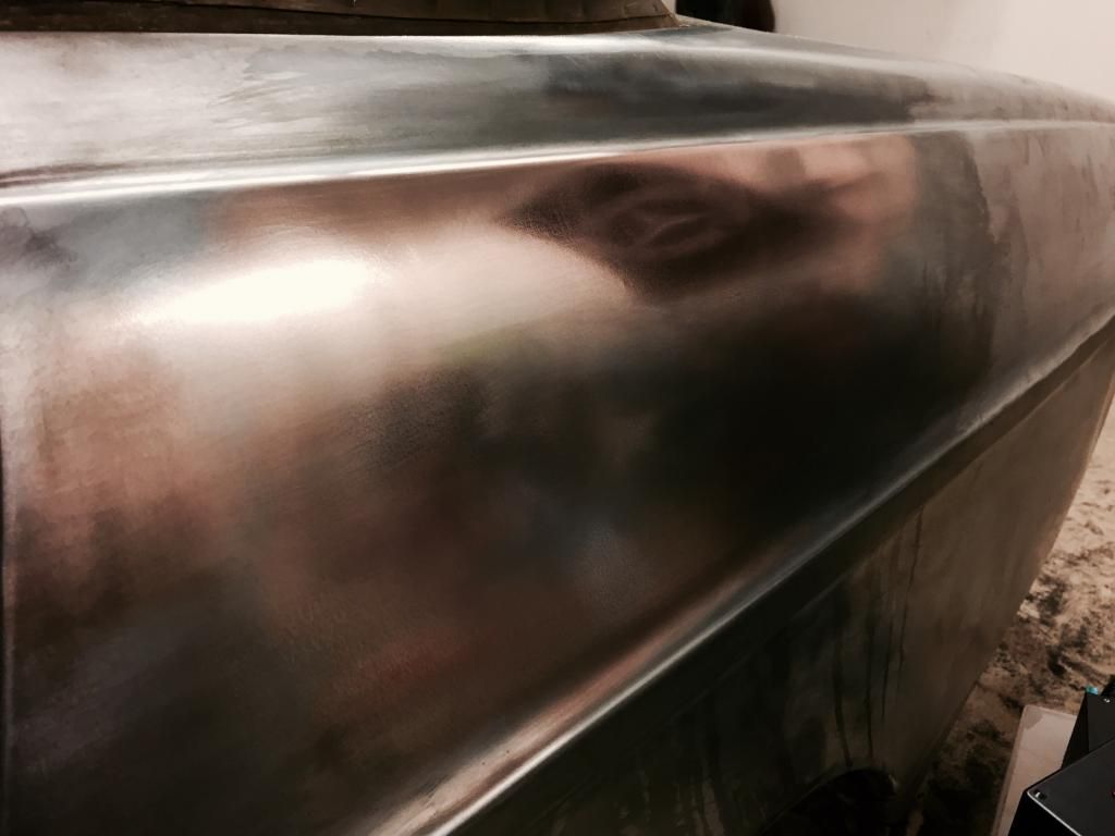

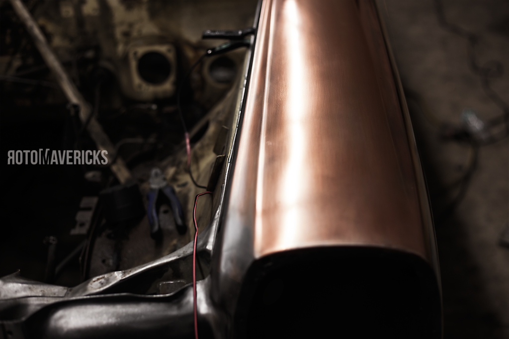

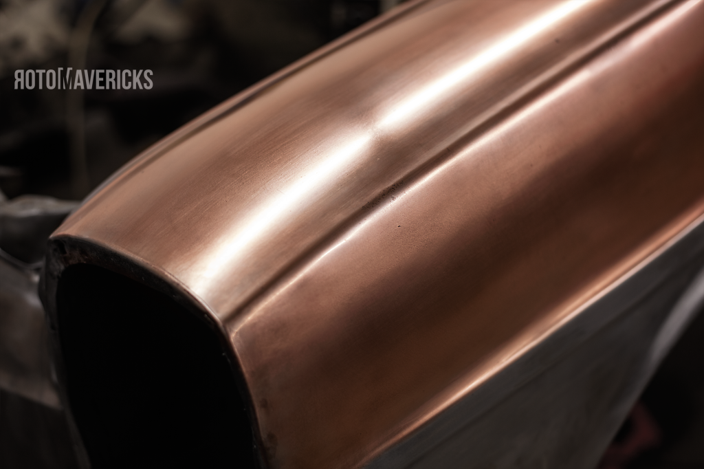

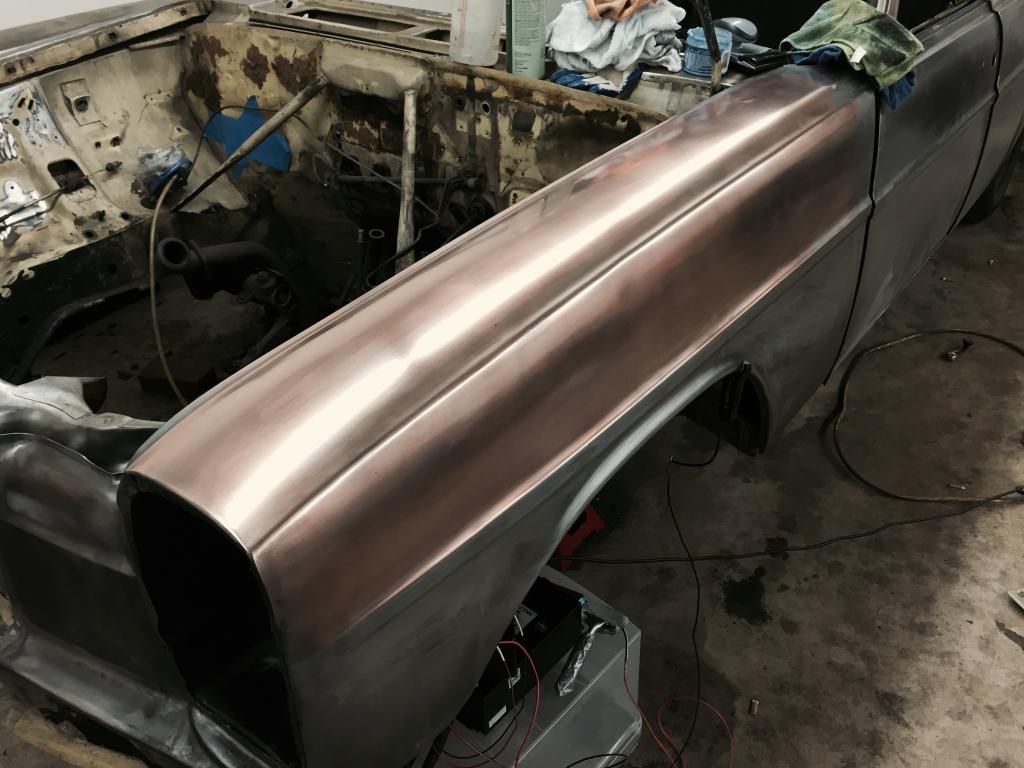

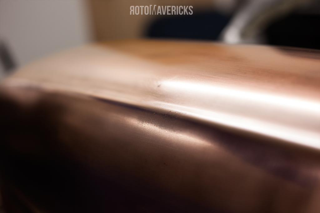

And so the real fun begins. I got everything hooked up and did a few test areas. The process is pretty quick, just gotta clean the steel really well and make sure there aren't any deep scratches but as long as it's like a satin finish the copper can be wet sanded afterwards and polished to a mirror finish no problem. Thank god because bring steel to a mirror polish on its own is a bitch.

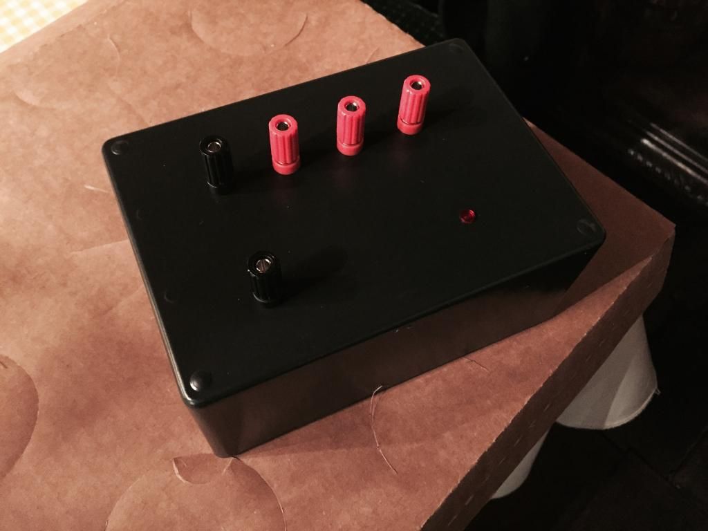

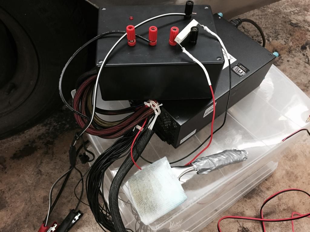

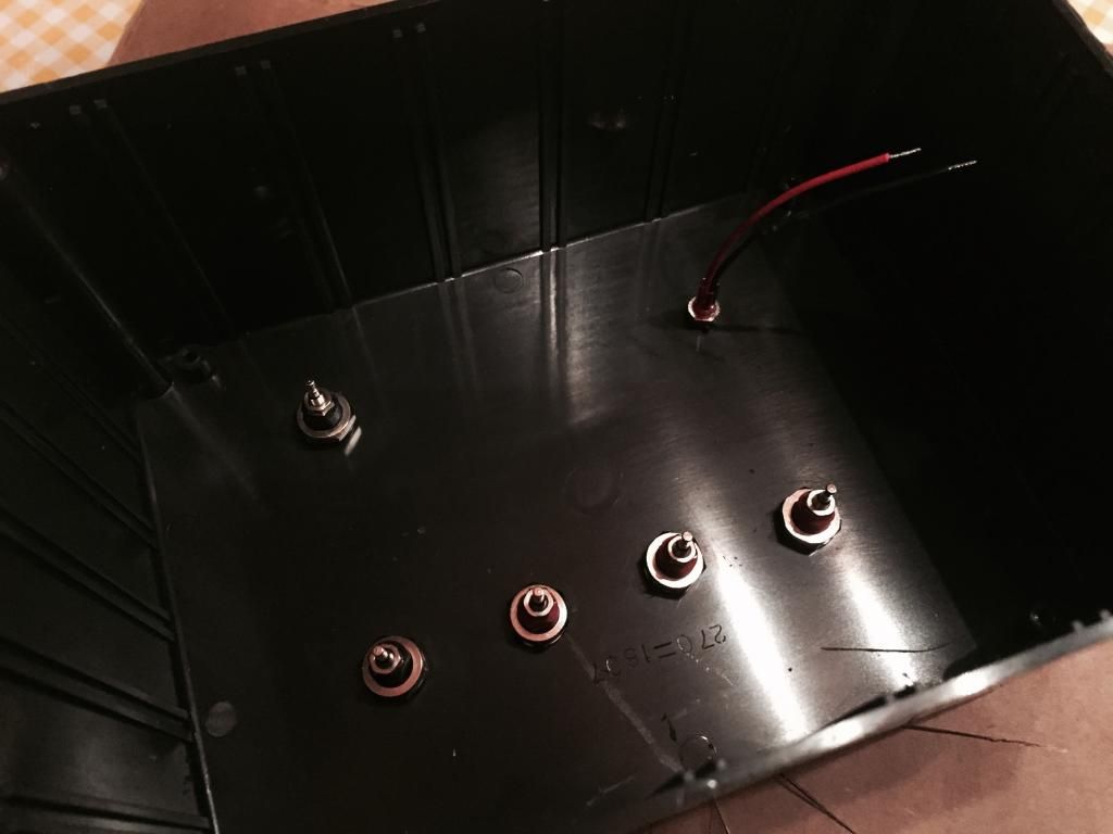

As you can see my power source looks like some sort of bomb. I'm going to be fabricating some better "brushes" to make things easier but other than that everything worked perfectly.
If anyone wants some wheels or anything copper plates let me know. I'd be happy to plate whatever now that I have everything up and running.
Originally posted by TeckniX View Postps I think you can also get 24v from the +12/-12V, if you want to add 1 more, although it'll be at less than 1A
that looks good already, cannot wait to c the polished picsFloccinaucinihilipilification
