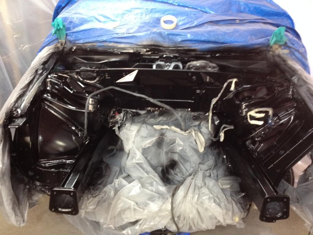

for those who are privy to the b6 ecm tray, i had to cut out and put back the opening where the wires are comign out since they will no longer be heading straight out into the engine bay. rather underneath the battery and come out above transmission
finished body work and primed the bay
polished up the fuel rail and coolant pipe. Thinking of trying the duplicolour copper plate kit on the coolant pipe.
started cleaning up the intake, removing casting lines and smoothing out for paint.
then finally was able to lay paint and clear yesterday. will have to go back and wet sand smooth then I can start reinstalling things
