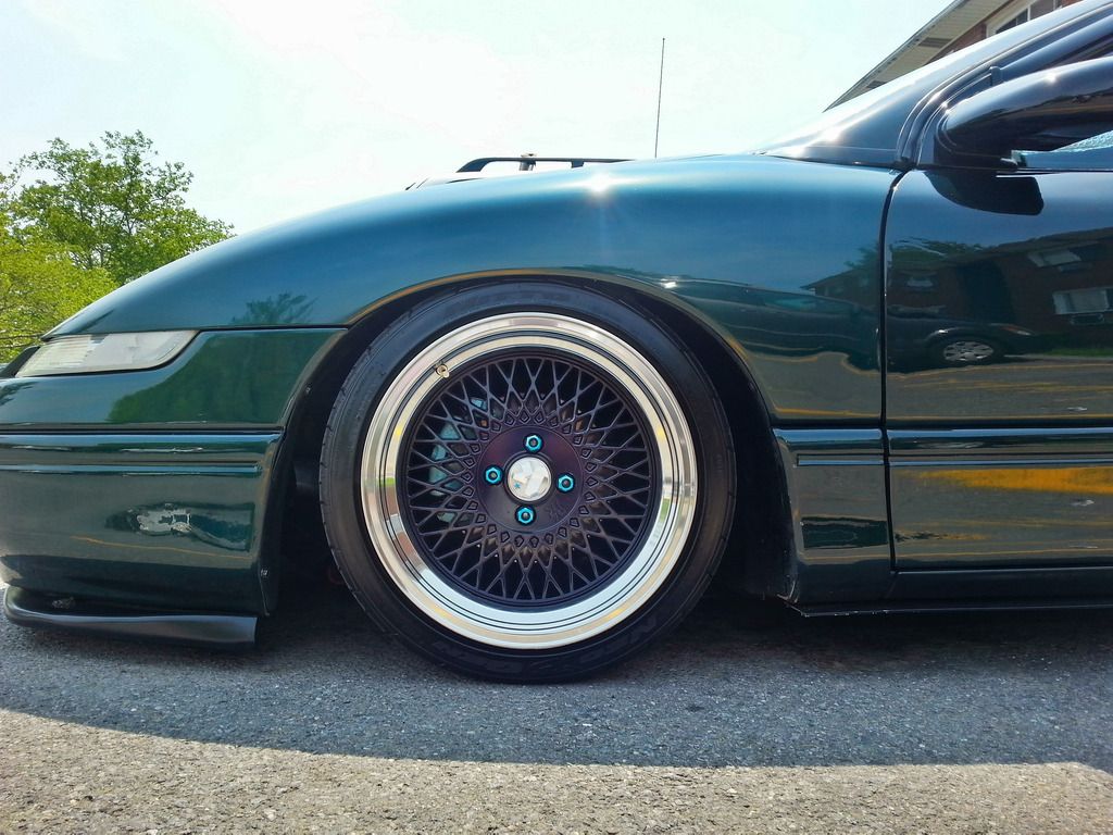

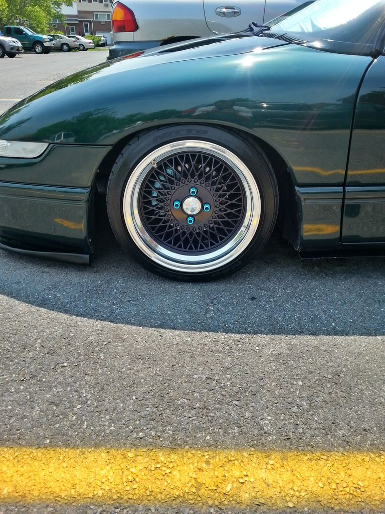

    • Old broken fender.
      New fender, needs some camber adjustment for moar low

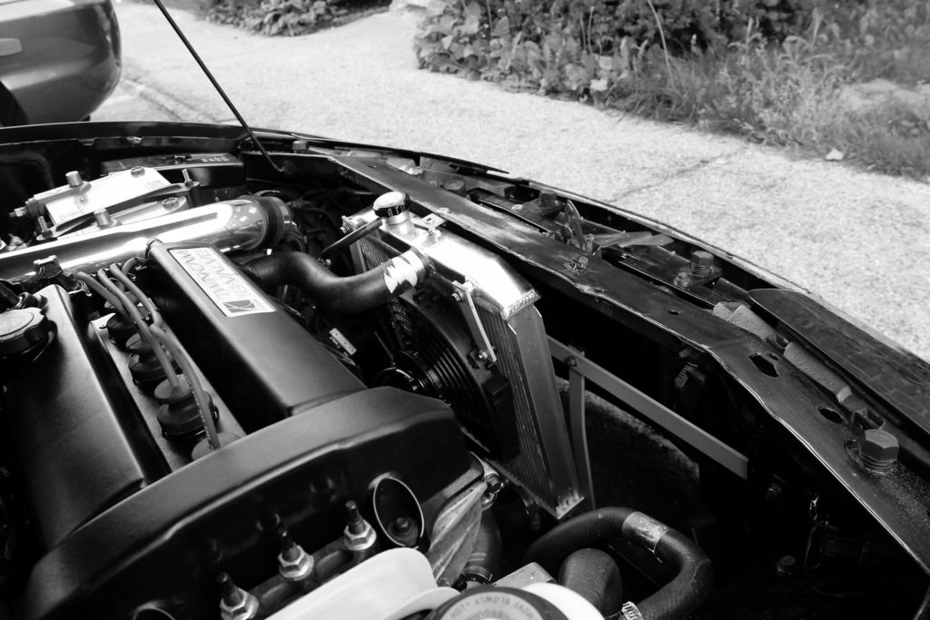

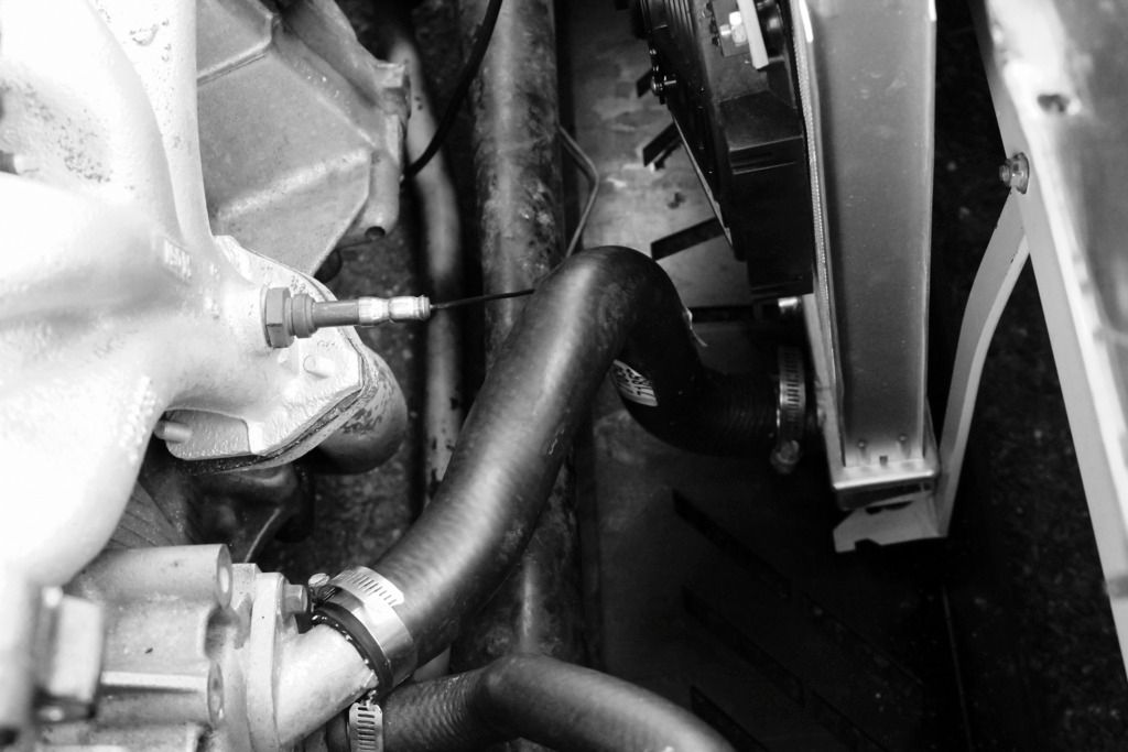

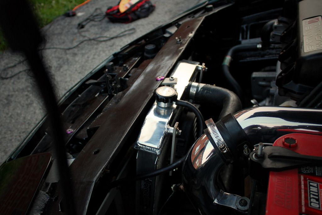

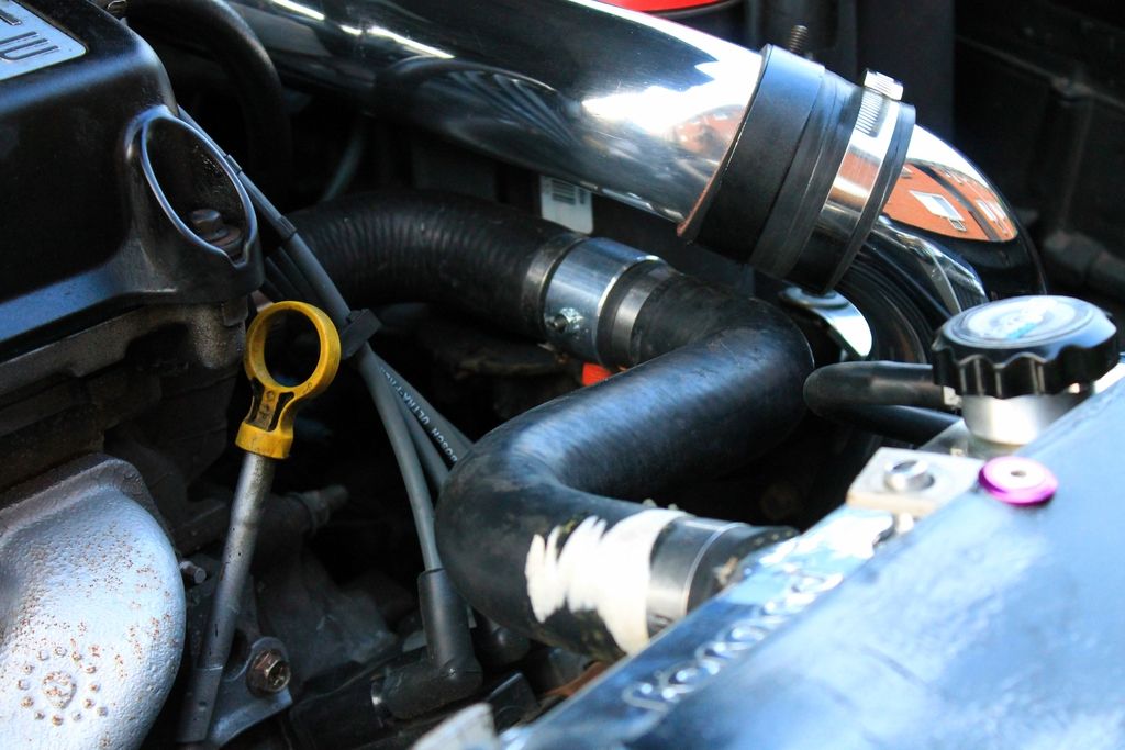

      • Got the new radiator in, its a Forged Racing 2 core aluminum civic half rad w/ 10"slim fan. Next is to just paint the brackets black and get a shroud for the fan. Now that I'm able to control the rad fan with the megasquirt and until I get a shroud, the fan comes on at 204* and shuts off at 195*. When I do get a shroud for it, I'll lower it to on @ 200* and off @ 185*.
        Cruising temps are 186*-190*, going up hills/inclines never goes above 195* so definitely a huge cooling difference. Also when the turbo goes in, there's plenty of space for manifold/turbo/down pipe/wastegate now and without worrying about overheating.
        Also, the upper rad hose is stock modified with a coolant temp sensor tap from autometer for the megasquirt and the lower hose is from an early 90s eclipse, unmodified.
        IG: @simplyclean_sat

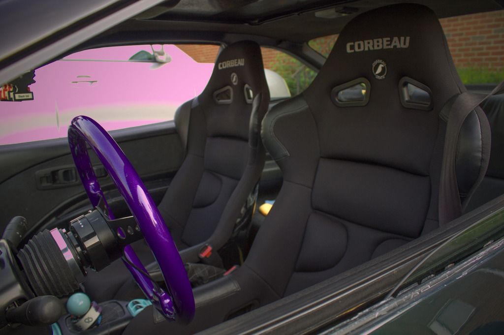

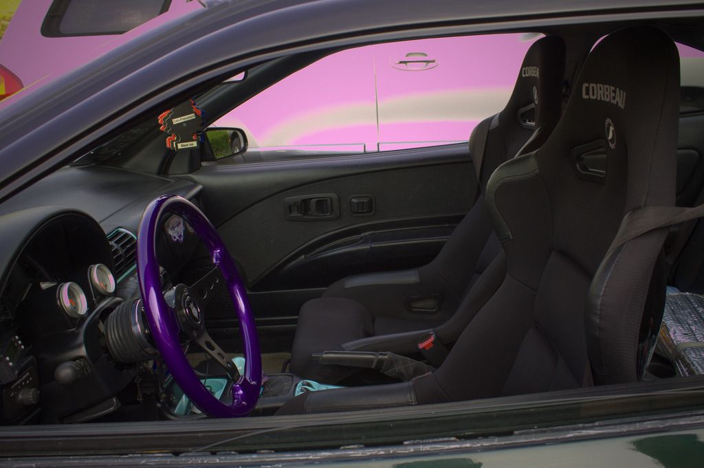

          Sorry for not posting much lately. Recently I have acquired 2 Corbeau seats, NRG 2.0 quick release and started the battery relocation to the trunk. Also painted the engine bay the same green metallic as the car.

                • Thank you guys. I also did a full, true black conversion on the all the interior trim as well that I have to post pics off as well. Then I'll be making cloth inserts for the rear bench to compliment the corbeau seats and also will be getting a 4 point harness and bar and new headliner.

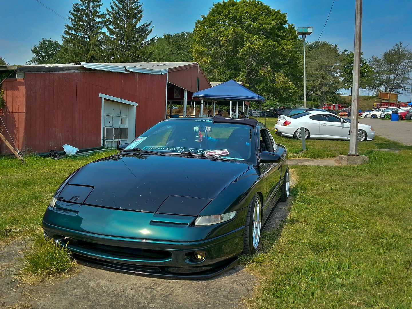

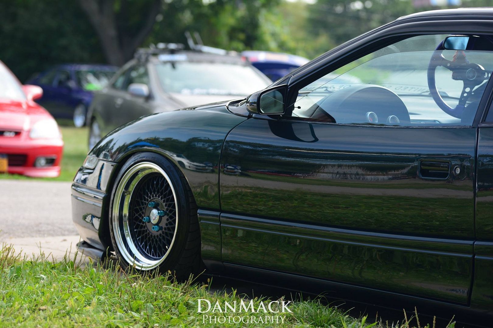

                  • Spotted at the clean culture meet this past weekend

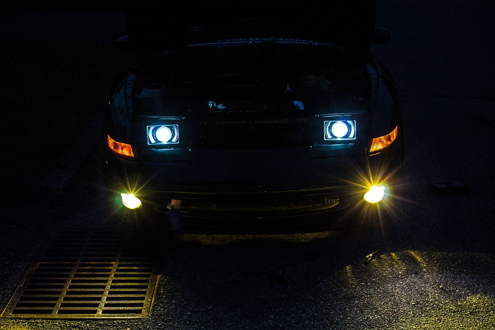

                        • New hid projector for 4x6 headlights with 8000k hid.
