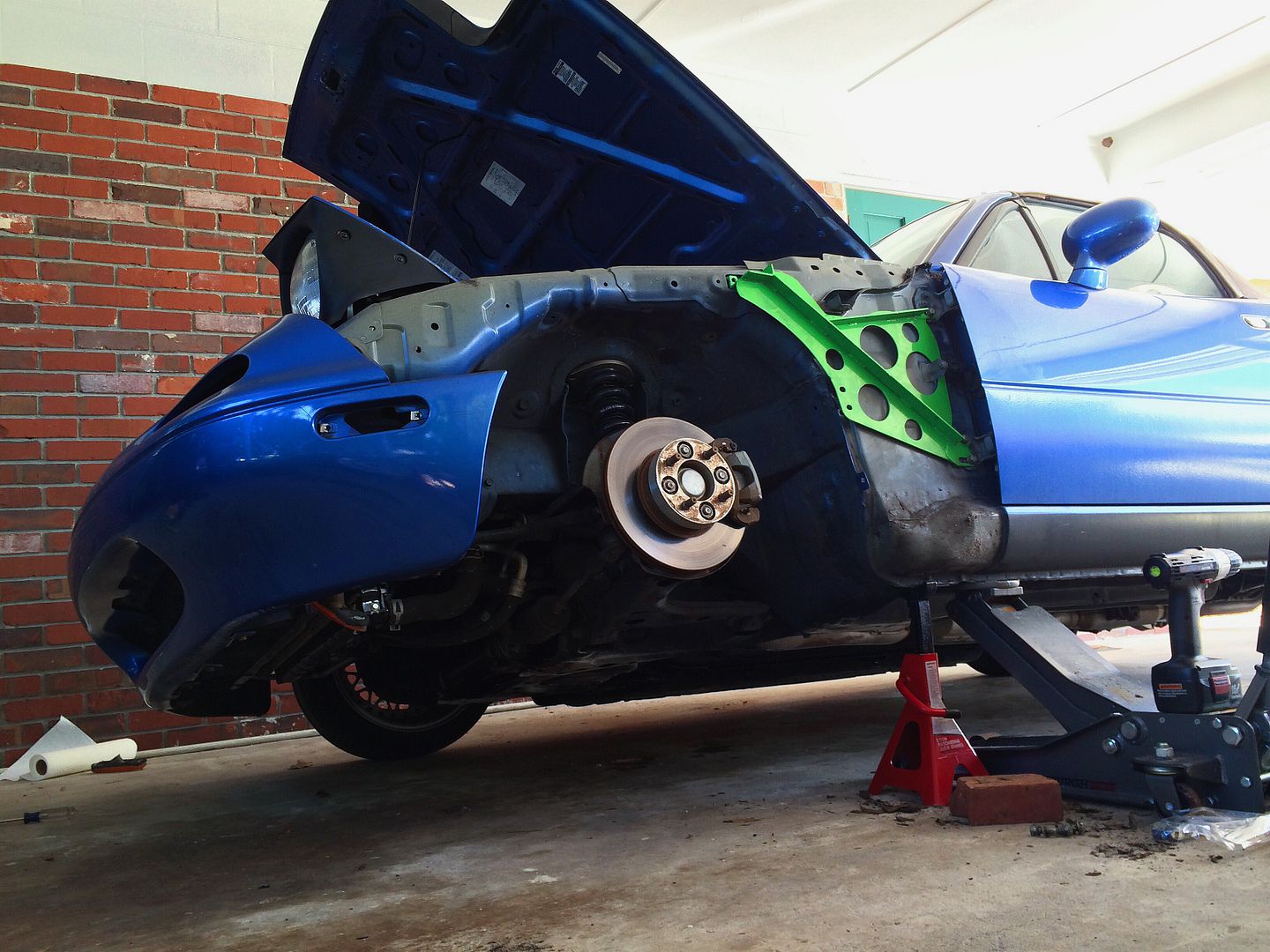

          So more on my fender brace install...

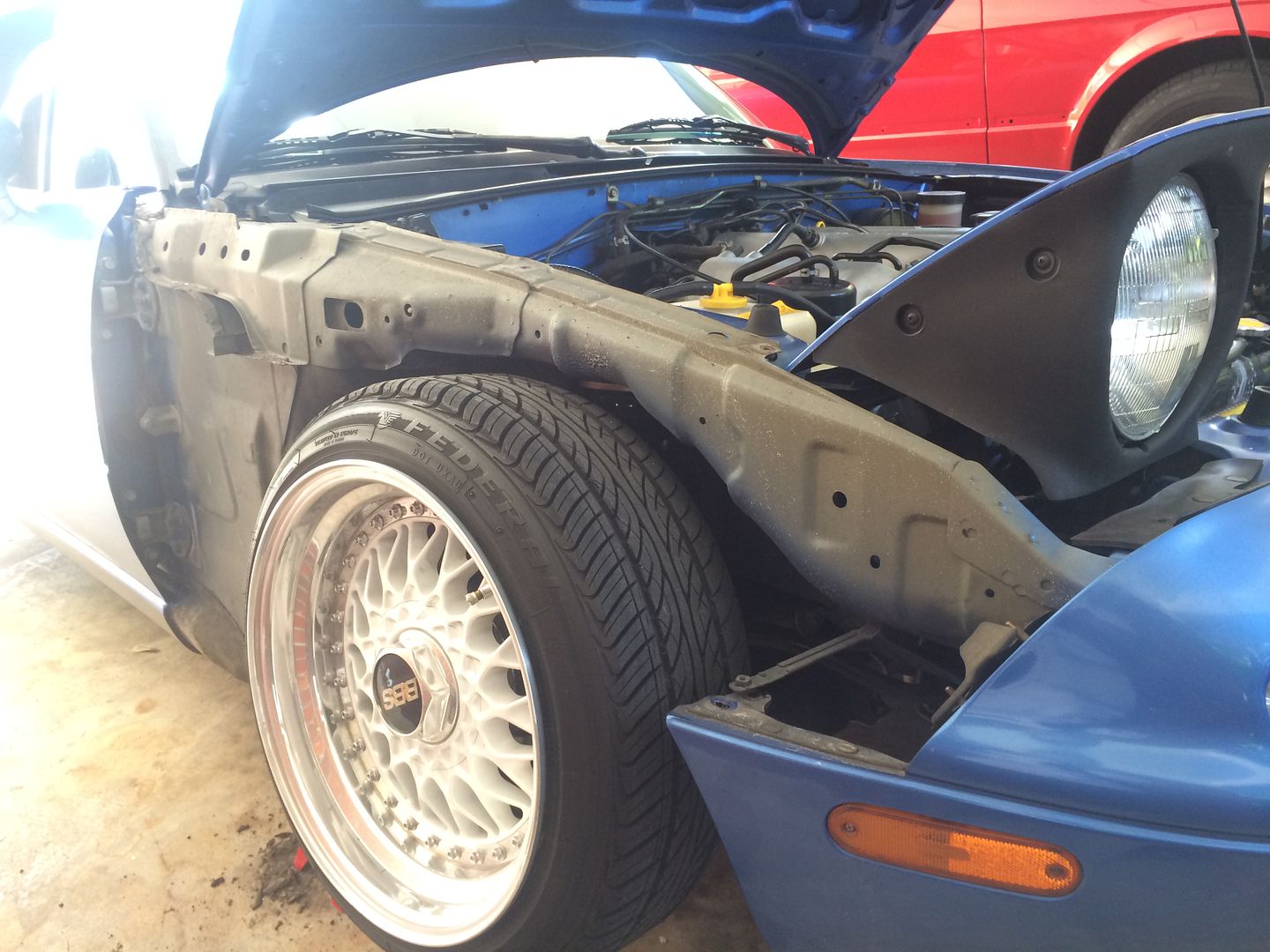

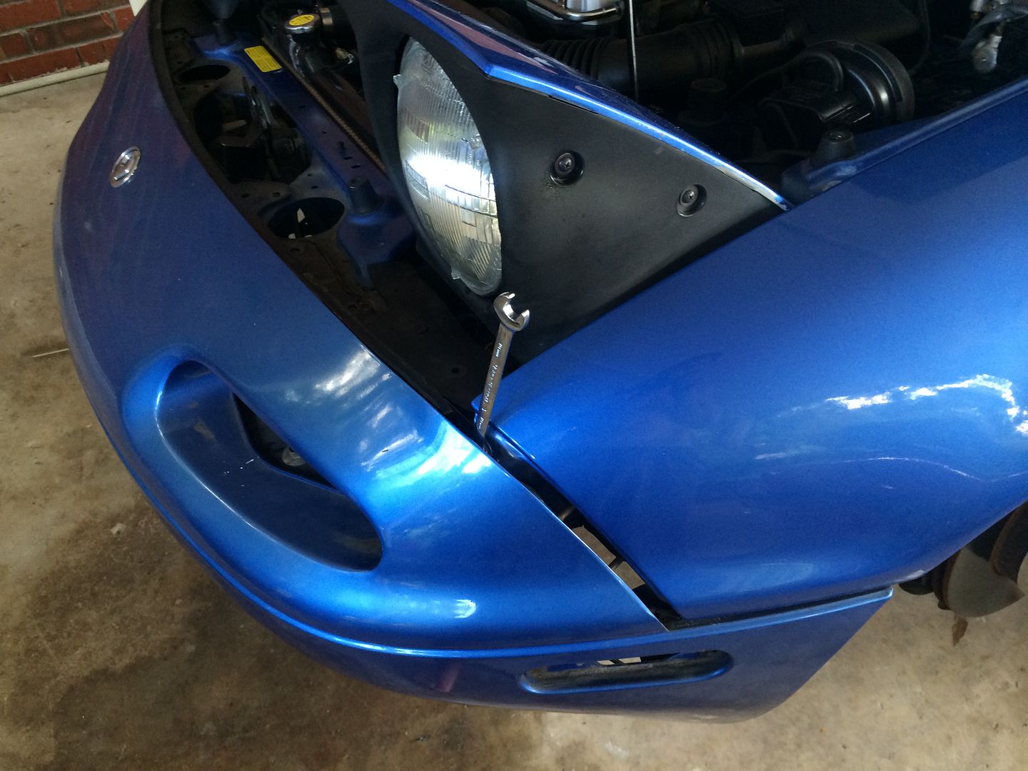

          Turned out to be a bit more confusing than i thought and did a lot of unnecessary work on the first side. In order to get the fender off, you have to take part of the bumper off to get at one bolt,
          Fenders off... dat stance...

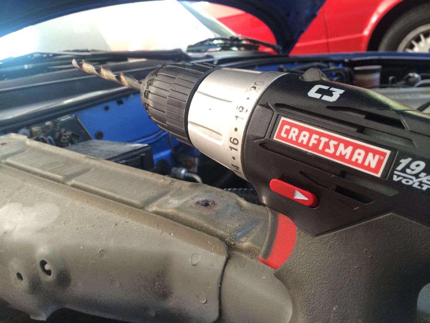

          Had to drill a whole in the inside of the fender there... never done that before so i kinda just went for it with the drill my dad had laying around.

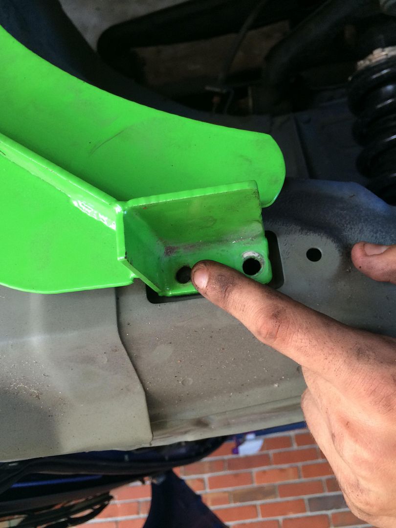

          To fit this in there
          Anyway once its all back together and with both sides on the results are pretty astounding. Everything feels much tighter and solid. Took away a lot of rattles and everything is less harsh, in the way that not as many things move around over bumps. Steering is a lot more direct and has more feeling than normal. which is a lot because this is a miata haha. Anyway, still need to order some freakin lips.
