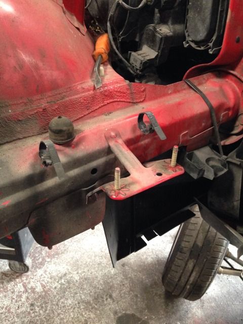

              Old p/s resivoir bracket in the 318i
              This was removed because the s50 has the resivoir mounted on the engine
              Removed and ground back:
              The new position for the abs pump bracket was cleaned ready for welding
              It was then TIG'd in place. I measured that it was exactly two fingers from the turret on the other shell so using my precise measurements it now sits roughly where it should be.
              Didn't take pictures at the next stage but I bolted the pump to this bracket and put the other support bracket in place. The second bracket was then tacked in place, the pump removed and some runs of weld put on.
              I was really under pressure for time so I bought paint in Halfords which wasn't a perfect match but will look fine because it's going to be covered by the coolant bottle, abs pump and charcoal canister.
