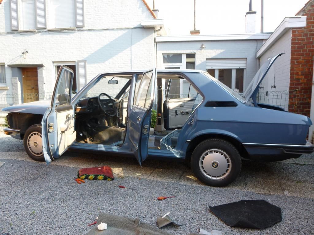

    Well, it is a BMW E12 520/6 cylinders, first registration was in january 1980, now it has about 166 xxx km.

    Some pictures of the E12 when I bought it.

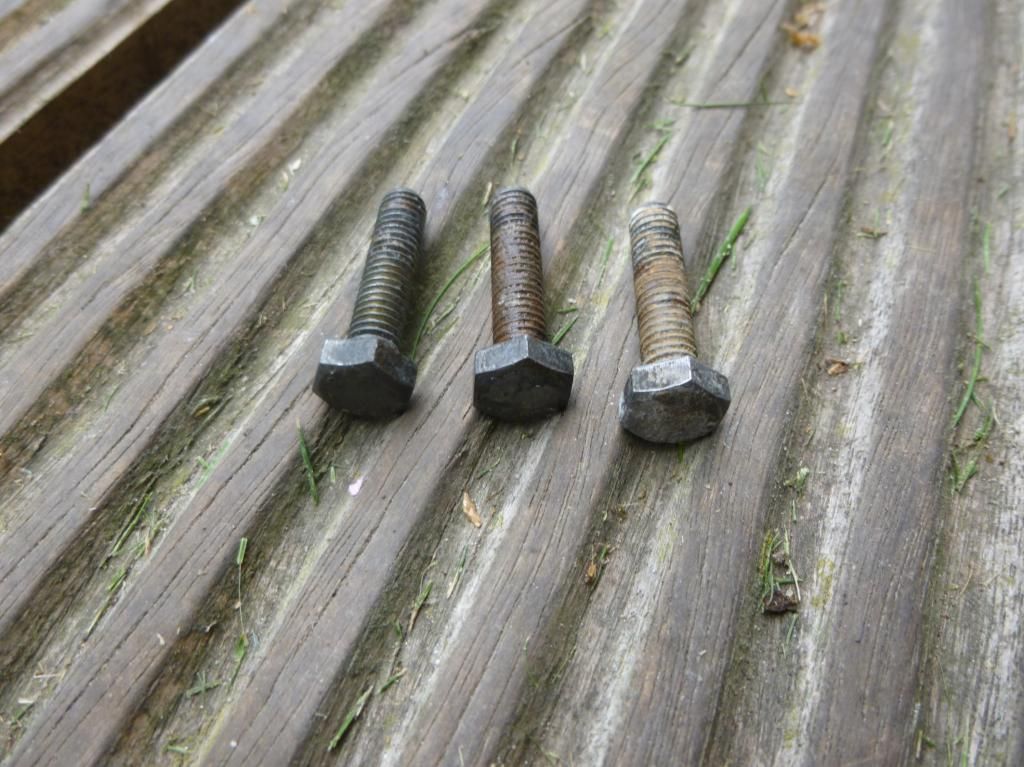

    Thermostat also taked off
    Bolts polished
    New cover (painted) and bolt because the old bolt was stucked in the cover

    Now the engine didn't fall out I started to strip the car
