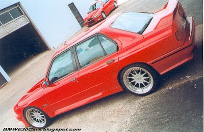

      You should convert this into an E30 M3 sedan
        It's beautiful, but my sedan is not a M3, so i don't want M3 body kit
        Only few mtech parts, not more
