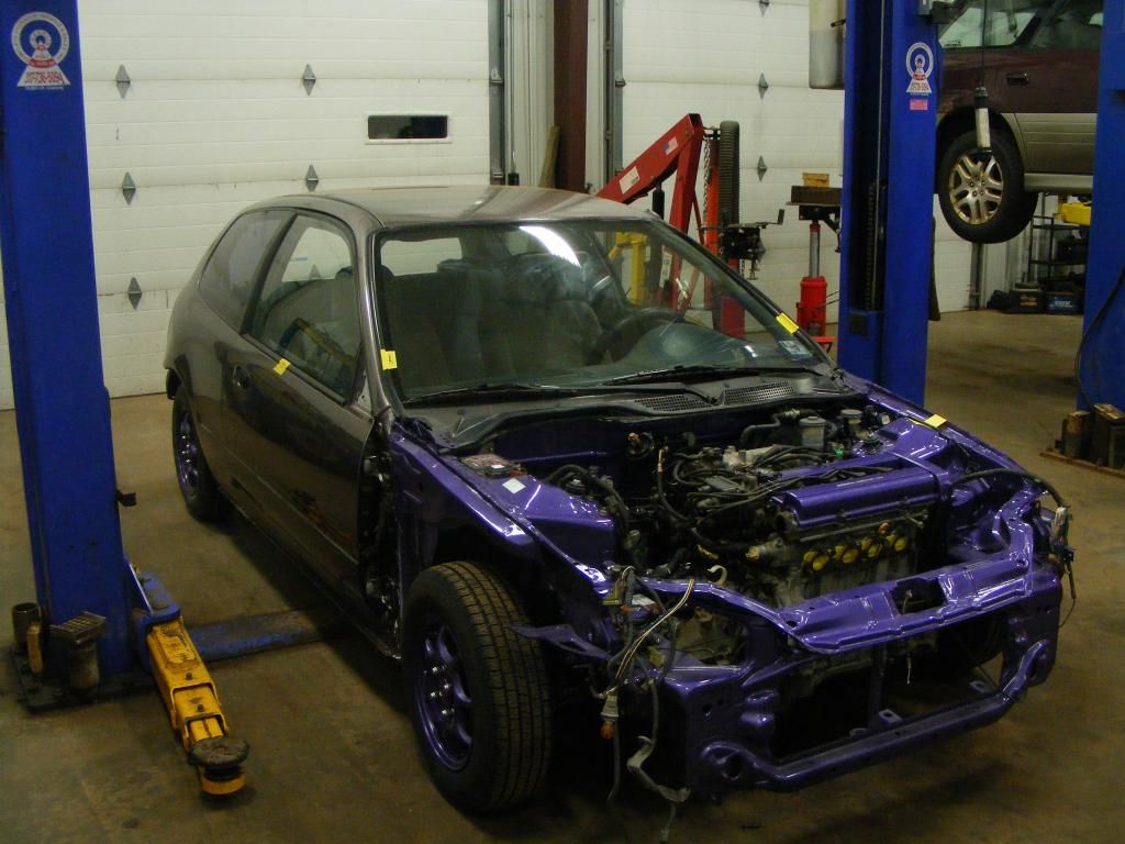

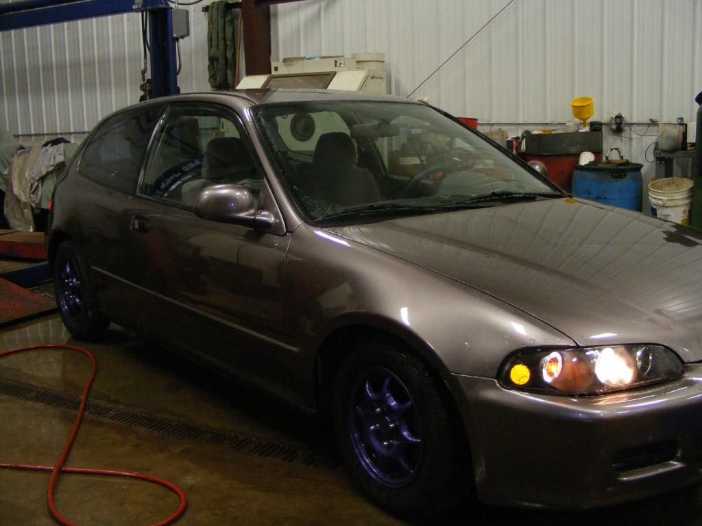

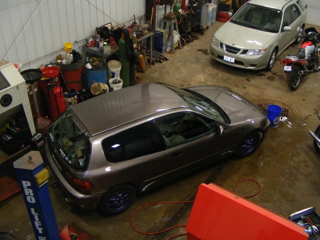

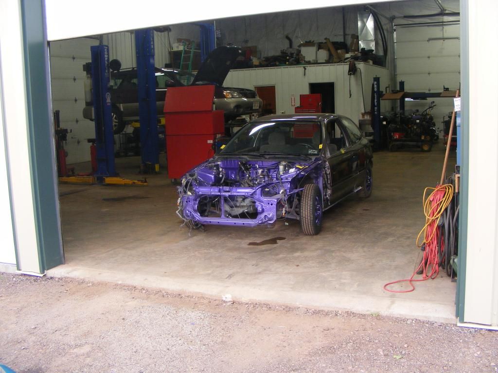

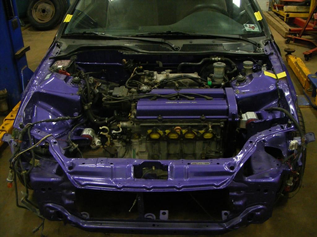

Went to California to visit family last week(the car scene is soooo much better than it is here) and just got back Saturday. Since then, it's been full speed ahead putting the car back together.
Some pictures of the progress. Hoping to have it ready to start this weekend(there shall be a video) and take a quick drive in it next week before I leave for school.

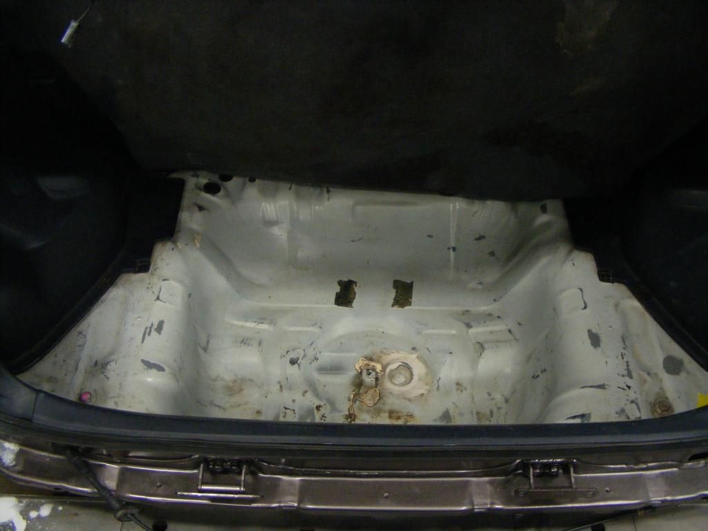

Cleaned and cleaned and cleaned some more

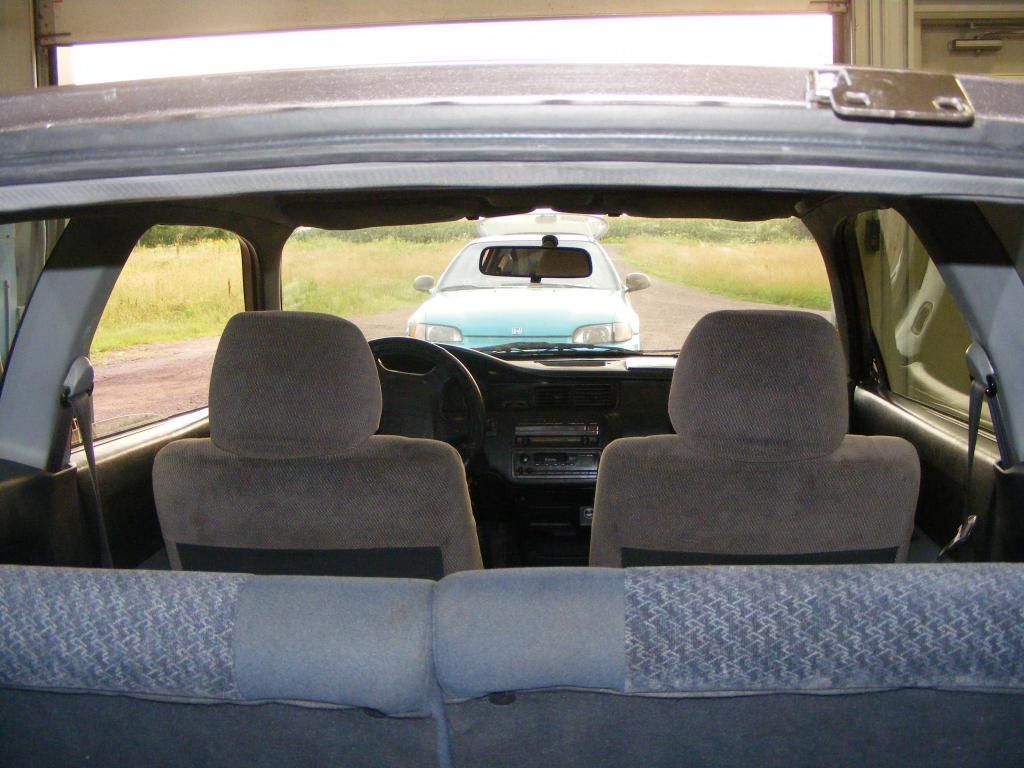

Put in some 6th generation civic seats
The only difference between eh and ek seats are the inside front mount on the rail, so I just made a spacer

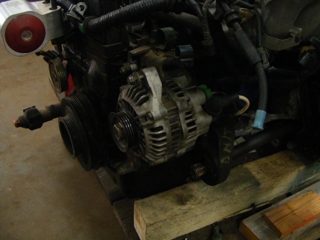

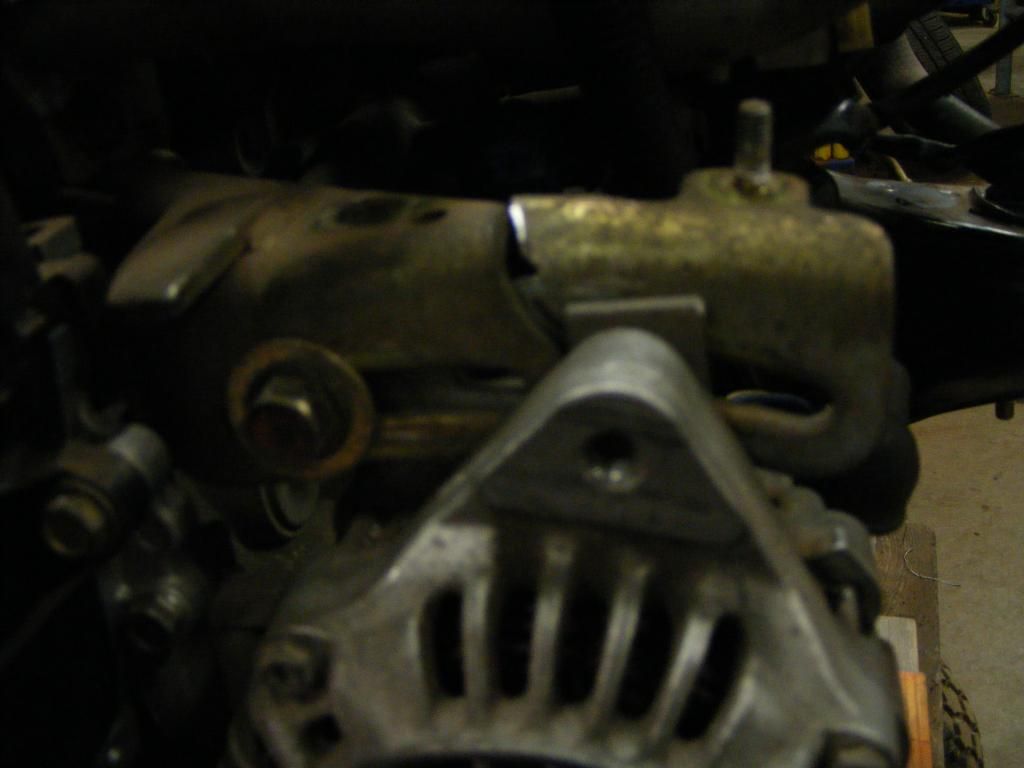

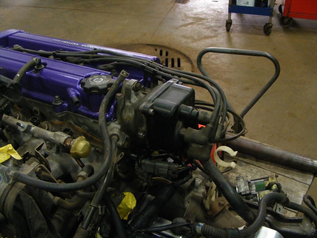

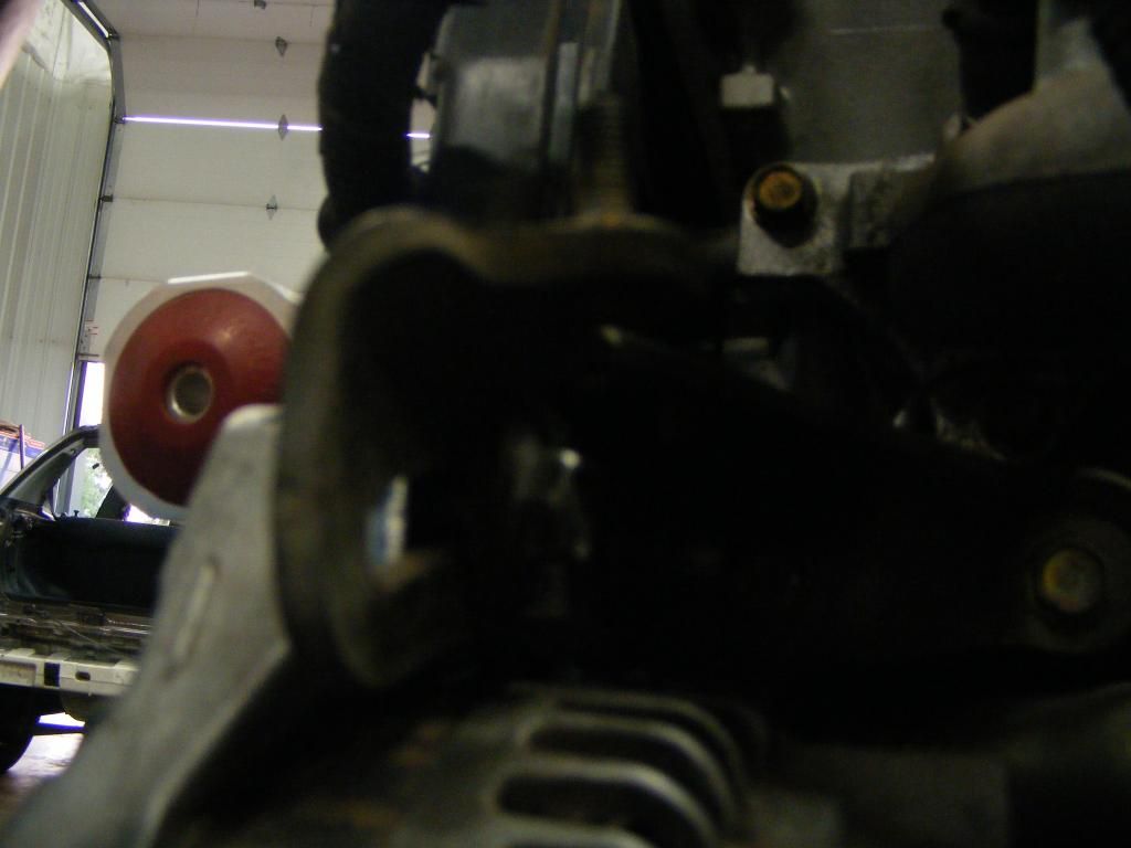

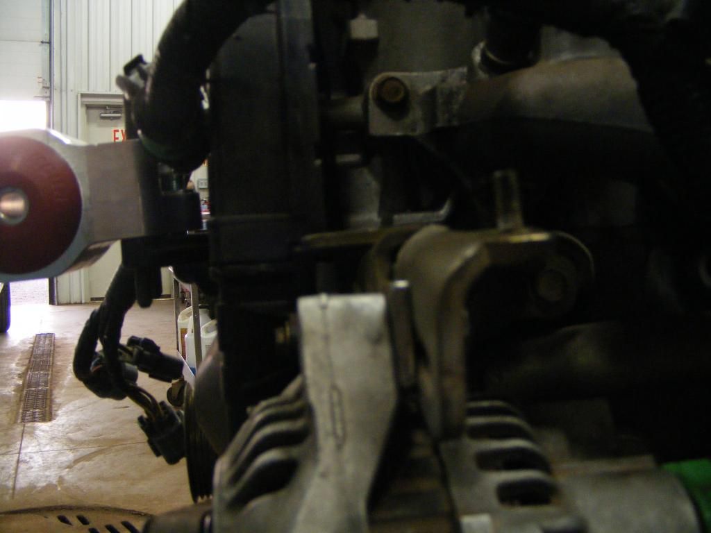

Prepped the B20B before dropping it in and found we could use the D15B alternator and dizzy internals to get around the OBD gap
Had to modify the alternator bracket so that the belt would work
And now for the fun (;

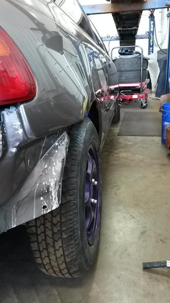

The spacers came today and I quick test fit them
Before
After
Going to have to drill out the back of the wheel a little or cut the studs, neither of which sound great to me but I do like the wider stance. I'll figure out ride height once I get the car running.

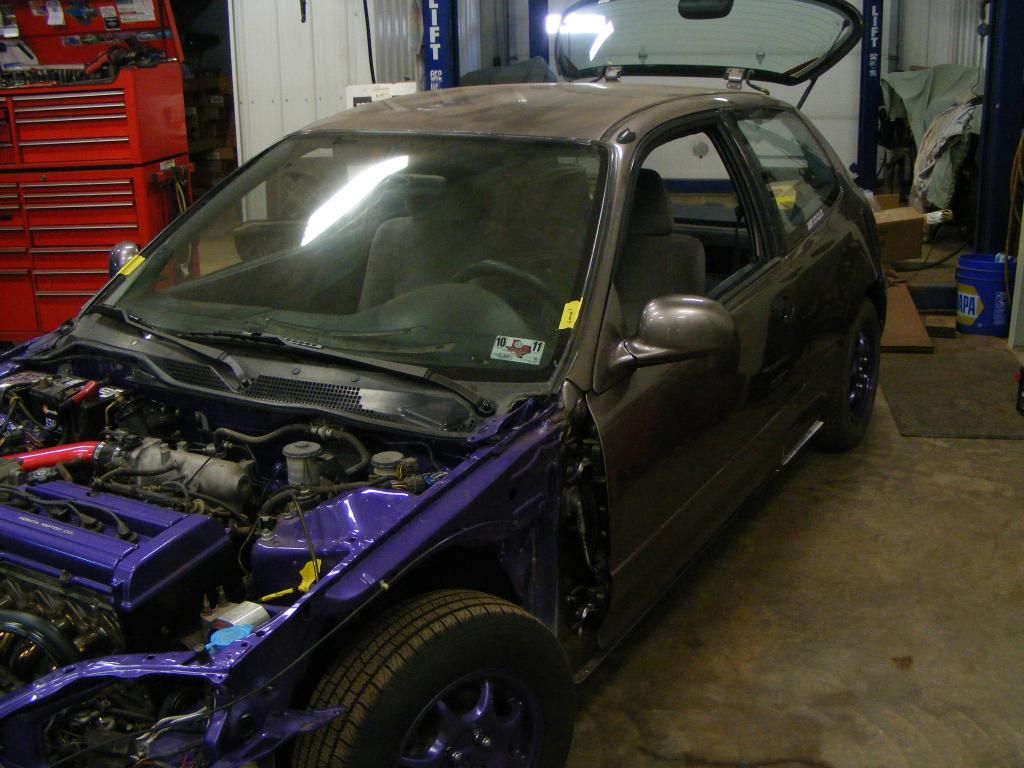

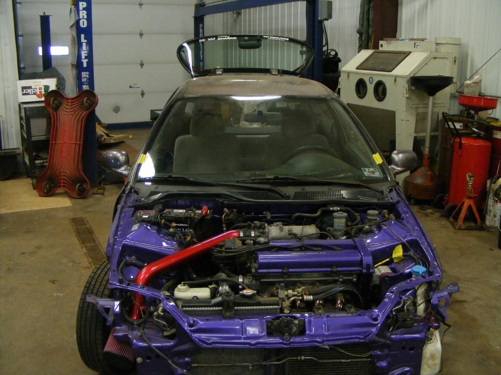

I'm home from college for break so i have been putting some time into my car, when i can.

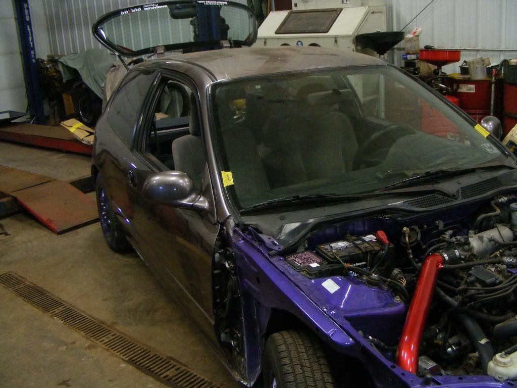

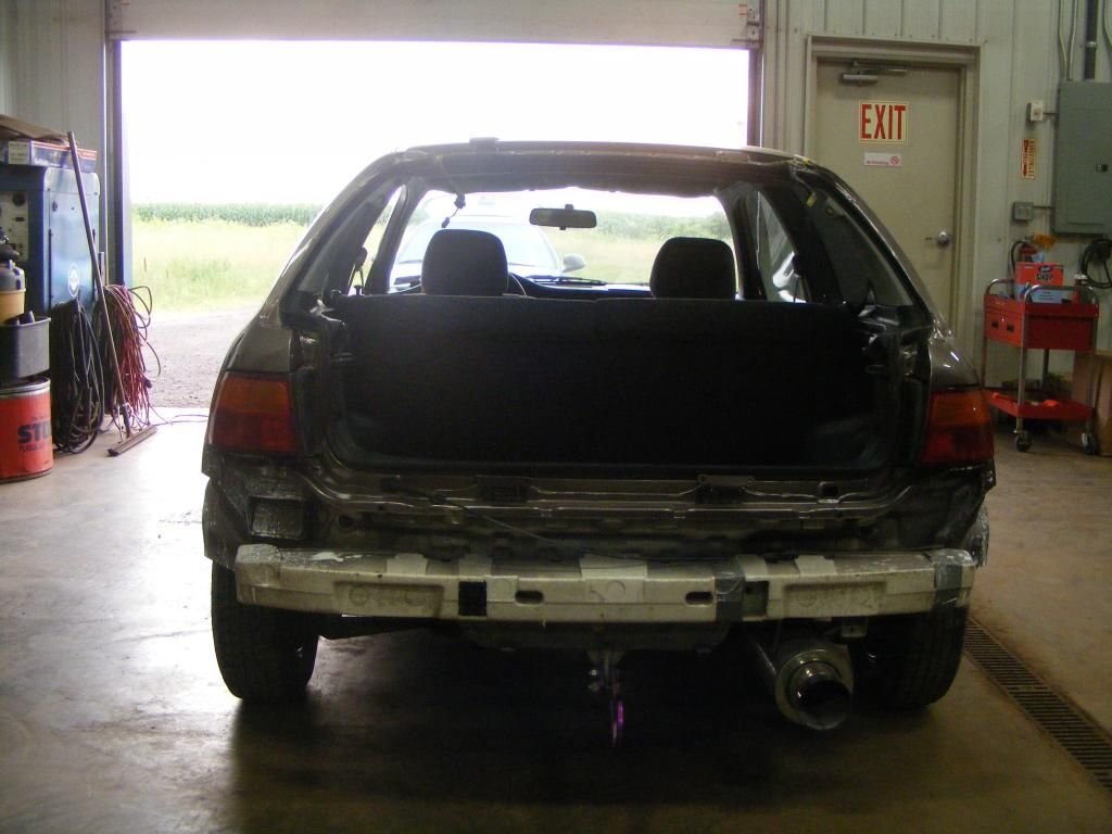

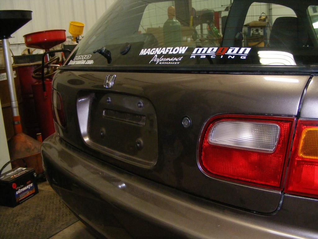

I put the rear together with the hatch, window and bumper cover. My rear window spoiler has a piece broken off the corner so i have yet to put that on but here are a few pictures.

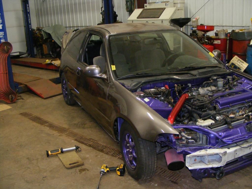

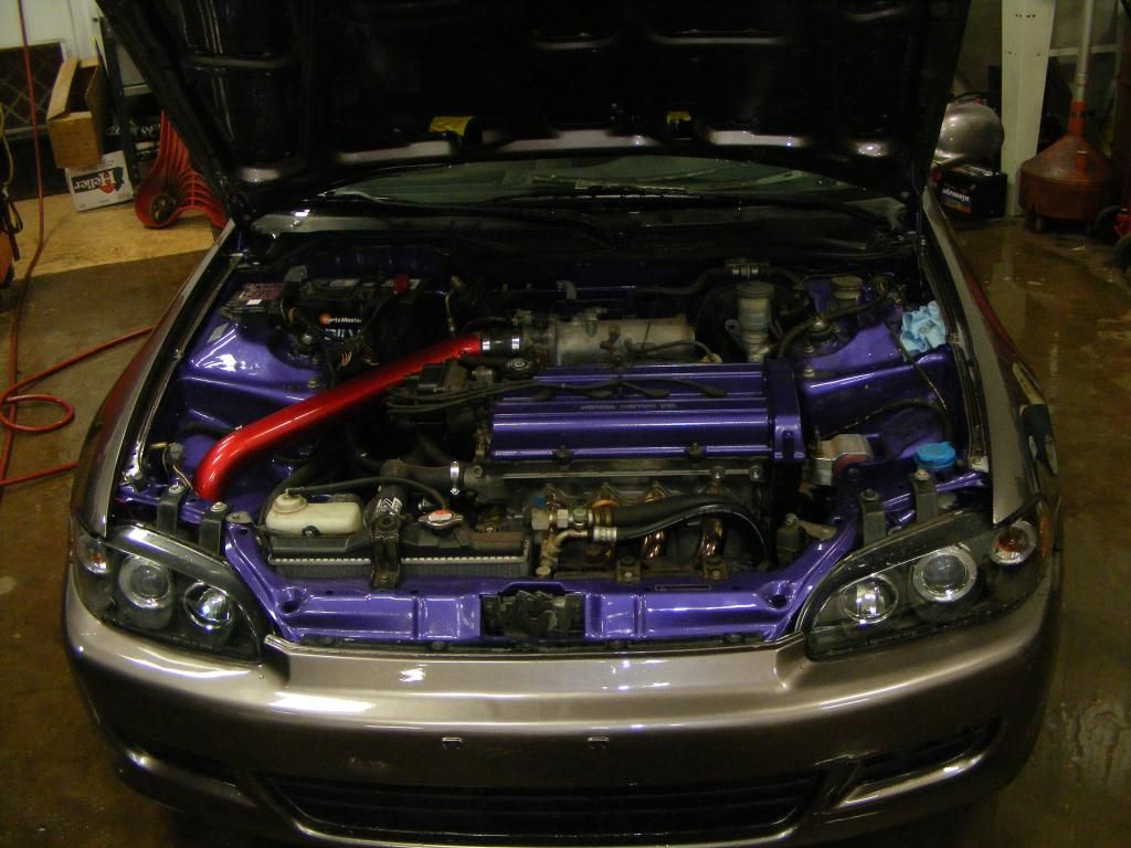

Put on my intake tube which will probably change color in the near future

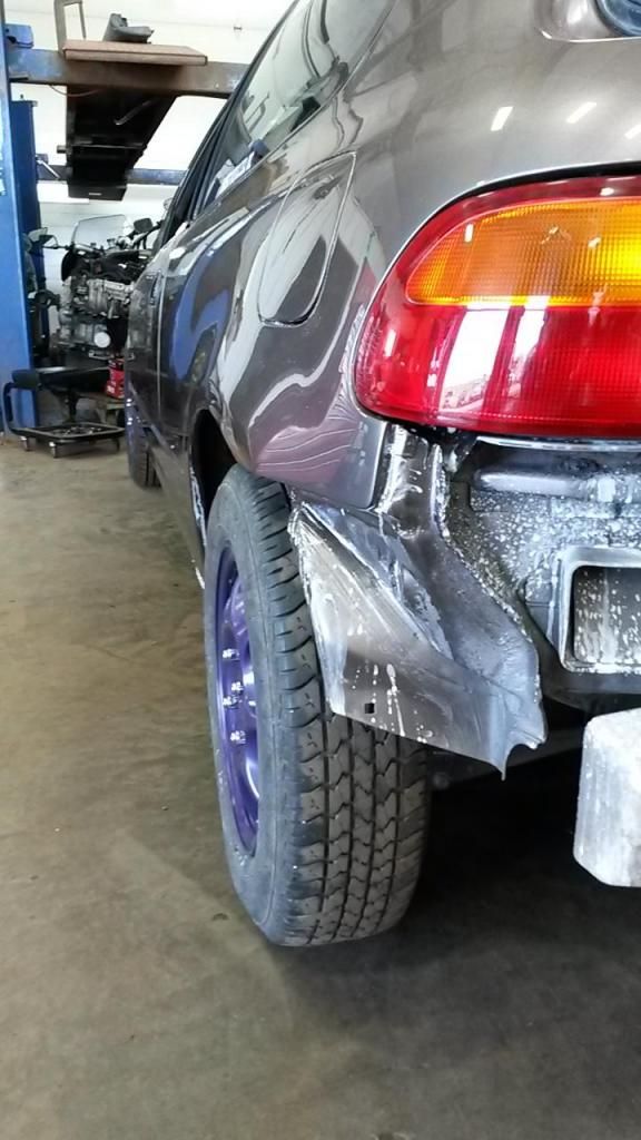

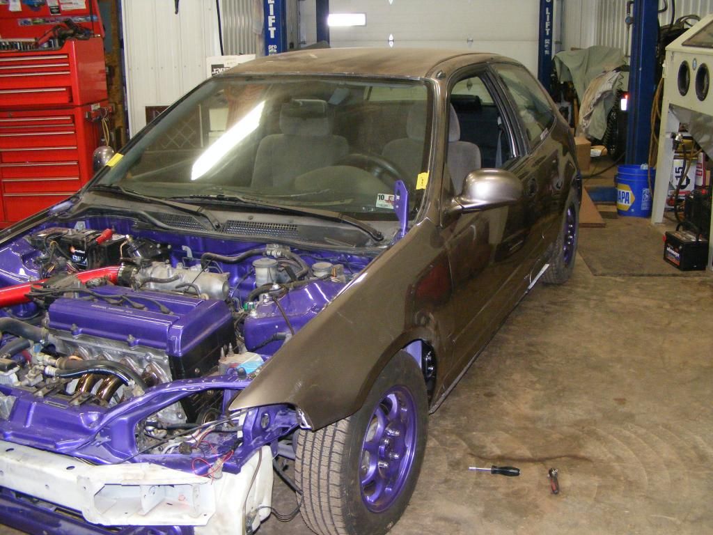

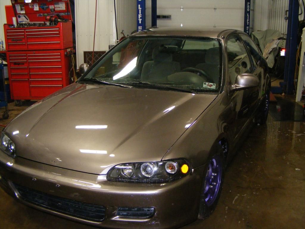

Next came the front fenders, which gave me some trouble because aftermarket fenders just dont match up like they should (and notice the color matched mirrors in the pictures!)
Hood

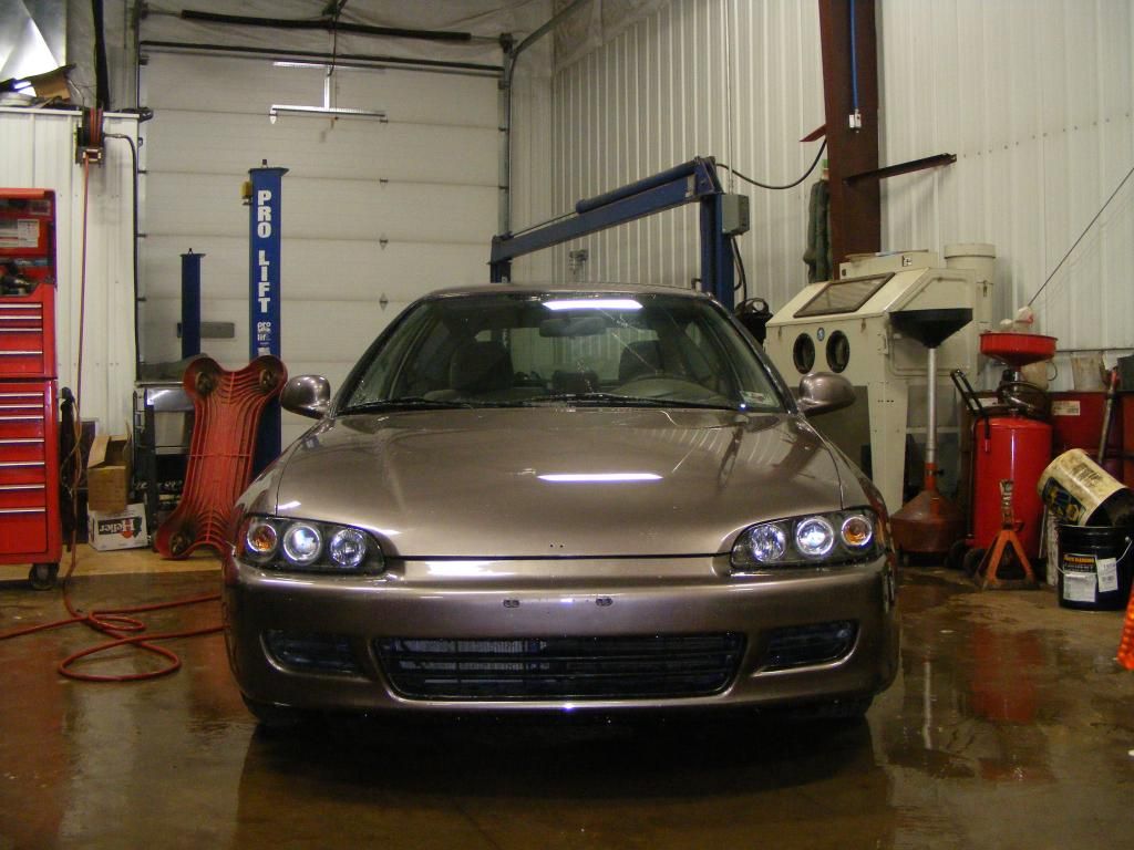

Lookin really good. Id probably paint that intake the body color. I think the headlights look just fine, but definitely needs some low. Keep up the good work.l ig:coltondk l youtube:coltondk I DD: Tundra I Projects:l 06 STI I 87 S10 l I 57 Chevy Belair I I 48' International KB-2 I 07R6r l

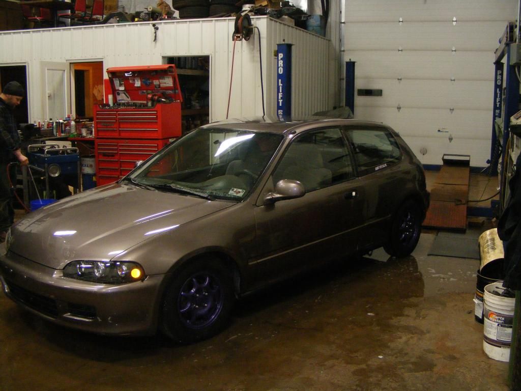

The intake tube was just a cheap ebay one, but the cone that came with it was garbage so i got an aem cone(saved some money there and I think it will work just fine). Yeah idk if body color or black for the intake yet but it wont stay red too long.Originally posted by SoLOwX3 View PostLooks like a aem. Looking good man. Looking forward to seeing it with more lows. What are your wheel plans incase I over looked that post.
As for wheels, I have the 13s and a set of 17 drag that i need to get rid of, The front fenders werent rolled or pulled before paint so i may roll with the 13s for a while simply to save the fenders(since they're new and freshly painted)
I would love to go with a deep offset 15 but I'm just going to drop it as is and see how it looks, I havent seen many slammed hatches on the 13s but I'm optimistic
