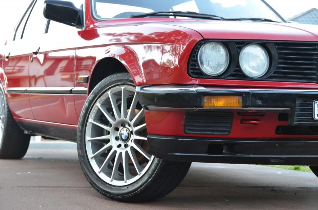

Here's my story.
In 2012 I bought this e30 for $2500; I was still in school, I had just got my license and it ran ok until I overheated it and the head cracked.
And so this year started, I recruited the guidance of an m10 guru to help build an m10 engine. Lucky for me, he was just about to part his race m10.
Spec...
2.2L crank
cosworth high-comp pistons
90.47mm bore
balanced rods
oversize stainless intake valves
port and polished head
flowed to 320?
dual dcoe 45 webers
I'll post heaps of photos from the beginning to now
