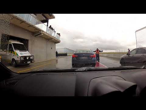

Which, in typical fashion, it was raining for. But it wasn't a full-on race day, more of a group lapping sessions, so really for the sake of taking it easy and getting to know the track it was not such a bad thing.
Survived three sessions even though the coolant was getting toastier with each one, hoping the suspect is just the rad cap letting too much into the overflow tank. For my first time on track with only a couple slides it could've gone a lot worse lol. Grabbed some footage of the last run too.
