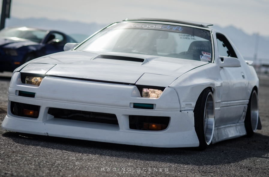

Shouts to Jay Lintao from LV Racing Scene for this photo:
