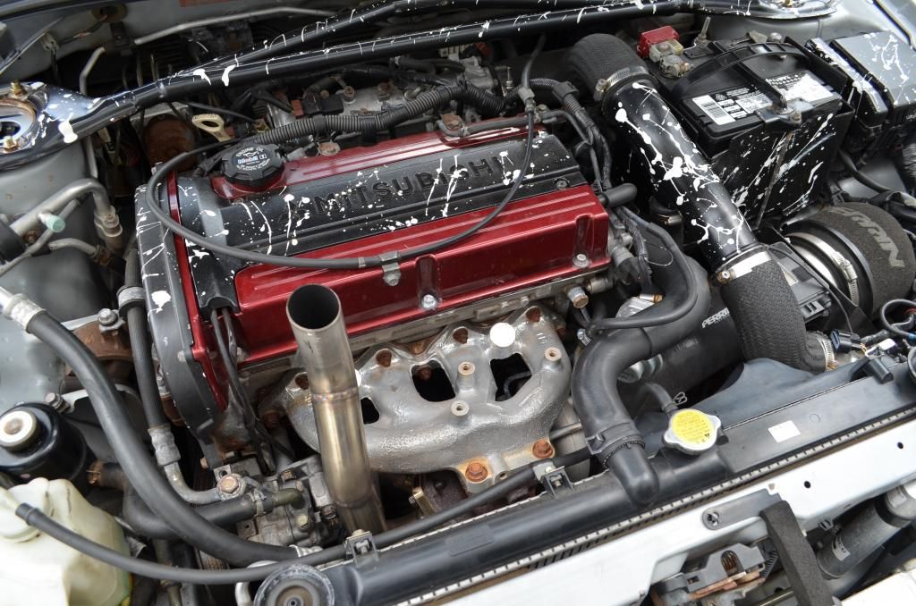

Newest addition to the evo is a JM Fab o2 dump out of the hood. I absolutely love this thing it's retardedly loud at full throttle and even shoots a flame every once in a while.
Easily one of my favorite things I've done to this car so far... Here's some pics of it installed:
